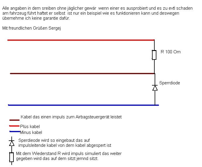

Friend I Cannot Assure That It Works, Is Necessary To Prove It And To Erase The Error With The Examiner, I Need That Commented The Post To See If Between All We Can Find The Solution

Of All Ways I Believe That We Are Turning Aside Ourselves Of The Subject, Which Is To Emulate The Sensor The Published Circuit

jhon please see page 18 of the first pdf file that is located above, (airbag system stilo.zip fiat), let me know your opinion, thanks
I did. That is not what is in the Stilo. The 100 ohm / 400 ohm switch describes a standard switch used by all european manufacturers. An occupant detector works in this way and so does the passangers airbag on/ off switch in the dash.

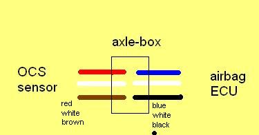

Thank you very much. But i have more two questions.
1. I'm very sorry but I didn't understand (1/2watt) do you mean 0.5watt OR 1or2watt.
2. There is a slight difference between the colors of wires in the sheme and these in my car.
Resistor wise just get a 1/2watt metal film 120ohm resistor, as for the diode try a 1N5349 or similar should do it.
Both available from maplins/RS/farnells. I have no idea if it works as I have working airbags.
