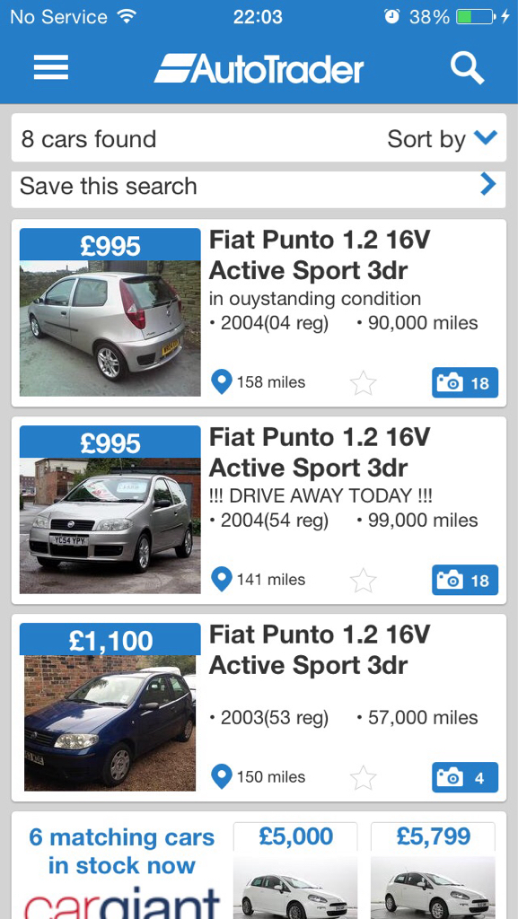

An active setup with the 16v engine? Thats odd as the actives are 8v iirc
You recall incorrectly there are plenty of 16v actives

it will not let me post any links but i have found other punto active, 1.2 16v's, also my insurance and the fiat dealer told me mine was an active 16v and not an active sport, the sports are usually 3 doors mine is 5.
I have also found a site with a list ill try and break up the link to see if it will post it, if you look in the active list (2nd lot down) you will see there is both an active 8V and 16V.
