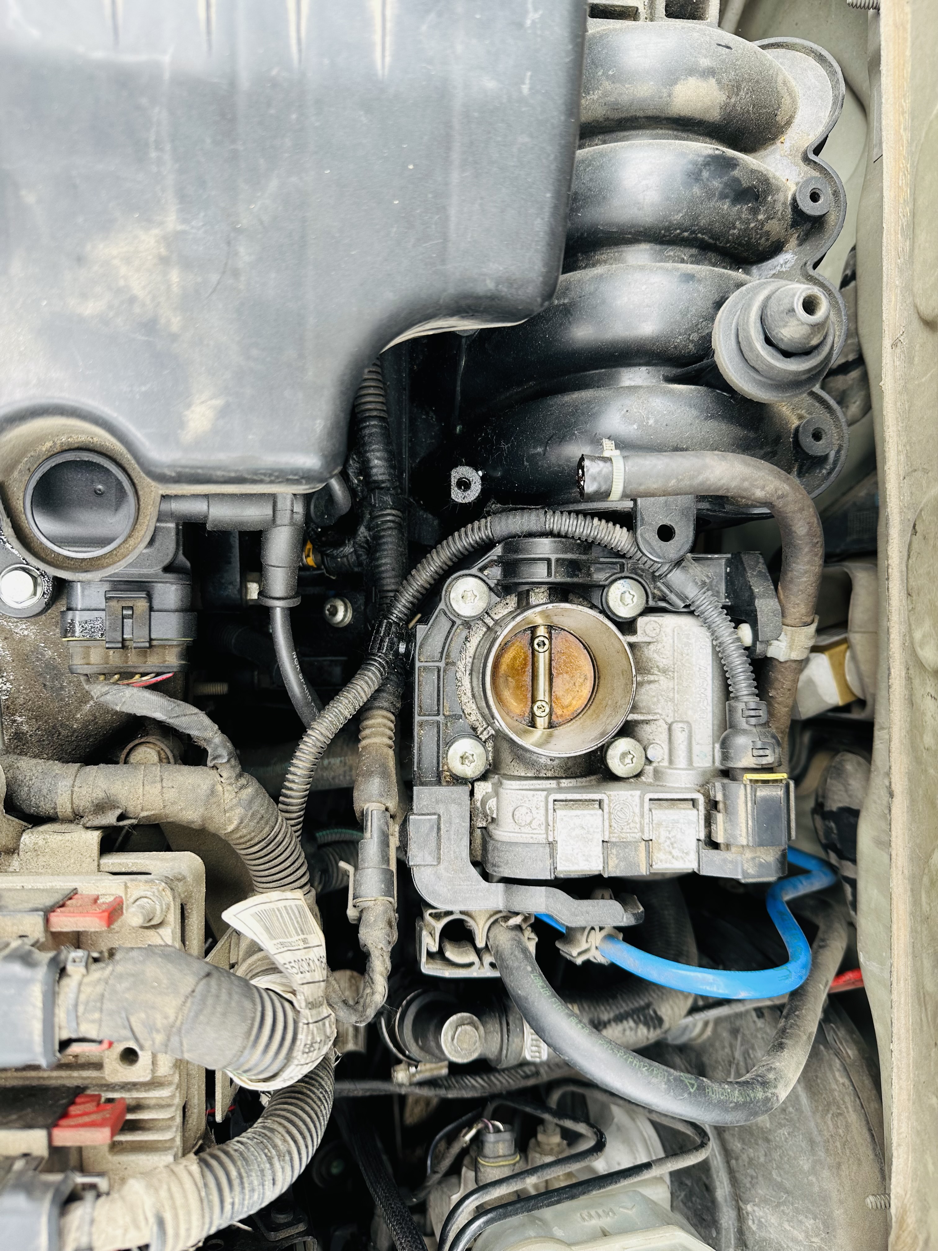

good morning partner! , the problem I have is that when I entered the diagnosis I did not see any error code. and the problem I have is basically in the rilenti. It doesn't rev but the engine makes small jumps as if it wanted to shut down and the exhaust blows intermittently. I hope your help, thank you very much!

If you take the air box off and look at the top of the throttle body is it covered in a creamy gunk

I can't distinguish a creamy dirt, but nevertheless I have suspicions about the fuel if maybe it has a clog in the fuel pump, I'm not sure

Great that looks fine
Pull each spark plug lead off one at at time and start the car for a few seconds
Make an note which cylinder make it idle worse or the same
