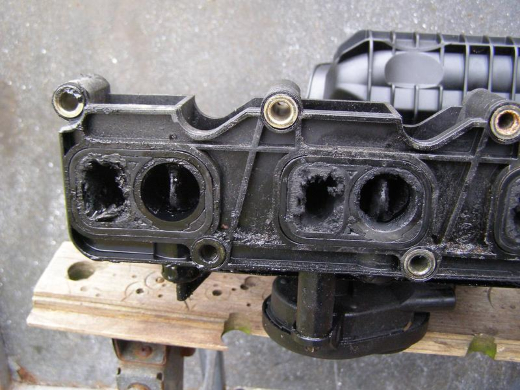

Looking at the post from Robert (G8RPI):
'You don't "have" to buy a new DPF, they are not a service item and do not need replacing if the car is used and serviced as intended.'
What does ‘used as intended’ mean? My brother runs a VW Golf diesel. His motoring is all short journeys. VW Service Manager tells him to go for a long hard blast every week, because otherwise the EGR will gum up and the DPF will block. His reply, ‘I drive my car responsibly. Why should I have to make extra journeys, using fuel, adding mileage, increasing wear, and polluting the planet, just to free up my EGR and clean out my DPF?’ Is that ‘used as intended’?
I also run a Mercedes diesel. At 123k miles the DPF had to be replaced due to blockage, and the EGR had to be stripped and cleaned out. That was an unnecessary bill of £1000 for a ‘non-service’ item. Since then I have deleted the EGR. The car now runs better than ever at 156k miles, and Mot tests show the exhaust is very clean.
'Mixing the (EGR) gases promotes even burning, letting the exhaust gas do it's job and improving engine efficency.'
Not true. The EGR system works against maximum efficiency. It reduces NOx by deliberately lowering the optimum combustion temperature. It introduces inert and dirty recycled exhaust products, which interfere with the normal compression-ignition process. The engine runs at reduced efficiency and produces more particulates as a result.
'The main cause of DPF failure is blocking by ash that comes from the engine oil, not the EGR.'
Also not true. Plenty of low ash oils about. Low SAPS oils are prefixed with a C, and when you use the manufacturer recommended oils that’s what you get.
Look at the photo here. It is of a Merc inlet manifold. That muck is caused by the EGR system - not ash from sump oil. On the Merc, BMW and other cars, swirl flaps are fitted to the inlet manifold. These jam because of EGR dirt, and the engine then runs rough. When they jam, the actuator motor seizes and burns out. This throws a limp fault, and if you’re far from home it means a breakdown service, another filthy and unnecessary strip down, clean-out job and new parts. More pointless expense. That’s why I said that the EGR system makes poor environmental sense. It’s crude and inefficient.
True, the EGR system reduces Nox, but in doing so the trade-off is a lot of extra grief, extra cost and more pollution elsewhere.
Both the motorist and the planet pay heavily for it.
Hi,
If it's not ash that blocked the DPF on your Merc, what was it? Don't say muck from the EGR because the exhaust gases go through the DPF with or without EGR. Yes they are supposed to use low ash oil, but note "low" ash, not no ash. Was your Merc serviced by a main dealer? Are you sure it was always filled and topped up with the correct oil? I've experienced at least 3 main dealers putting the wrong oil in my car, in one case with immediate effect on the car.
My comment on mixing the gases refers to the improved mixing promoted by the "restrictor" plate over the poor mixing without it. I've never suggested that EGR improves performance in any way,
You say "True, the EGR system reduces Nox, but in doing so the trade-off is a lot of extra grief, extra cost and more pollution elsewhere." Explain the "more poution elsewhere"? Apart from a slight increase in CO2 due to the small reduction in efficency, NOx is is worse at a local level than CO2. MOTs won't indicate that an exhaust is cleaner with regards to NOx, Diesels are only tested for smoke and petrol engines for CO and hydrocarbons.
Have you told your insurance company that you have deleted the EGR on your car?
Robert G8RPI.
