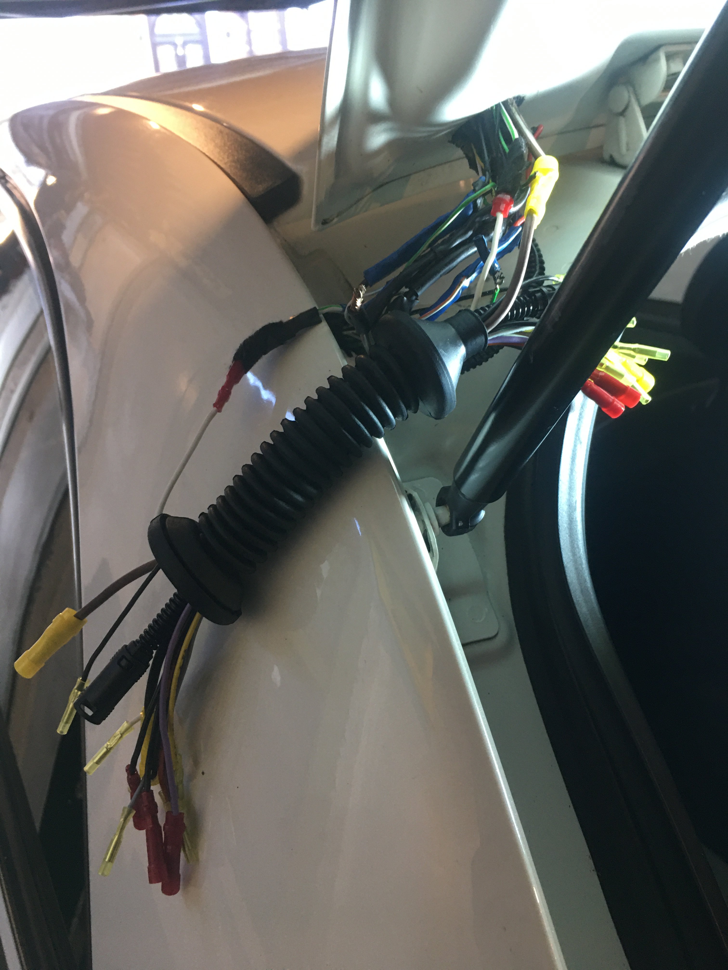

Thanks also I'll have another check of the loom - is there anything in particular I should be looking for - or just any damage at all?
You need to check if the repair has been done properly ie a new set of wires (more flexible) than the original or if the repair just consists of heat shrink you will know as the wires will still be quite short
If the replacement loom has been added the wires will be a bit longer and the rubber grommet will look newer .. pic below of my repair while I was doing it

AA checked the wiring loom in the rear hatch and found it has been replaced before but couldn't see any problems with it
Given their inability to spot what was happening with your earth cable, I wouldn't have any confidence in that statement.
I'd say there's every possibility that the rear hatch wiring repair has failed again. At the very least, I'd strip back whatever trim I needed to and inspect the whole repaired section very carefully.
