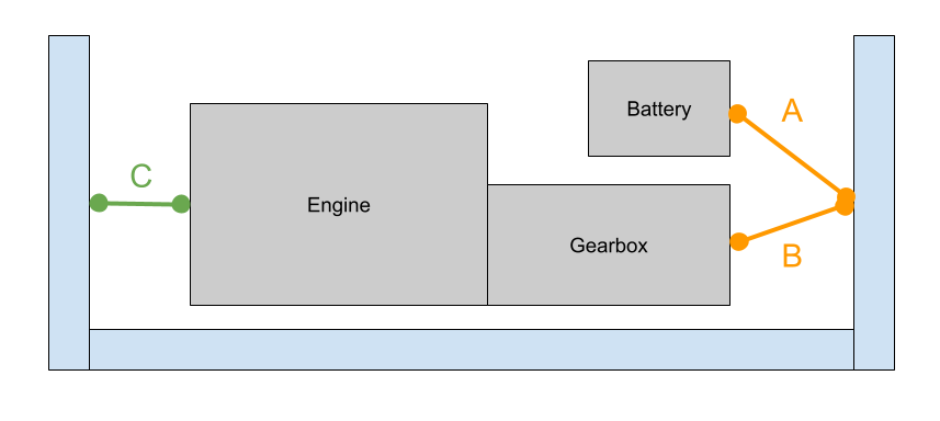

Thanks @GettinBetter different problem - same solution (y) I'm just confused how the earth from the gearbox wasn't transmitting to the engine. Strap A was checked, strap B replaced, but only when strap C was added, did it fix the issue :unsure:
I suppose if you take into account any gaskets, sealants, threadlock, and corrosion, it is quite possible to have the earth path impeded.
Thanks @John202020 All the terminals were cleaned when the original cable was replaced. It's almost as if the gearbox wasn't earthing to the engine.
Presumably build up or corrosion on the gearbox bots or mating surfaces
That or has been fitted with some sort of sealants between the engine and gearbox perhaps it's been removed at some point
Thanks @chris3234 I've had a mechanic take a look and he thinks the gearbox has been removed at some point.
Thankfully the secondary earth seems to be working for now.
I bet someone put gasket cement on the mating surfaces!
But the bolts should be a sufficient conductor?
Well yes but I have always thought Fiats earthing odd. Other cars earthed to body and engine earthing was secondary. Its certainly odd, but seems to be a common situation.
