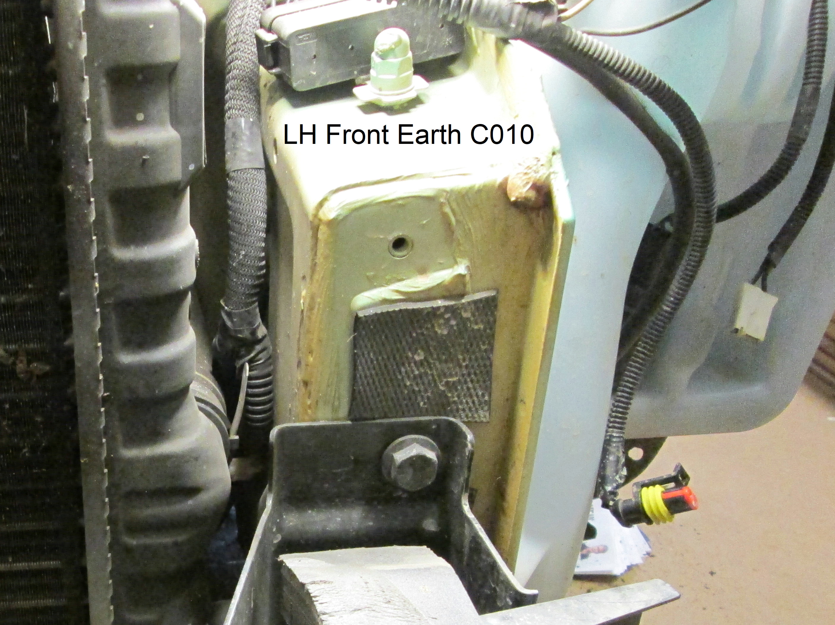

Just having a look at the attachment there, component code C010 is listed as left front earth. Could that possibly be grouped into the loom and be the issue?

Hi amcfad
As Communicator mentions, the only earth connection in the X250 setup is a thin Black/Violet wire on Pin 26 of Connector A which earths the coil of the Relay for the blower fan in the cab. This wire goes to the left front earth C010 , which is shared by nine other electrical components. Quite how and where these all join together onto the black wire to the earth is not clear, but there may be joints within the loom.
Not all earths are created equal. Some are just a wire or two bolted to the chassis or body, while others are multipole connectors with a the part having the male pins which are all commoned, perhaps made from a single piece of metal, and bolted to the chassis, while the removeable section holds separate female receptacles which are connected to the individual wires.
Below is a picture of C010 on my x244, unfortunately this does not show the complete connector, as the original photo was taken for a general view of the radiator connections.
