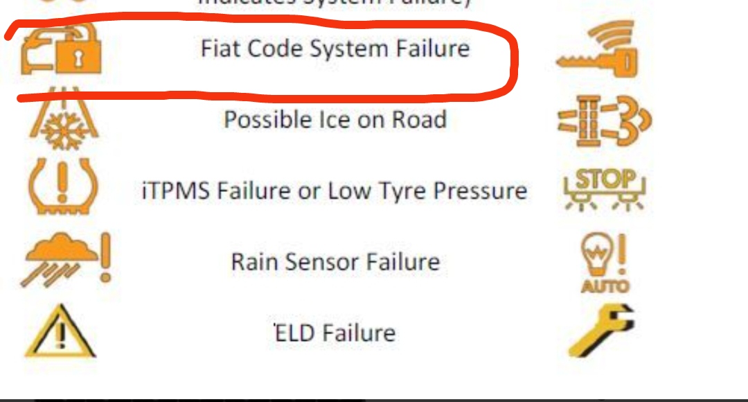

Hi. My fiat ducato 2014. Could not start after the warning lights of the car&keypad shown on the dashboard..i Google which mean fiat code system failures. I don't have spare key also the ignition switch is a bit loose and my key fob is not look healthy (broken). I turn on the switch i can hear it crank but won't start. Anyone hv similar problems please help.

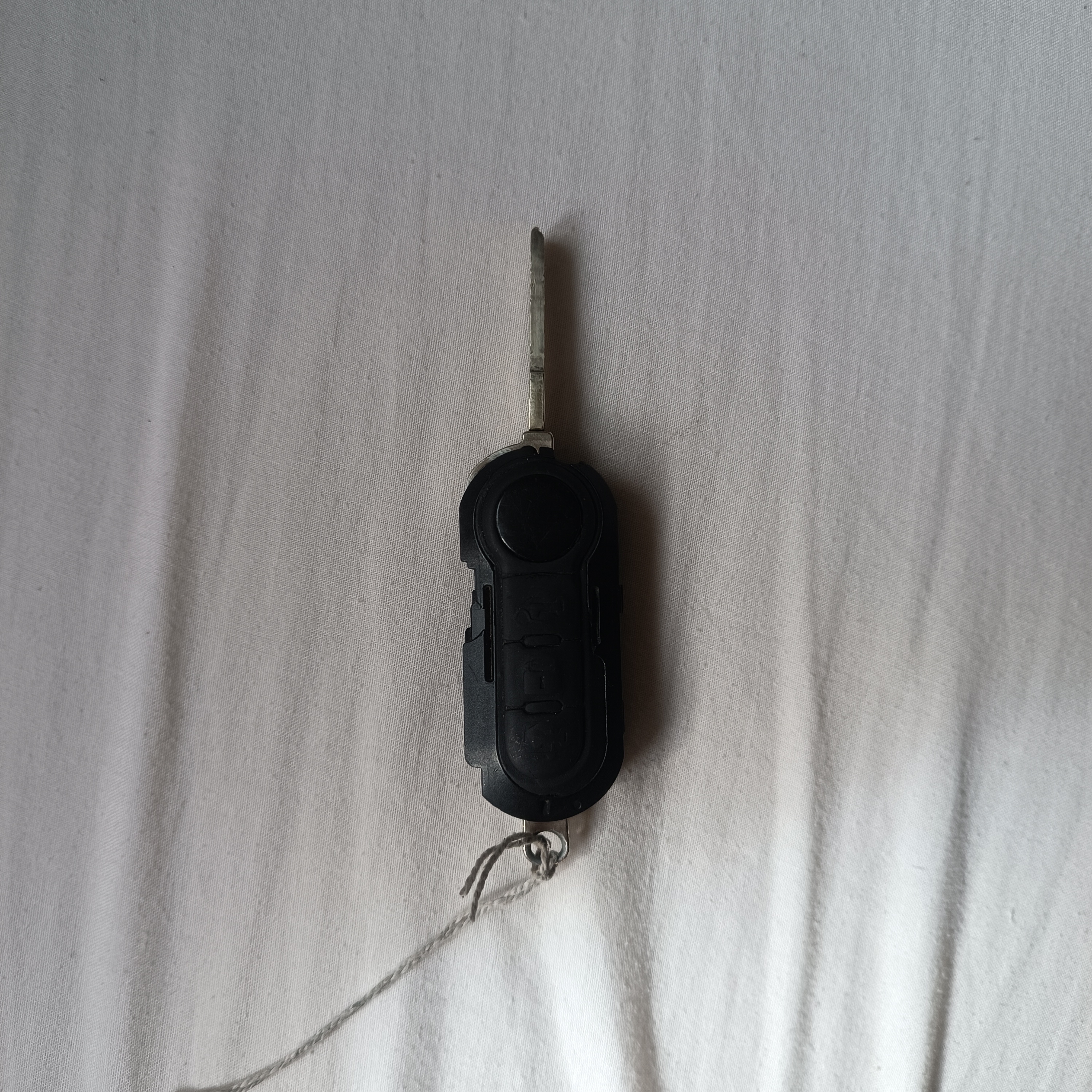

A photo of the key will help heaps ;)

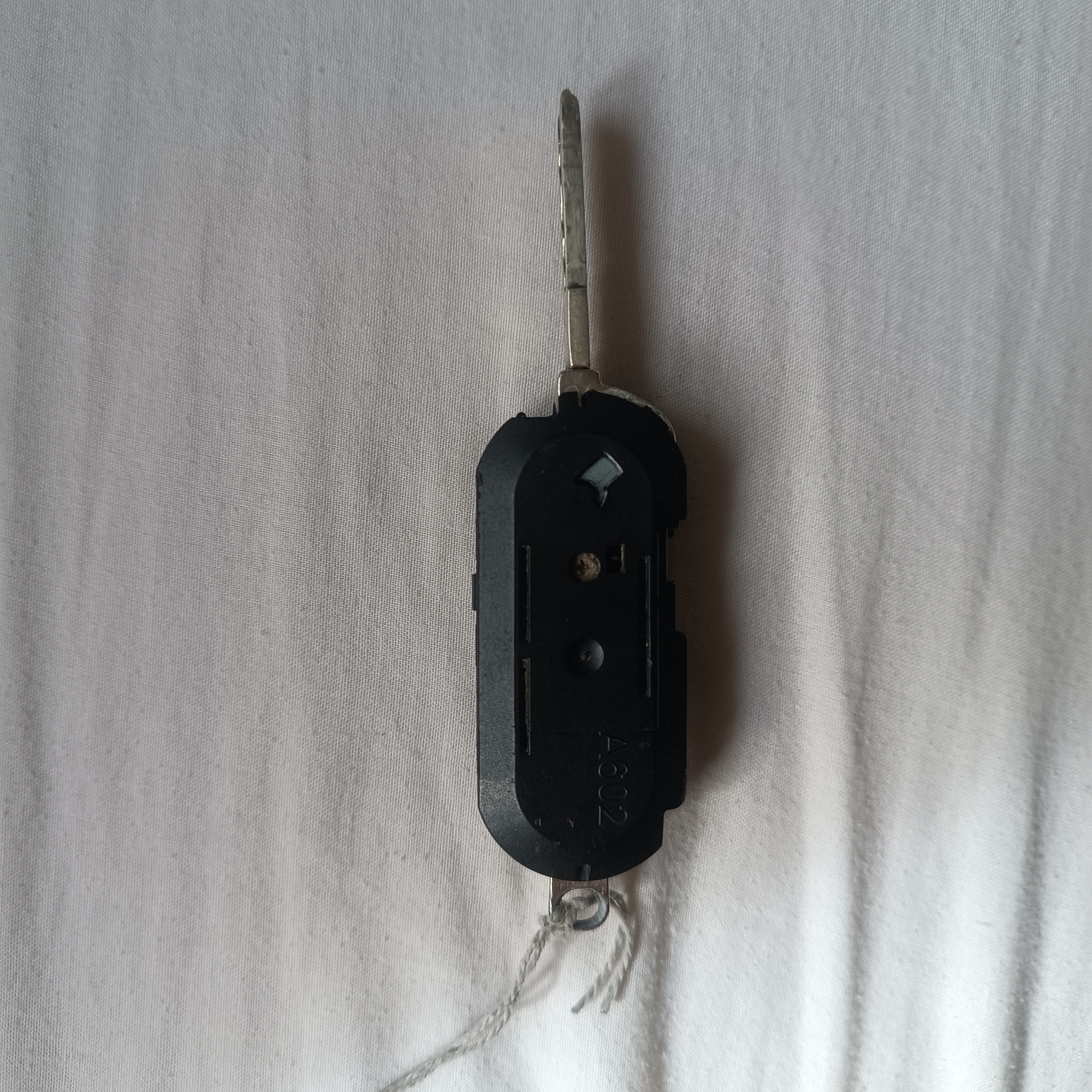

To smash the key case like that.. the internals may well be damaged

When code problems are encountered, a fix that is sometimes used is to remove the chip from the key, and glue it inside the steering column shroud, so as to be closer to the aeriel.
If this was the case and the chip has become unstuck, this would explain the problem. If my memory serves me correctly, @bugsymike had a story to tell about this practice.
As Communicator mentioned above, I have come across this issue in fleet vehicles where different drivers were frequently breaking the expensive keys the workshop managers would secure the chip which deactivates the immobiliser to the antenae ring permanently and move it to a "safe" place, then they could just have a cheap plain key cut.
In your case if you have been driving the vehicle with no problem up until now then I would assume the chip has only just become lost/dropped out. So I would do a very intense search for the chip which is a black and about only 10mm long roughly, if you can find it , that will save you a lot of time and money!!!
Apart from that remove the cowling around the ignition lock and confirm whether or not the antaenae ring is in it's correct position or has been moved, this will help in your attempt to locate the chip.
If you are lucky enough to find the chip, go to a locksmith and get two good quality keys made with chips so both will start the vehicle and put one in a safe place.

Assuming locksmith was testing the immobiliser frequency (not just the door unlock signal;)) then it may be worth checking in another direction, possible low battery voltage/wiring/earthing points etc. as I see on your original post your code read showed multiple errors, rather than just the immobiliser warning.
