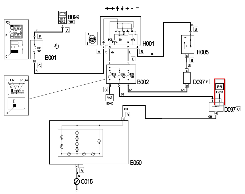

I am a little bit in doubt now, because it could have also been fuse F37 that I replaced.
Because if you follow F37 from pin 8 through D097 there is some kind of split in H005 with 1 side going to the side lights, see attached city lights figure. In this picture there is also a picture that could indicate the dashboard light of the side lights marking B.
Could that be it?

In Elearn explanation regarding the side lights it states that this line is protected by fuse F24, see attached.
Same as in my booklet, F24 is for the licenceplate lighting(I did not check that) and parkinglight indication light(same as side lights)
Hm, so if I would have read the service manual that was in my car already, I would not have it trouble shoot this much...oh well, atleast I now know how I can utilize the 2 spare switch on the H090, the frontfog lights and ASR, both I do not have, bu they are just connecting the earthing to certain pins. But that will be a different topic
Could that be it?
Max,
I think that you may be confused here. On drawing E2010 Side, tail, & number plate lights, H005 is the column switch. Unfortunately no position marking, but as shown OFF, rotate clockwise = Side etc, rotate further = Headlamps with sidelamps still lit. The picure/sketch at top RHS shows which is connector "B". Incidentally on a marked up print, I have shown an additional connection pin 7 on D097B, but I have not marked where to?
eLearn has many errors. An example is at top LHS of E2010. Fuse rating is given as 10A. Impossible as it is a maxi fuse. Other digrams show 30A.
