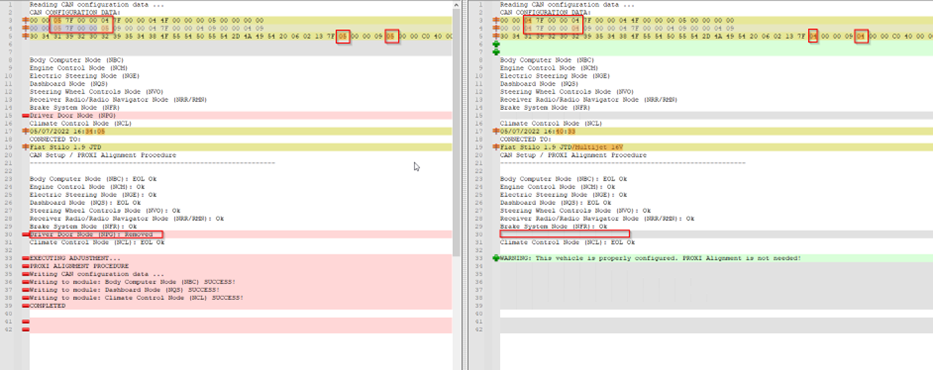

I had the brilliant idea of buying a wireless Carly connector to unburden myself from the task of carrying my laptop every time I wanted to check some data out of the ECU. Surprisingly ( or not ) something went wrong the first time I connected it and got the typical flushing mileage. So I carried out a PROXY alignment and everything went ok, except the Driver Door Node (NPG) disappeared from the CAN info and now, the button that unlocks the door is not working, as well as my remote control key.
I thought I had the original custom file in my computer, but to my dismay, I didn’ t. I’ve dived into my MES log folder and I believe I have retrieved the original byte disposition, which in my stilo is 55 bytes just before the proxy alignment was done.
So I post the image with the comparison before alignment (left) and after alignment (right).
There are only two different bytes that changes from 04 to 05 in both positions 27 and 31.
The point is, if replace my custom proxy file which is
30 34 31 39 32 30 32 39 35 34 38 4F 55 54 50 55 54 2D 4A 49 54 20 06 02 13 7F 04 00 00 09 04 00 00 C0 40 00 00 00 85 16 00 00 02 44 06 00 1E 00 28 00 00 00 11 50 50
With
30 34 31 39 32 30 32 39 35 34 38 4F 55 54 50 55 54 2D 4A 49 54 20 06 02 13 7F 05 00 00 09 05 00 00 C0 40 00 00 00 85 16 00 00 02 44 06 00 1E 00 28 00 00 00 11 50 50
Will it work properly again??
And there is another question which is that what is exactly these two lines in bold
00 00 05 7F 00 00 04 7F 00 00 04 4F 00 00 00 05 00 00 00 00
00 00 05 7F 00 00 05 09 00 00 04 7F 00 00 04 09 00 00 04 09
Could it be the list of configured control units and List of active control units or I am totally wrong??
