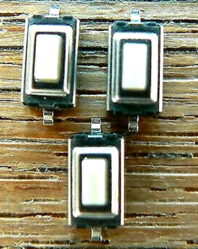

Just for clarity
We are talking about one of these
Physical button not membranes
It's not the ECU or body computer or anything in the car in my opinion
The button are replaceable
They are surface mount, but they aren't that difficult to change with the correct equipment and skill, they are quite big pads by mobile phone standards
If you are near me (Crewe) and If needed, if you supply the buttons around a fiver for three, I will change them free of charge

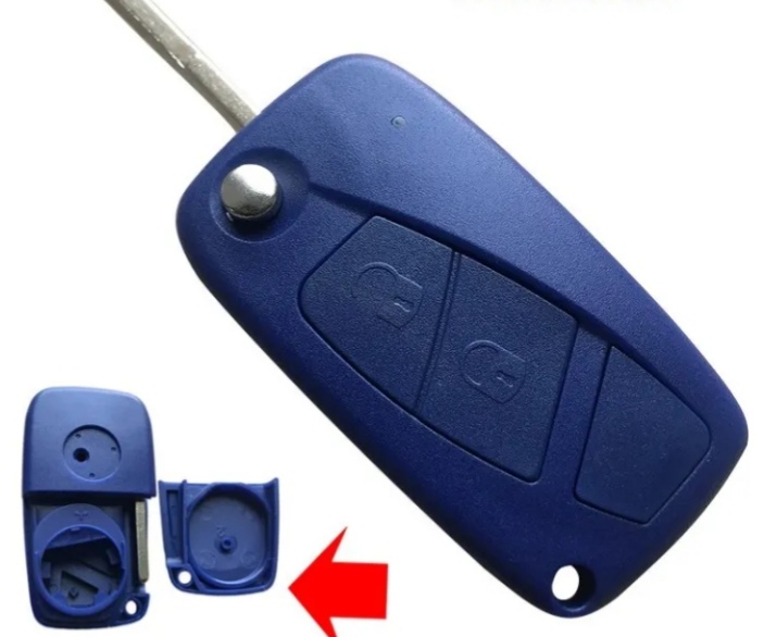

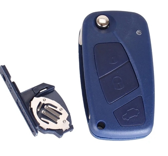

It's quite easy to change the shell, just make sure you order the correct one
The inside from one type will not fit the other
Odds are it's the second
Be careful taking the PCB out, it's easy to damage the component on the thin strip, top right on the picture of the PCB
