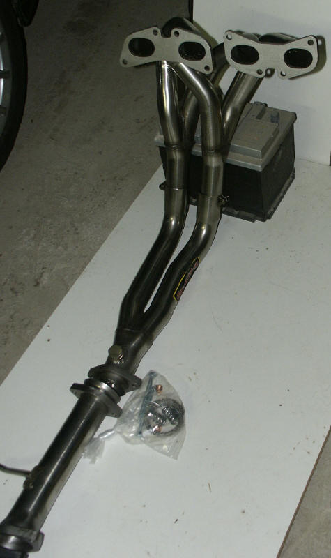

Some good news is my stainless sports supersprint manifold has just turned up so now its time to order the gaskets from Fiat. Idont think I will get a chance to fit it before I go waywith work again at the weekend :cry:

Question for you, the supersprint manifold, where and how much for it, as i also want to purchase one.
Hi KC m8 (y)
I was lucky and picked up my SS 814501 manifold new/not used secondhand off eBay for £270 total.
I have looked around and have found you can get the manifold from the link below for £334 + £10 delivery Link
The quality of the manifold is great so real happy with it. (y)
Hope this helps KC.
