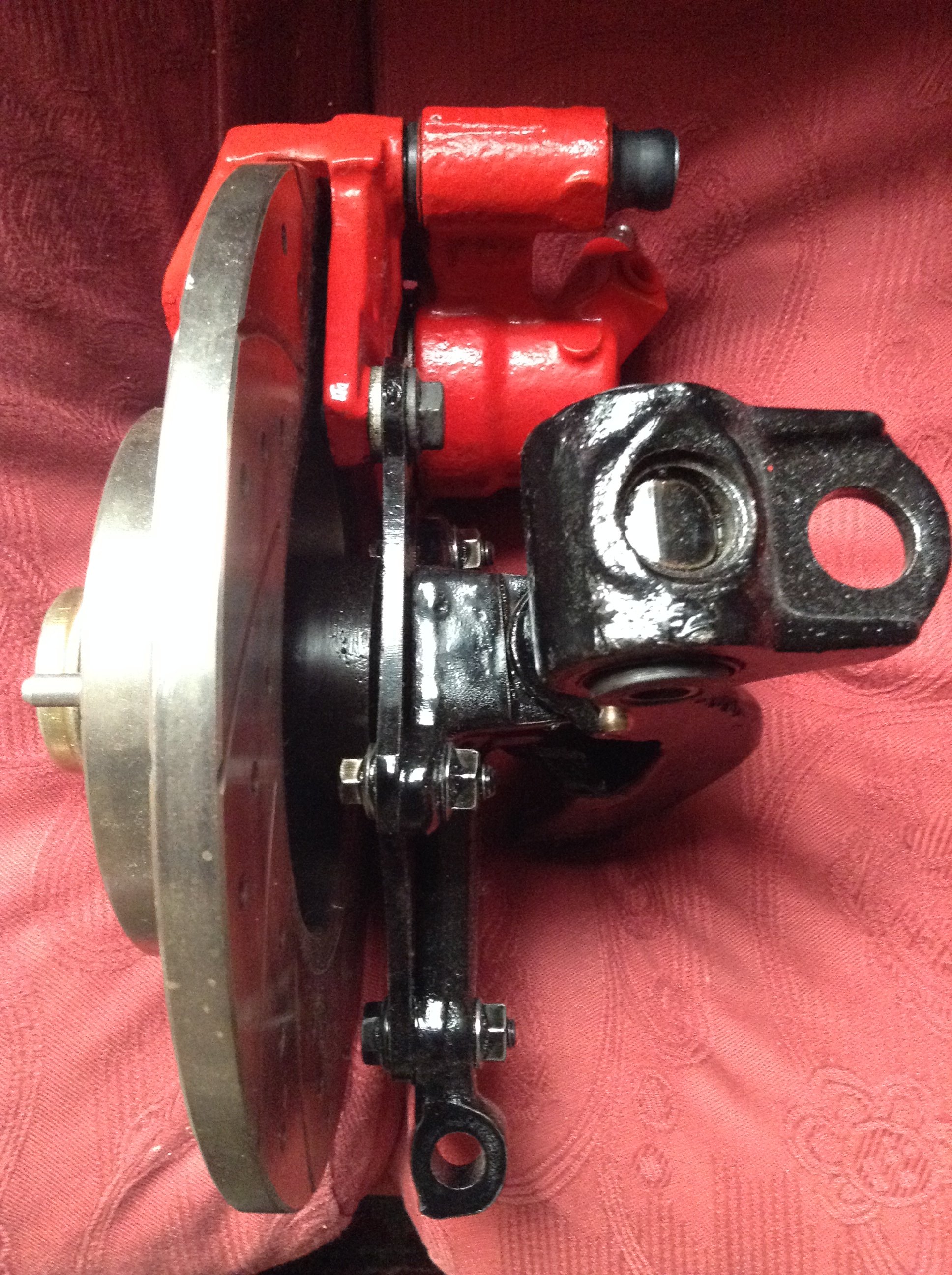

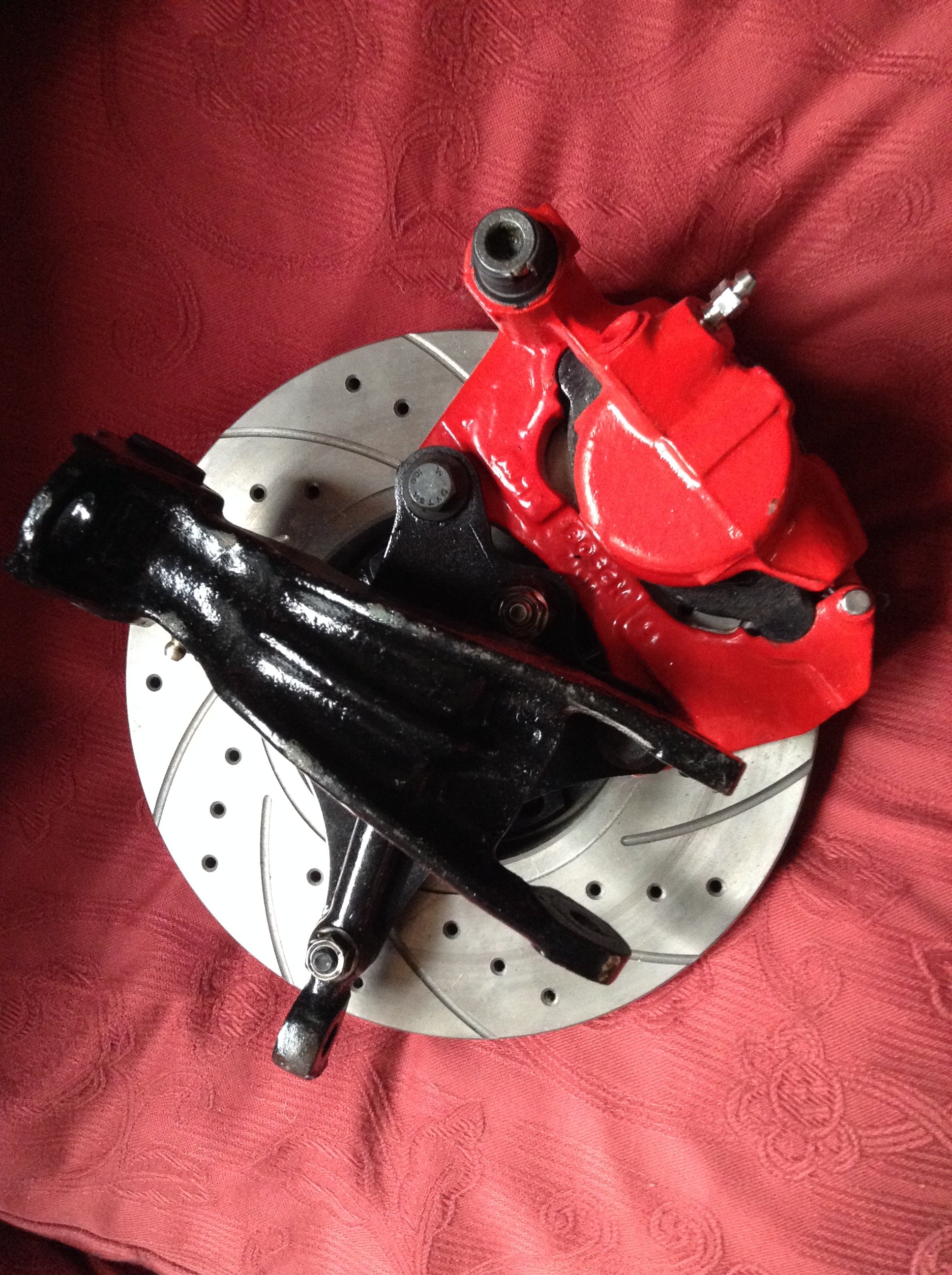

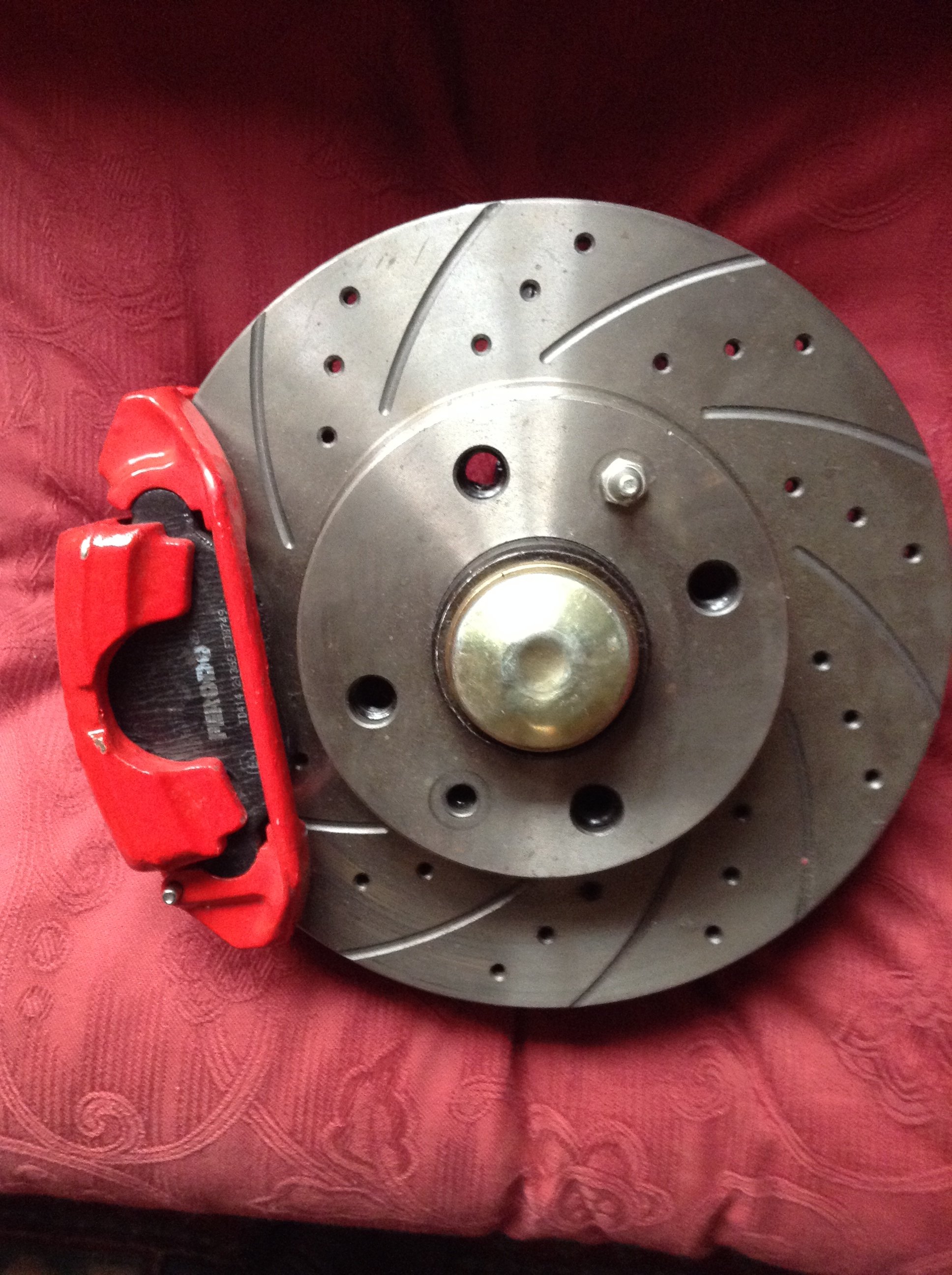

When I bought my last 500L it came with an MOT along with the longest list of advisories I have ever seen which included king pins, wheel bearings and I found the brakes to be poor. I bought the Ricambio set as it solved all the front end problems in one go. They performed very well and on a couple of occasions I was pleased to have them when forced to do emergency stops. They are pretty much maintenance free under the light load of a 500 although I did strip them down for investigation and I found the kit consists mainly of refurbished and modified standard Fiat parts where the discs, pads and calliper carriers were modified. If I were looking to buy a set now I would opt for one of the purpose built conversions that use new parts but do not include stub axles like the one sold by Auto Bella.
I ran my car with the original master cylinder, no problems. For the disc brake callipers to function the pistons pretty much just rock in the rubber seal and there is very little movement and minimal fluid displacement (explained to me by a lecturer in motor vehicle technology)
