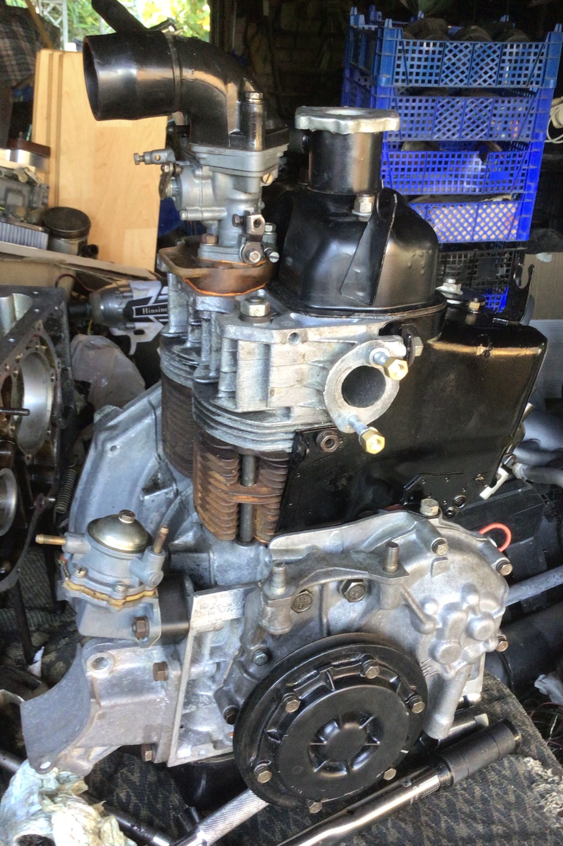

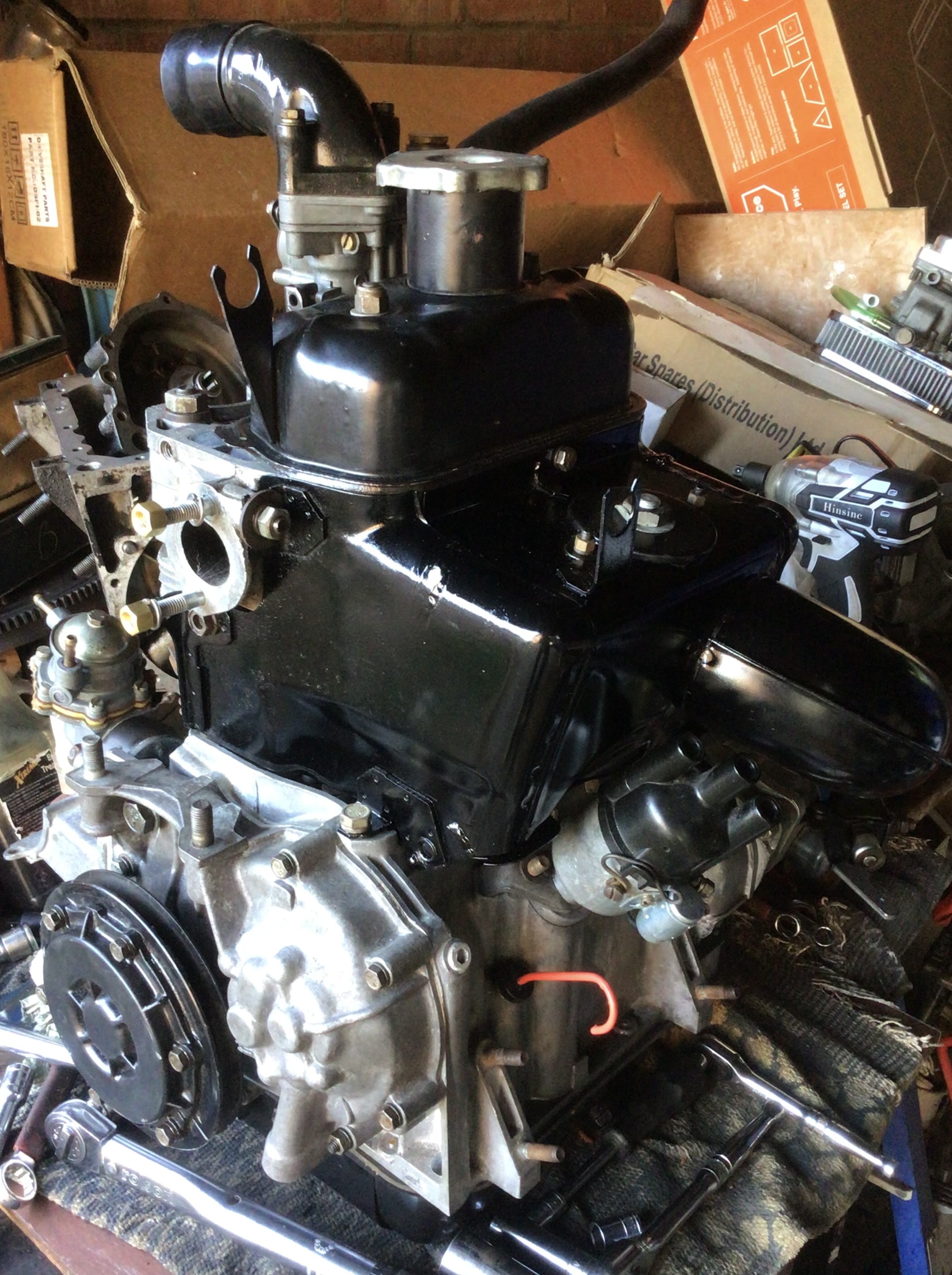

As for engine upgrades for a 499cc Fiat 500 as some of you who know me will know that I have built many engines for our cars, standard and tuned, from 499cc up to 795cc. Engines have been either for my own use and pleasure or made for colleagues on request. Last year I realised that I had accumulated enough parts to build a “new” standard 650cc engine so I started a total build from a suitable bare crankcase. I almost finished the project before the weather meant it was too cold for me in the garage. So I stopped for the winter. Other projects diverted me but have been getting back to the engine lately. If anyone is interested in a totally rebuilt standard 650cc engine do feel free to contact me for details as the price will be extremely competitive. I also photographic evidence of the build.
The pictures show the current stage of the engine.
