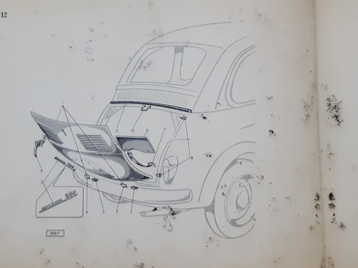

Is the air intake grill across the back the original one?
I am sure the full roof version is different to the short roof...
Next the Sunroof rolls up and held closed with a leather strap...
this strap locates round a couple of fixings one located inside the car of the parcel shelf and the other on the alloy strip across the back...
these mountings may nee to be drilled, so before paint would be better...
Hard to explain here... but will try to repost a couple of your pics or give me a ring and I will explain...
Doubt it would be shown in D parts books but would be in N ones

The alloy strip... People simply weld up the middle hole and drill two more for the bracket as a new strip is stupid money....
I noticed those two holes in the rear... without taking a the grill off my cars I am not sure if there are captive nuts or such... I am sure that using some bolts that match the self tappers would be better as the bracket could pull out the screws over time driving with the hood rolled up and strapped down..
The bracket is under the alloy strip on my car..
so effectively the bracket is held down by the whole length of the strip....
does the repro bracket have any holes or would the screws go right through?
since as you say there are two 6mm holes which must either mean the bracket is attached to the alloy strip and those hoes are just for clearance or to have something behind to allow more substantial fastening (but then why have holes?)
There seems to be a mix of on top or underneath, the alloy strip, but I cannot see being on top as being right as it looks like n after thought..
What was there on Andy's car?
It may be the difference between early grills and later ones I was thinking about.....

Yes my rear light holes are correct. The D's (late N's) had the inferior rear lamps fitted:eek:
