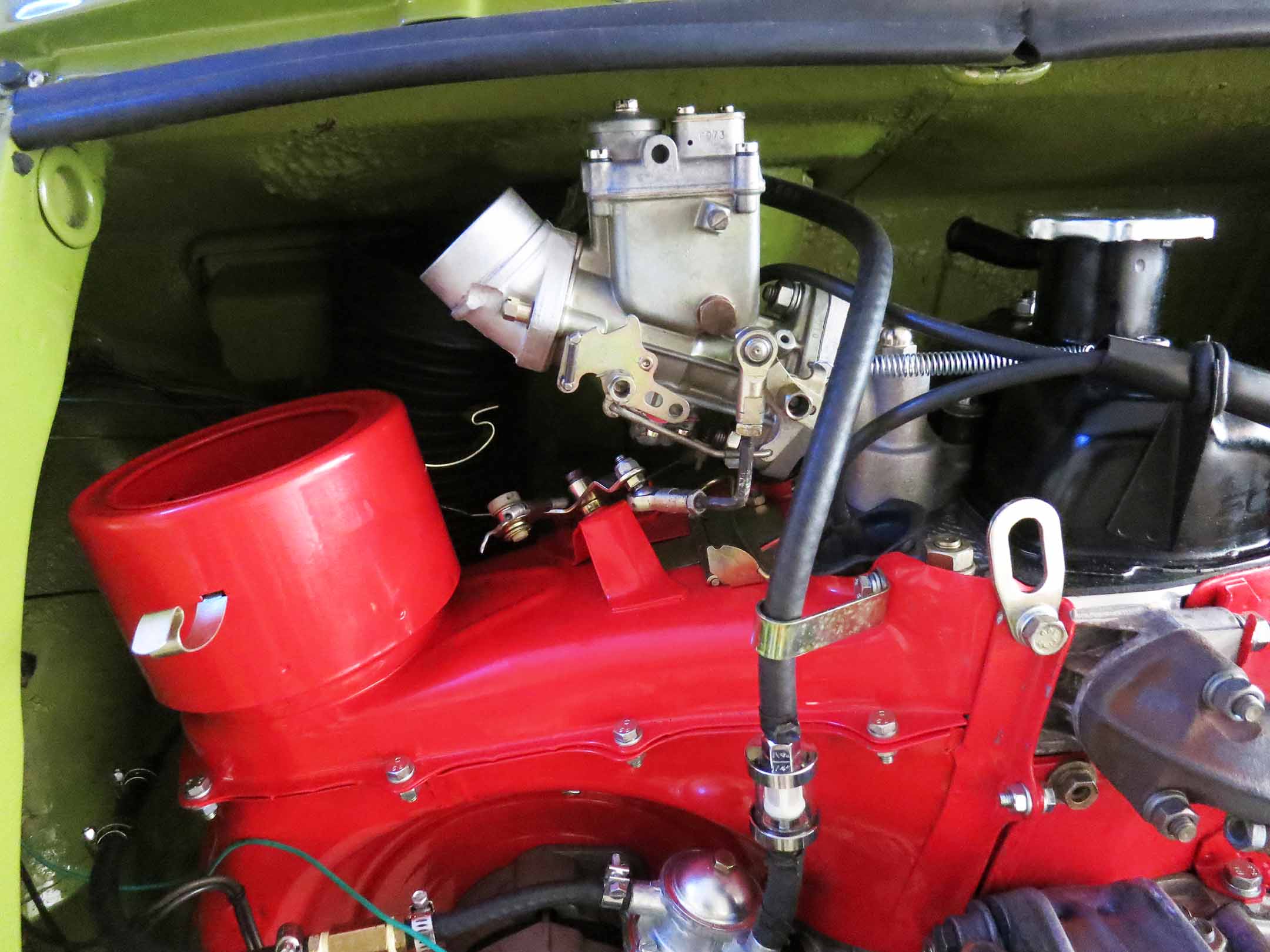

I'm getting pretty close to wrapping this up. I have the FZD 32/28 rebuilt and installed on the engine. The linkage was a royal pain and I'm still not thrilled with it. I'll probably end up making a new rocker arm assembly to replace the one on the engine, something that pulls more directly on the Dellorto throttle arm.

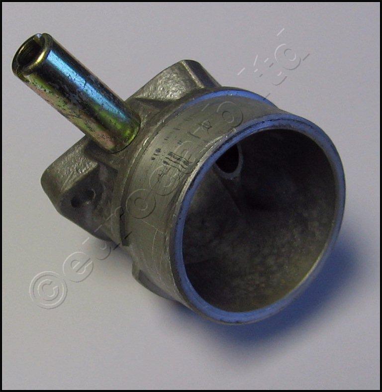

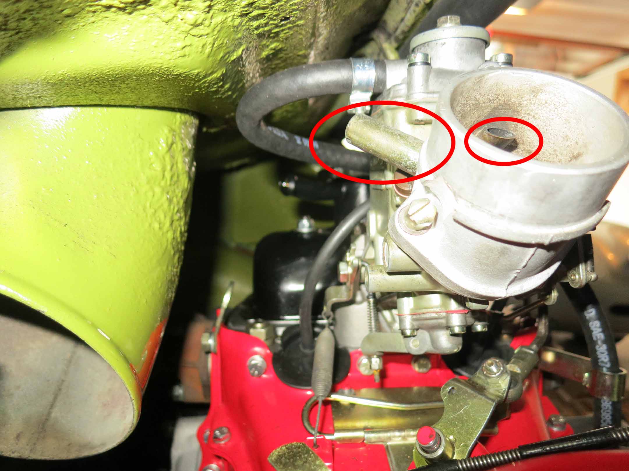

My Dellorto has an angled cast inlet which I was hoping to use but it looks unlikely it will work. The carb has a vent hole at the top of this which I'm not sure where it goes. Anyone have any ideas? There are three holes in the inlet of the carb; two are bolt holes and the third, on top, is an air inlet for something. Where should this go? I've circled it on the cast end piece.
Also, where do you run the vent hose from the valve cover?

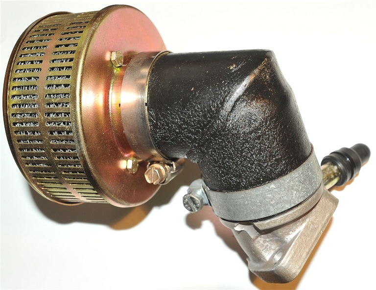

I also have one of those original Dellorto air filters and it's a pain to fit because of the angle. I ended up fabricating a 90deg angle piece which adds another bend and length to the air passage.
The inlet that you have circled would seem to be for the crankcase gas recirculation - a rudimentary form of pollution control. I just bunged mine off and directed the crankcase gases down the front of the motor and onto the road :eek:
Sometime I should do it all properly with appropriate diameters of tubing.
