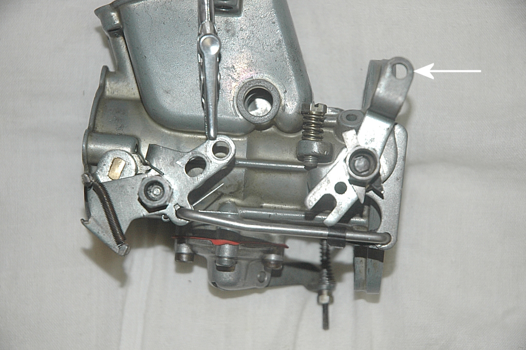

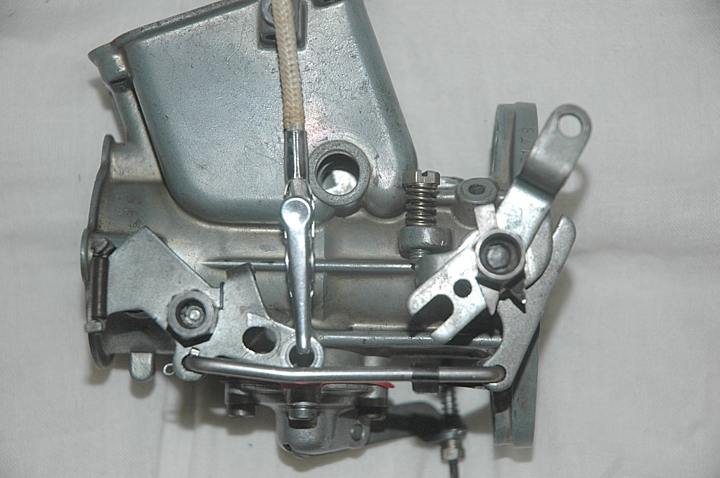

For those contemplating fitting one of these excellent carbies, I've attached an exploded diagram and the (my) english translation of the component list.
Occasionally the link between the main throttle and choke levers is missing but so long as the return springs are present to hold the choke butterfly open, it is not a major drama.
The link is used to open the main butterfly slightly when the choke is manually operated by the choke cable. If you don't use the choke - I don't but then I live in a relatively warm climate - then the missing rod is not a problem. If you use the choke to start in cold weather and the rod is missing, just push the accelerator pedal a little when starting and all will be well. I've attached before/after photos to demonstrate what I mean.
Happy bambino-ing,
Chris

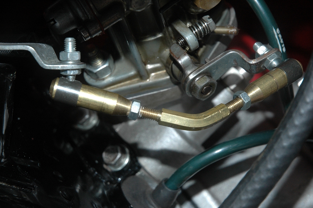

Throttle linkage setup

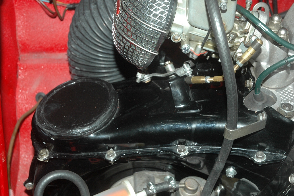

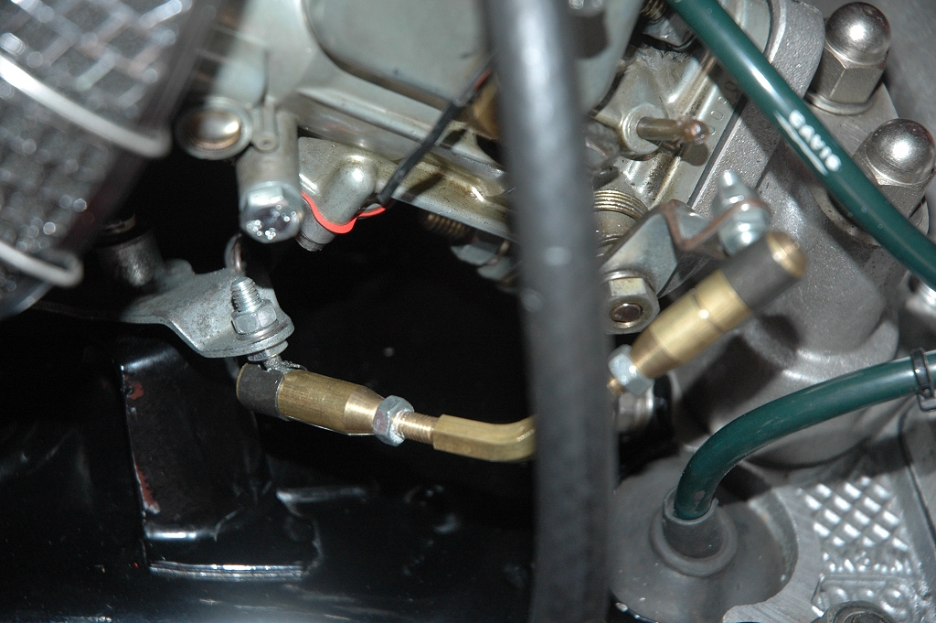

Once mounted on the manifold, connection is very straight forward. I retained the standard throttle cable setup to the top of the left-hand side tinware and joined from that point to the carby using a standard adjustable link. In order to clear the carby body, I gently bent the centre part of the link about 30 degrees.
On my car, the choke cable is not connected as in my climate I don't need it to start the car. It looks to be a simple matter to fit the cable if necessary.
One final point - these carbies can be configured so that the actuating links are on either side of the carby body. It would be worth your while making sure that the connections face the rear of the car prior to mounting it on the manifold. Swapping them over is not a major problem.
Regards,
Chris

Thanks very much for the photos Chris. Since you kept the original fan tinware and didn't go for an Abarth fan cover, how did you blank off the original air filter for the carb?
Not very well, I'm afraid - this is probably the ugliest part of the rebuild.
I cut the old air filter chamber off and had a mate weld a cover over the hole. It didn't turn out too badly, but at some stage I might redo it. I still have the old filter cylinder in case I want to reverse what I did.
Chris
I have done a couple of those covers for different carb set ups. One retaining the bracket for the throttle pivot mechanism (FZD carb) then another totaly stripped with that bracket removed (side draught twin choke Solex).
Like you Chris I did not like popping on a cap so I ground it all flush the welded in a plate so you just get a smooth flat top . I think that it looks better and thought that it might be better in terms of cooling air in that there might be less turbulence more like the "snail" housing on the German Bambino :)
Thanks Chris and Toshi. I'd thought about getting an alloy fan cover, but then it occurred to me I'd need to re-attach the throttle pivot. Your way will definitely save me some money and gives me an excuse to use my MIG welder.

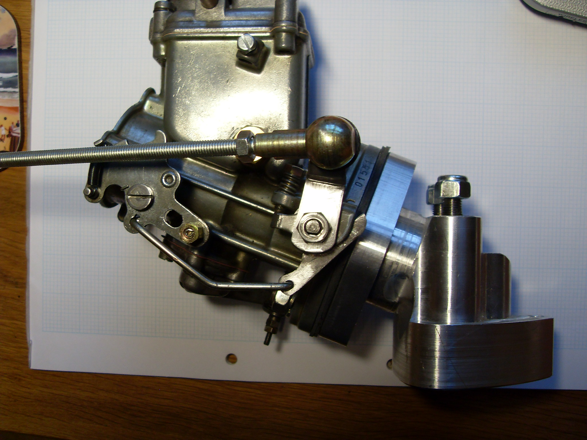

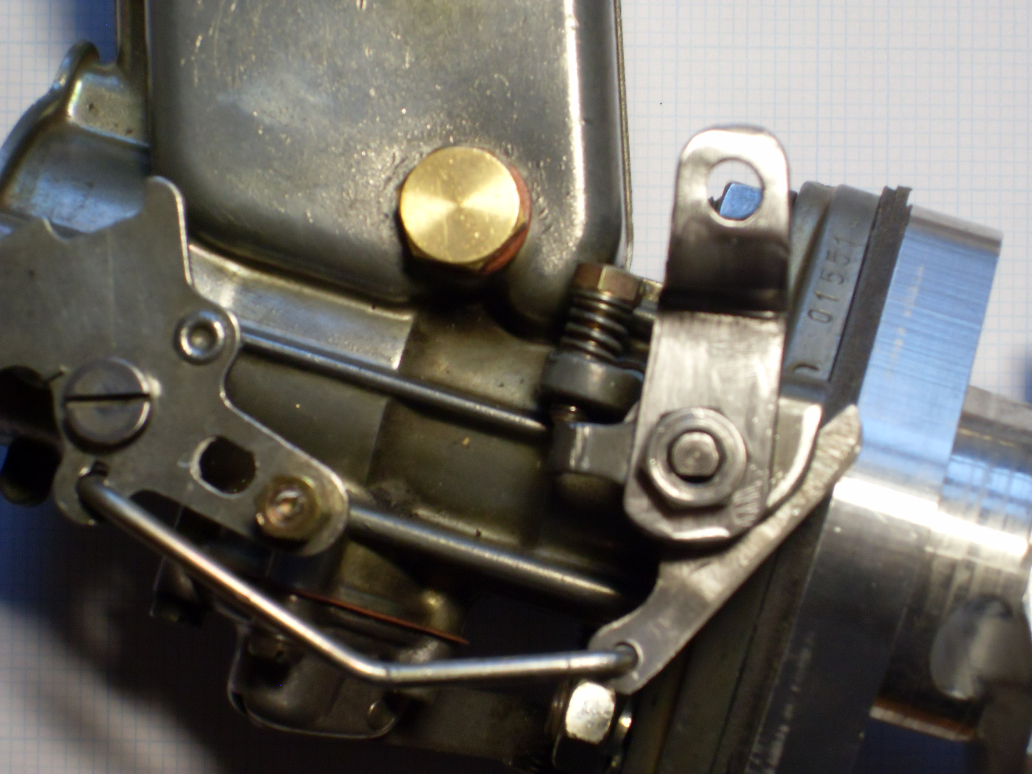

Hi Matthew,
I've fabricated a new throttle lever for the FZD and also made up a throttle Link out of 6mm threaded rod and 6mm ball joints. I'll cut the thread to the right length and bend it so it has a straight pull from the throttle crank to the throttle lever.
Hi Chris
thanks.
The ball joints at both ends have 12mm of 6mm thread so the rod can be adjusted by about 12mm to leave enough thread in the ball joint for security. When I pop across to Matthews to fit it we'll let you know how well (or otherwise) it works.
