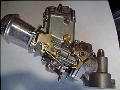

I found a good one for sale in Sicily. It comes with a full rebuild kit, spare manifold and trumpet, so I bought it. I'll let you know what happens.
Chris

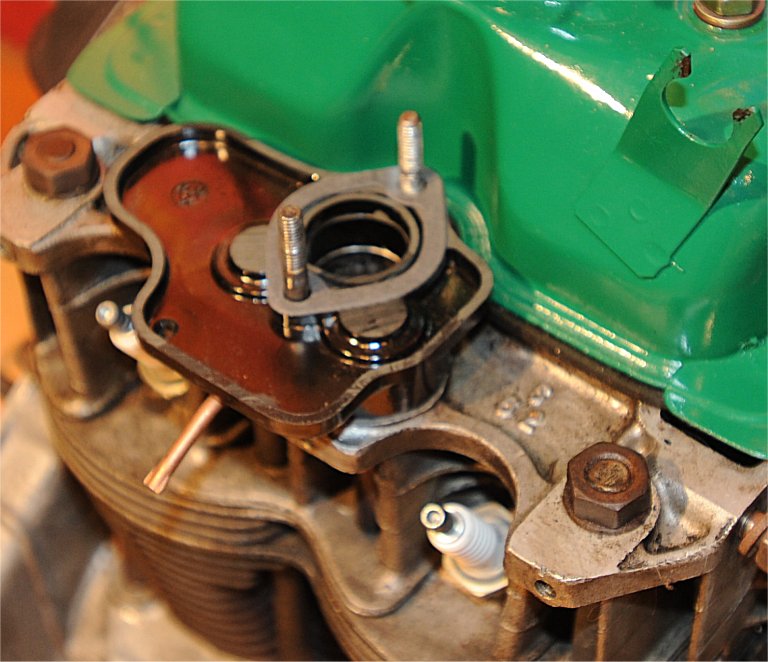

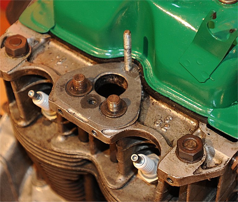

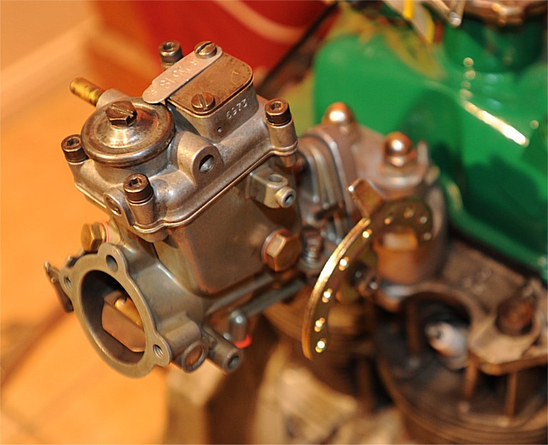

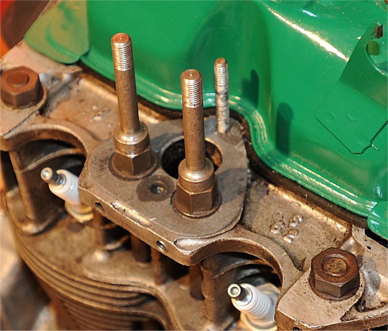

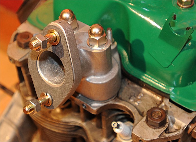

As the engine is still out of my car, I've taken the opportunity to change the carburettor. It is a very easy job - so far.
Once the Weber is removed next remove the bakelite baseplate.
Then remove the two centre head nuts and the outer carby mount stud.
The new posts (supplied with the new manifold) are screwed on where the head nuts were removed and torqued down.
The manifold slips over the top and is secured front and back.
Finally, the Dell'orto carby is fitted directly on to the manifold. These carbies are not heavy and do not need to be supported like the twin barrel DCOE's or DHLA's. The larger twin barrel carbies also require a soft mount to get around the problem of fuel agitation in their rather shallow fuel bowls. The little FZD seems immune to this problem.
Tomorrow I'll mount the engine on a stand, attach an exhaust manifold, distributor, fuel etc. and give it a test run. I'll tune it as best as I can. I'm doing this to get an idea of how hard or easy it is going to be to mechanically connect the carby and of course to have a general fiddle around ....
When I finally fit whatever engine I end up with in the car, I'll take it to the local dyno guys and get it tuned properly.
Chris

Yes - I'm very happy with it.
The car cold and hot starts easily and idles smoothly without the use of the choke. It accelerates well without flat spots, though I've not yet had it on the dyno so I can't give you power figures.
IMHO, this carby is miles ahead of the IMB Webers and far less tempermental than the twin carby (Weber DCOE or Dell'Orto DHLA) setup that uses a Panda twin throat head. It mounts directly onto the appropriate inlet manifold without the use of the intermediate antivibration mounts that seem to crack and entrain air over time. Plus, it looks good to boot.
I wish Dell'Orto would remanufacture them as they are rare as hens teeth. On a positive note, they do share some parts with the DHLA series which remain available.
I scoured the world over a period of months and found two - one complete and the other a 'parts' carby - 32/28s in Sicily. My other option was to use a Weber 30DIC, which, I'm told, is a pretty decent device. The DIC is a progressive twin throat downdraft carburettor, which when fitted, doesn't seem to leave much room for an air filter, though I'm sure that this minor issue can be sorted.
My engine ended up as a 695cc with 35mm inlet valves, appropriately widened inlet tract, a 'sports' camshaft and a twin pipe exhaust. The compression ratio was raised by using a copper head gasket.
All up, an interesting and fun project.
