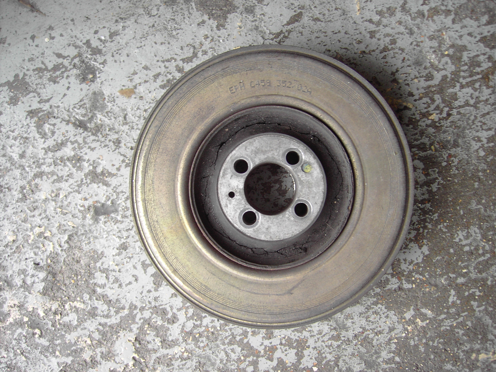

Normal reason for a noisy crankshaft pulley is the rubber damper cracked.

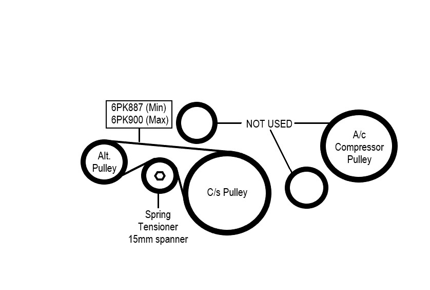

I did the same on one of my Stilo JTDs. (The A/c was leaking and not worth repairing). To eliminate the A/c compressor pulley, the 2 idler pulleys also have to be bypassed. Only way I could do it was to fit a much shorter drive belt. The length of the new belt is critical or it will rub on the top idler pulley, which could cause a noise.
