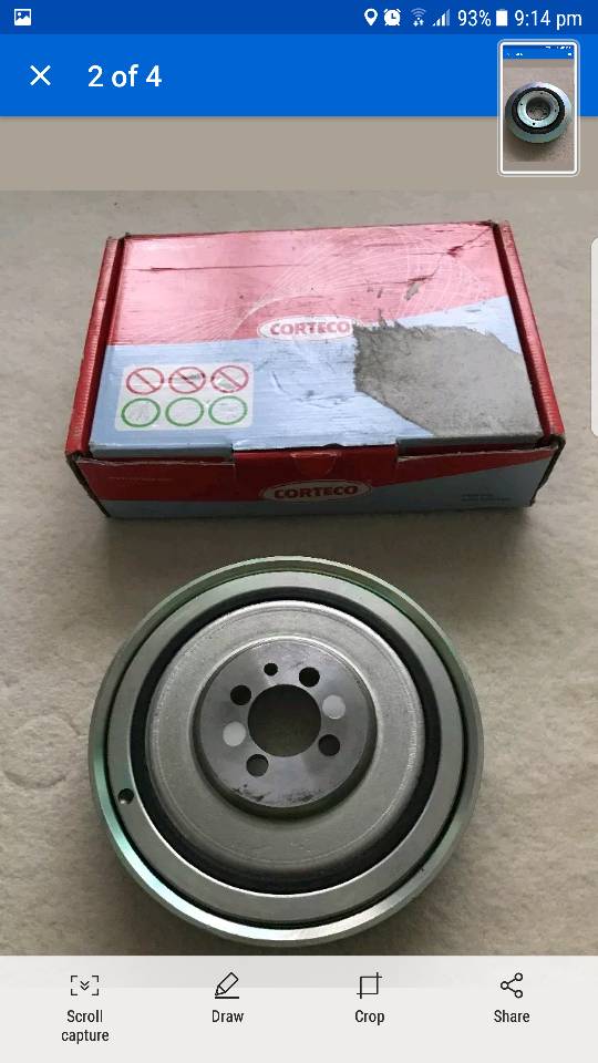

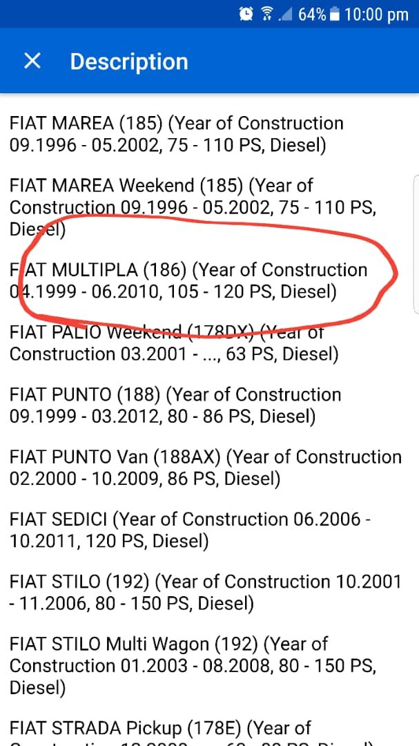

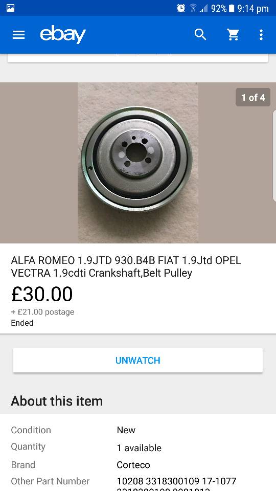

Hi. I bought this crankshaft pulley damper for my multipla jtd. Unfortunately the original multipla's aux belt didn't fit in as too short.
The length of standard belt is 6k1835 but i had to replace with 6k1875. The crank pulley damper was straight fit.

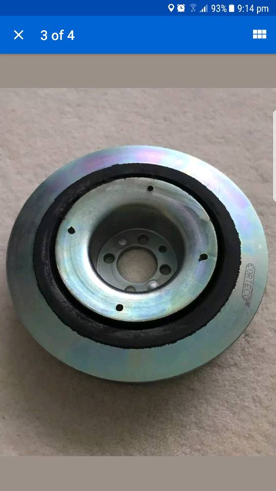

I found the outer pulley metal is slightly bigger than standard one.
