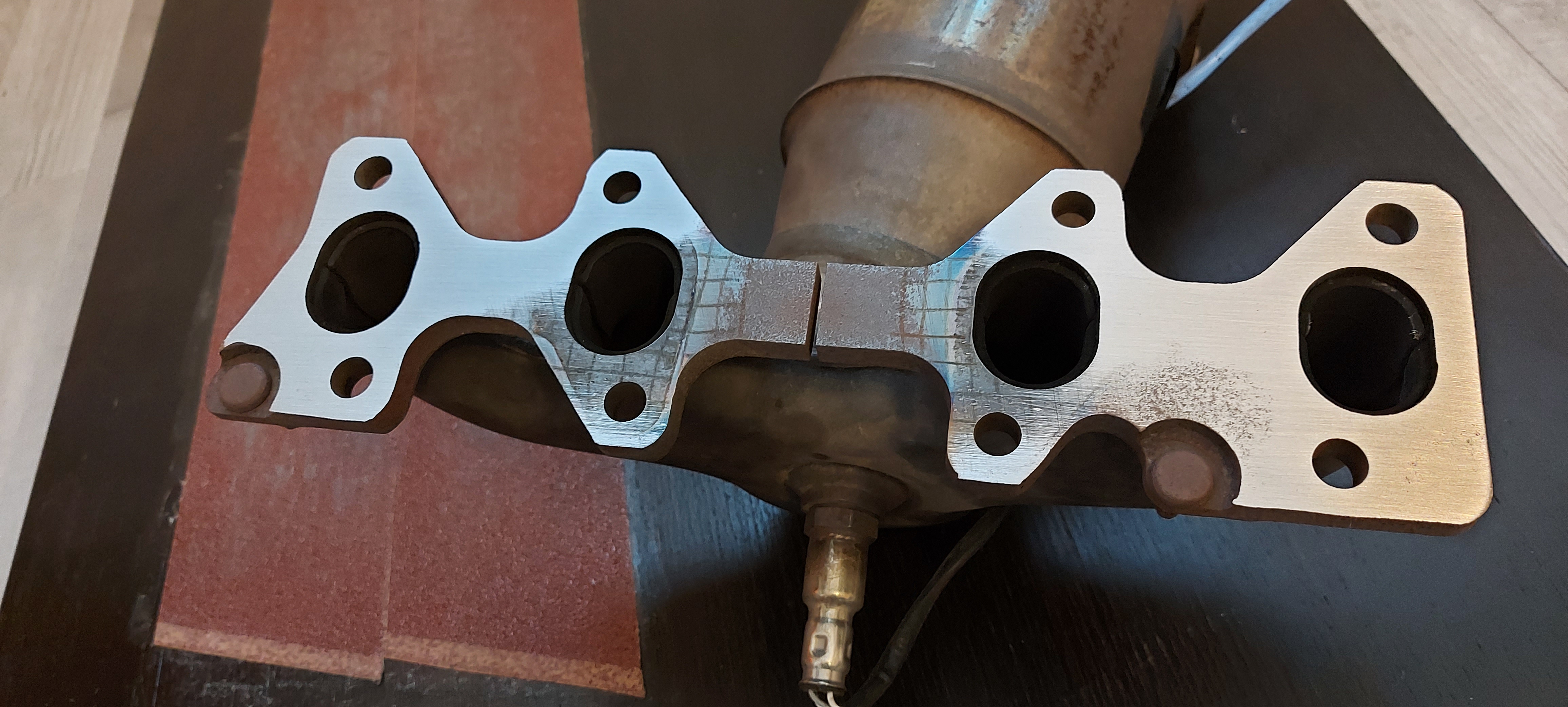

These days I'm working again on exhaust. Last time I felt exhaust manifold gasked leaks from 2nd and 4th cylinders. Nothing horrible but it was there. Plus leak from 2nd gasket between catalytic converyer and 2nd exhaust part. So I'm grinding exhaust manifold again to make it 100% flat. I measured only 0.05mm diferences. As you remember, engine was overheated and that caused these small ex.man. shape changes. Bought new gaskets and now I'm grinding ex.man. like slave :) It's hard manual job, that's why I'm working on it 3rd day, and surface is still not completely flat (as I mentioned there are still 0.05mm diferences on few places). Butain source of engine noise come from gasket between manivert and 2nd part of exhaust. Here I habe to make flatness of both surfaces and use new gasket - thats easy job to do. And rear silencer is leaking too, so I'll buy whole 2nd exhaist part and everyting should be ok for next 5 years ;-)
Picture from grinding process - I made grid with marker on whole ex.man. surface to see "where we are" :) And this is where I need to get

Today I cleaned head exhaust output surface with soft pad, just to remove old dirt. Regarding grinding - on pictures you can see that I used old doors, where I glued 2 sandpaper stripes. Those are for metal, with marking P40. Each stripe is 0.5m long. Don't think (when you want to grind anything, for example cylinder head) that your desk is flat! You need minimum half meter long flatness tool to check your surface before you start grinding! My old door which I used was 0.1mm curved on one side. So triple check surface with some realy flat tool and gauges, and then glue sandpaper on it
