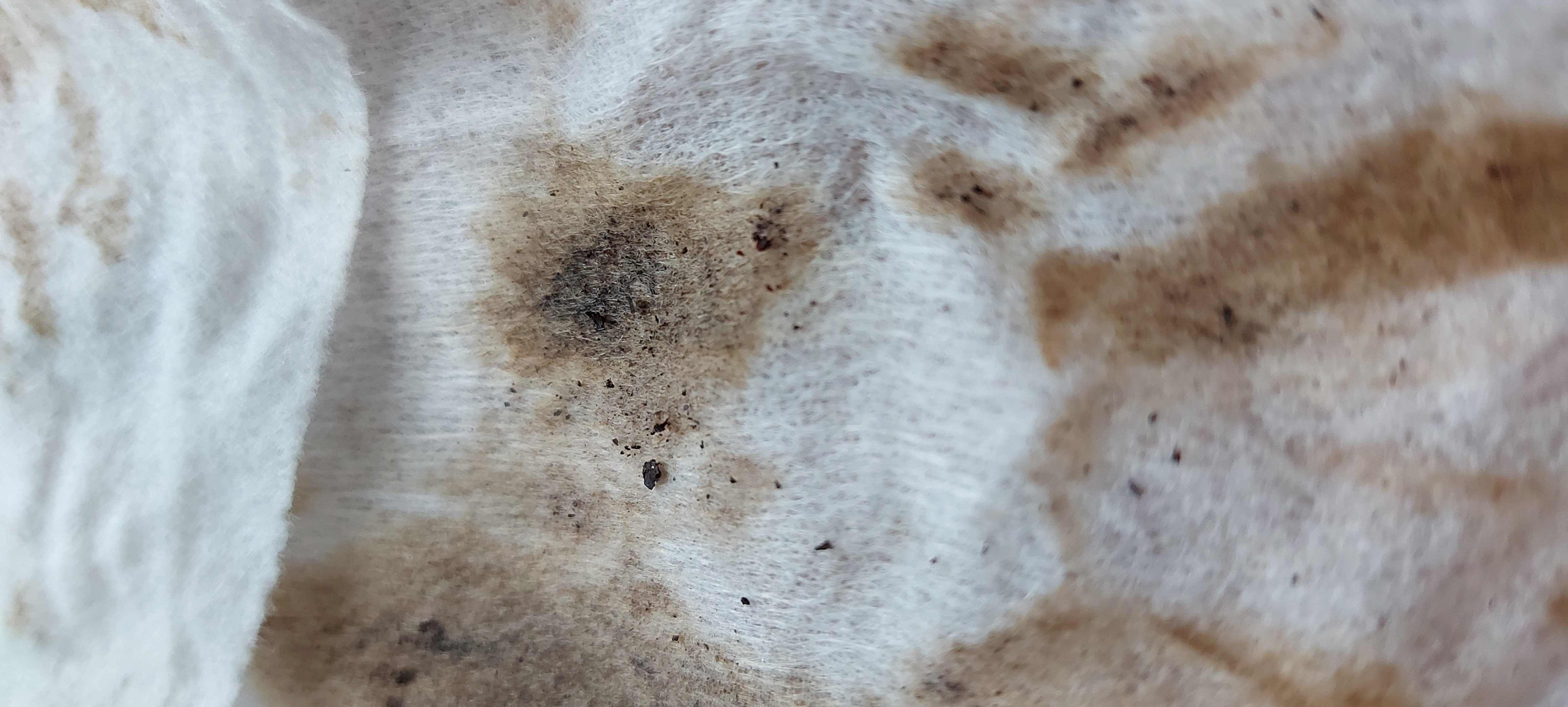

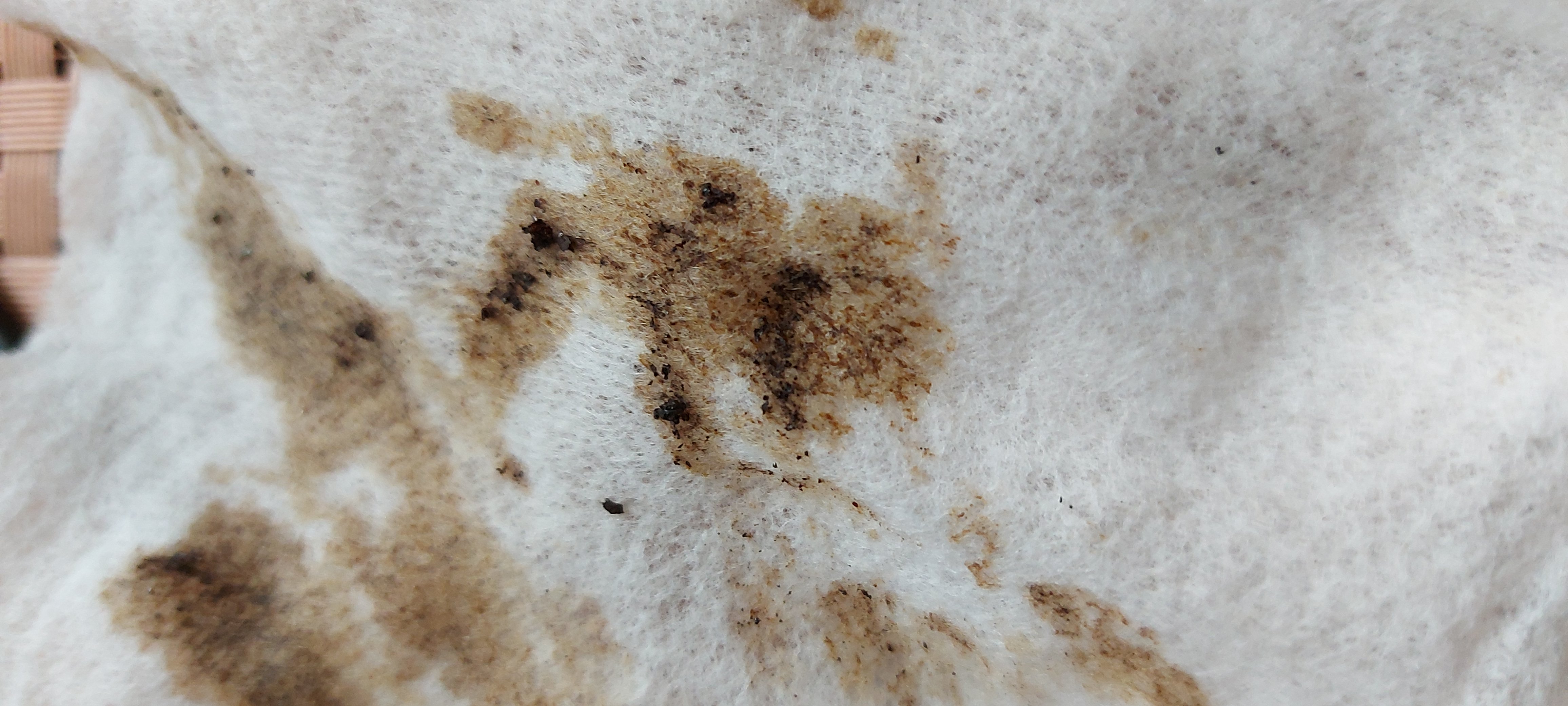

Guys :-( My happiness is over ;-( Today I checked oil and there were non-metalic particles on dipstick. Almost quarter of dipstick was covered with it. Like old burned oil. So engine is still not clean after that overheating. During 1,5 years there is 3rd oil, once also flushed with flush agent. Oil is also leaking a little bit somewhere between engine and gearbox, but it's like a thin film on oil pan, no drops on ground. But rear crank seal was replaced with new one, oil pan re-sealed. Cannot determine if its gold or red...its just dirty. Oil level also surprised me because 0.5 year ago when I did oil change I gave there to MAX on dipstick, and now is slightly above MIN. But I have no smoke from exhaust.
So, I will not ride the car. As 1st I have to drain it abd analyze whats in the oil. I'll also check variator valve for deposits on it's sifters.
Then I'll make double flush with diesel. Yes, double flush, each time to change filter. Because that debris can damage good parts.

Picture of debris. Fortunately its not metalic after analysis

That's not that bad, small amount of dirt. Don't trip yet.
It was suggested long time ago (year ago?), to drop the oil pan and clean the engine mechanically as much as you can, scrape the deposits. Same with valve cover (head internals). Oil pump inlet (screen) too (it's partially clogged now, probably).
No chemicals will remove it safely (to the engine, seals, exhaust components) and completely.

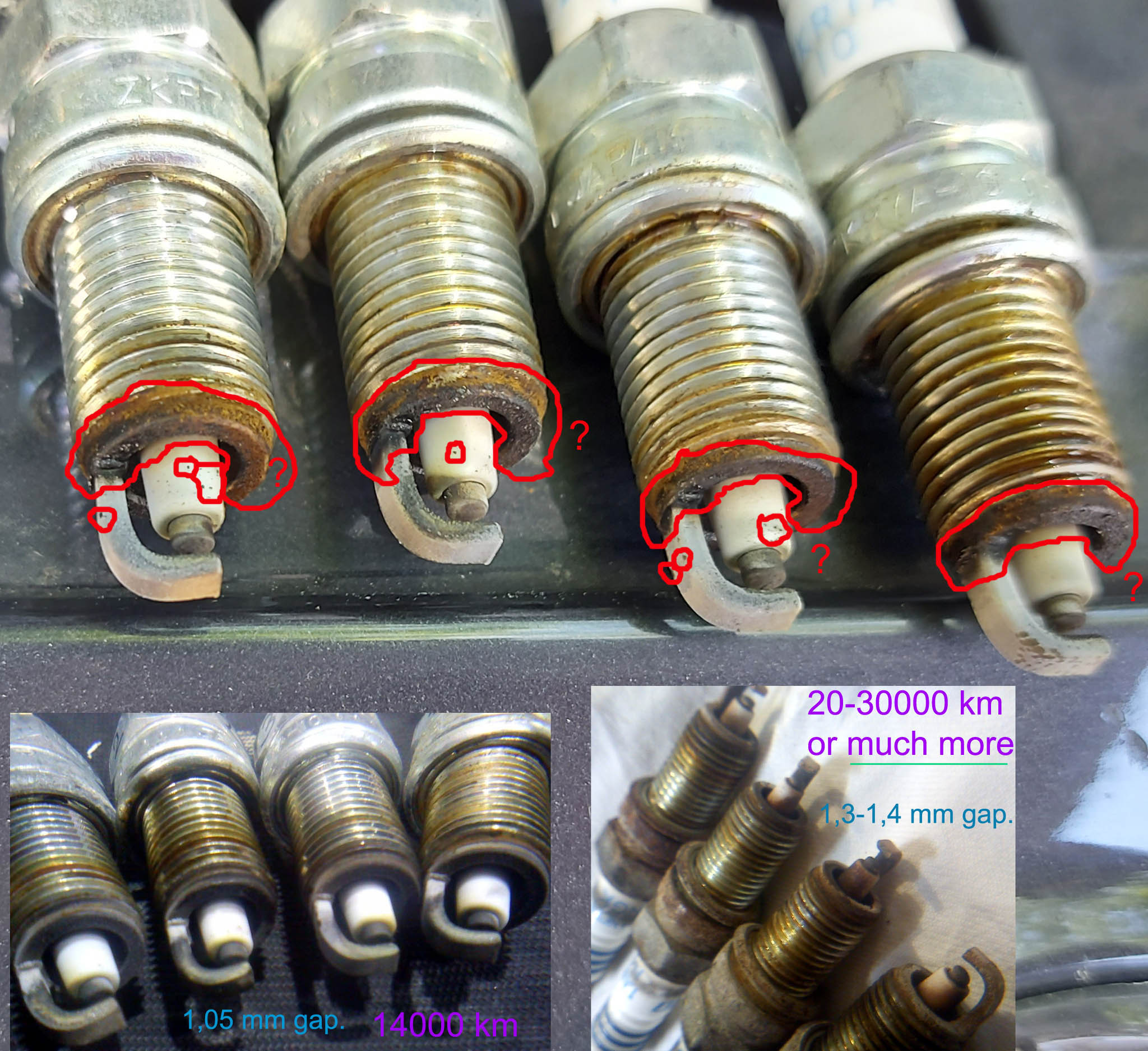

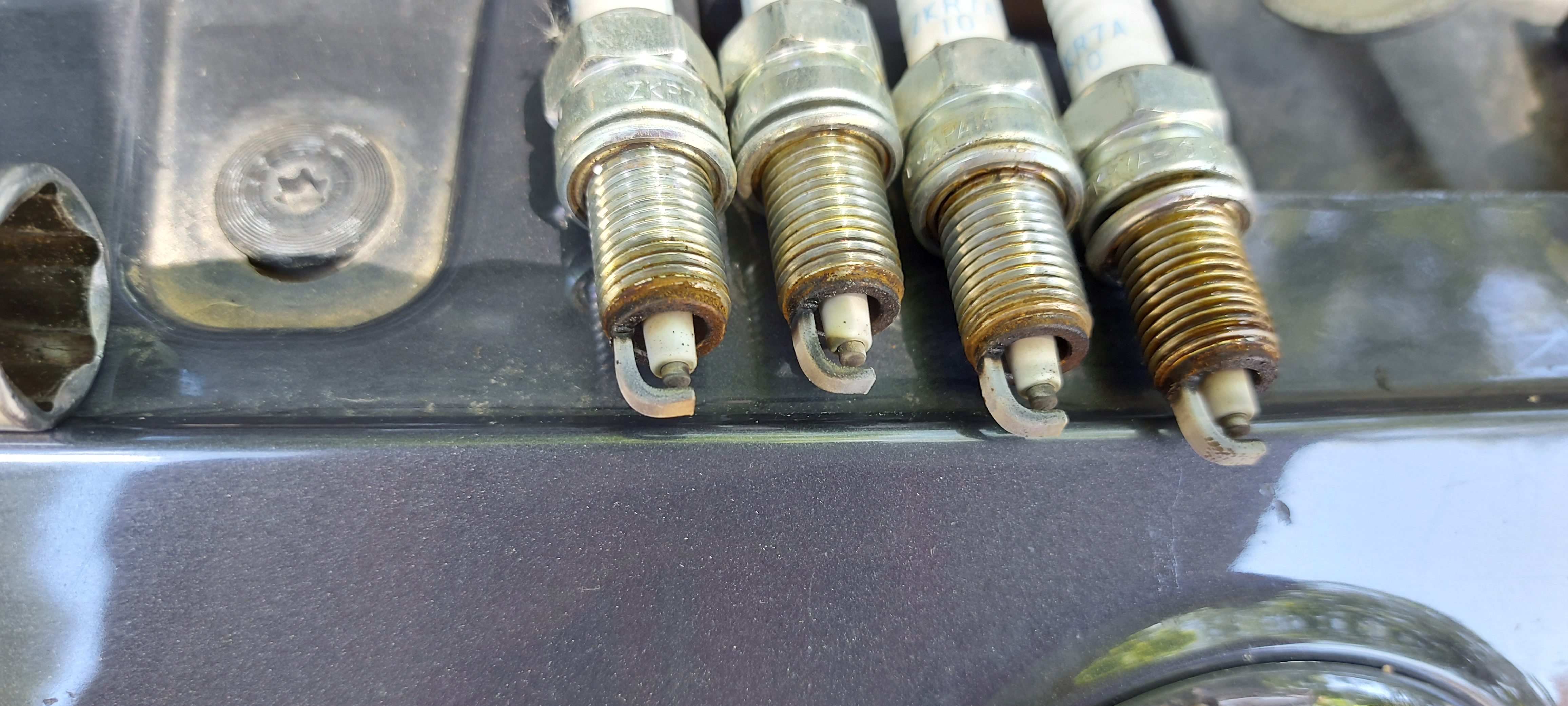

So flush liquid added for 15 minutes. I found that dipstick is clean now, no debris on it ! ;-) Happy. I'll leave old oil with flush liquid in motor for a while, maybe flush liquid will clean oil inlet a little bit. Today I removed spark plugs and moved engine through crank bolt to get pistons to the same level, for adding kerosene. I added the same amount to each valve, and after 24 hours will suck it out to see, how much kerosene ran down via piston rings in each valve
And all spark plugs has good color after year

Something is...not-perfect about those plugs. A little bit too much weird residue or corrosion (at the ends of the body/threads) and some "spatter", black dots on the insulators...
Colors are "OK". But it's not about colour only. Amount of build-up/residue and "texture" counts too.
Or maybe, it's time to swap them (buy a new set). What's the "gap" (how much wear/erosion)? And mileage?
Brand-new NGKs have 1,0 mm. DENSOs 0,8 mm.
Compare to my 2 different sets, older one (unknown mileage, 30k minimum) and more recent (14kkm). But it's a double fuel (petrol/LPG) car...burns a bit different (long story short: cleaner but hotter and more water in the exhaust).
And what means those black dots on insulation? Car was on idle for very long time, I mean 2-3 hours almost daily (you know...Corona, isolation, drinking coffee or beer in car, I needed some heating during nights, thats why it was on idle). But this is over, I'll never do it again. Plugs are NGK, 1 year old and 8000km on it. But mamy times very very short trips. There should be gap 1mm right?
That corosion - maybe because I had manivert out for a week and sometimes was rainy, or wet air...I dont know why all spark plugs are rusty on their endings. But no error codes, starts ok, running ok. Strange!

And that corrosion on spark plugs - it dried over night and today it doesn't look like corrosion but carbon. I gently cleaned it with soft grind pad and now are shiny like new.
