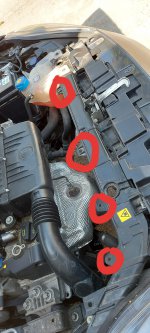

Guys, I dont know where to post this...does anybody know why there are holes in plastic? Is it for some engine cover? Or is there something missing on my Punto?
I've never seen anything mounted there.
Search with Google-pictures, "grande punto engine bay". There is nothing there.
PS
You've missed one "ear", at the bottom of the picture. There are 5 or 6 of those total.
Yes I googled before I posted it here, but nothing found. Strange that it's there but for...nothing :) I also saw on another Puntos/Grande puntos some plastic piece (like plastic stripe) at the bottom of front bumper, which is also missing on mine. I have holes there too but that part is missing
