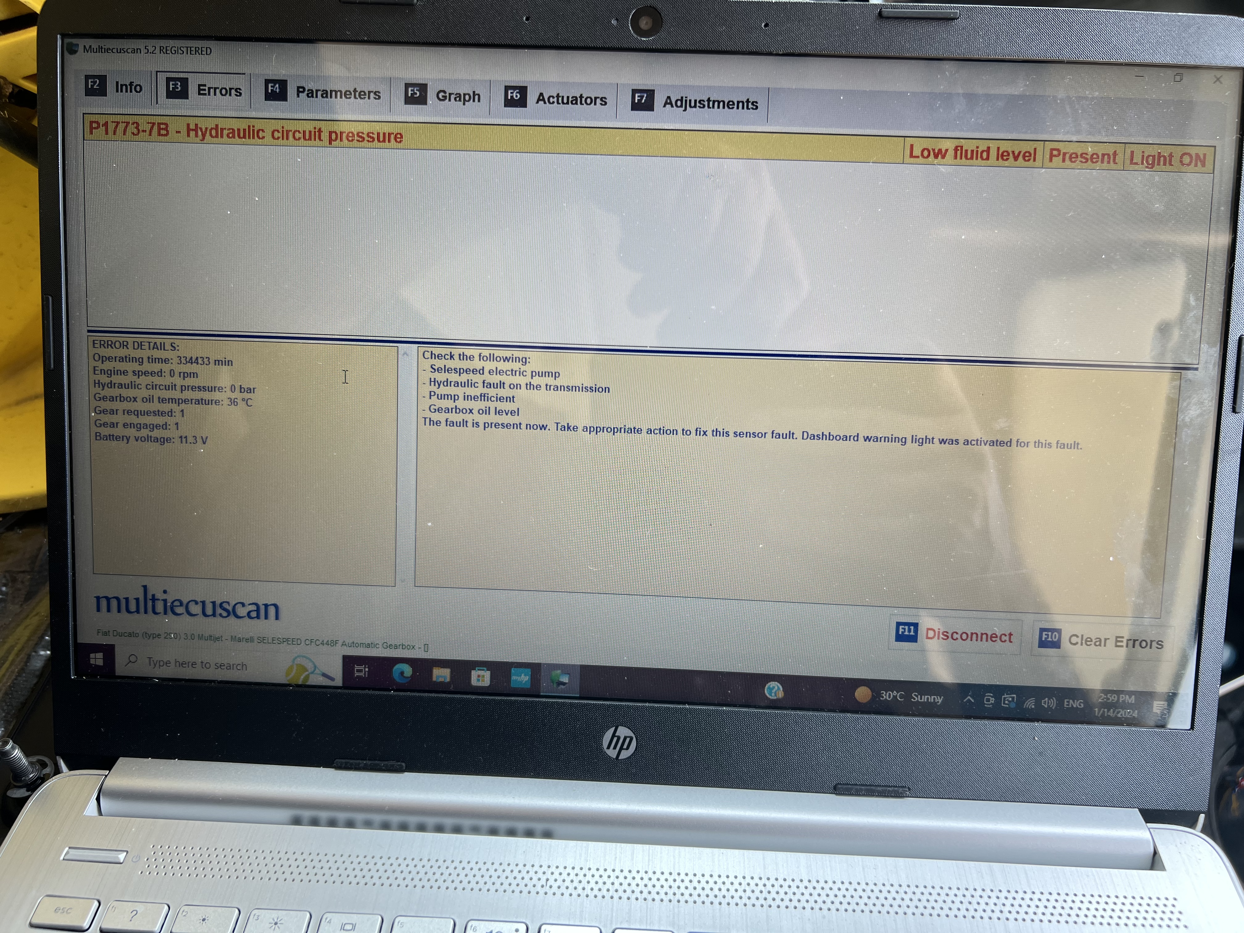

Wonder if any one can help I have a 2015 fiat Ducato 3.0 multi jet desel and my hydraulic fluid got low and am stuck in 1 gear I have now toped it up now. Was just wondering if any one can help with programming the gearbox I have downloaded the mes software and it’s registered any help is appreciated all attach pics

Battery voltage is extremely low, as 10,8 V is the very minimum before the battery dies.
First of all charge the battery properly. It should be around 12,6 V. Remember that the alternator does not charge the battery as it should be done.
I assume you've tried to erase the error and it didn't help.
Have you checked the Adjustment tab? There are a few adjustment to make depending on what was the issue. And... that's the real question. Why the fluil level was so low? A leak? Wear of the parts?
I erased the error and it came back there’s no leaks under van yeh looked at the adjustment tab but not to sure what to adjust all that happened I parked the van up and forgot to put in nuatral then when back to start the van was stuck in 1 gear then scanned it and it sayed fluid was low

One more thing: you shared two photos of the screen. The first one with the modules scan. It shows the Selespeed 348. Then on the next photo you're connected to the Selespeed 448 module. Settings can be different for each of them.

The error message was: Hydraulic Circuit Pressure low, not fluid level. Yes, a very low fluid level may be the cause but there are several other possible reasons also. To my knowledge, there is no fluid level sensor, I think MES just makes some assumptions based on the fact that the pressure is low.
(The fluid container should not be full, there is a maximum level mark on it, quite hard to see).
Since there now is fluid in the system, I would check the hydraulic pump fuse and relay as next step, starting by using the command in F6 Actuators to start the pump and listen if it runs (for a few seconds only). If it does not run, I would check fuse F69 and relay T55.

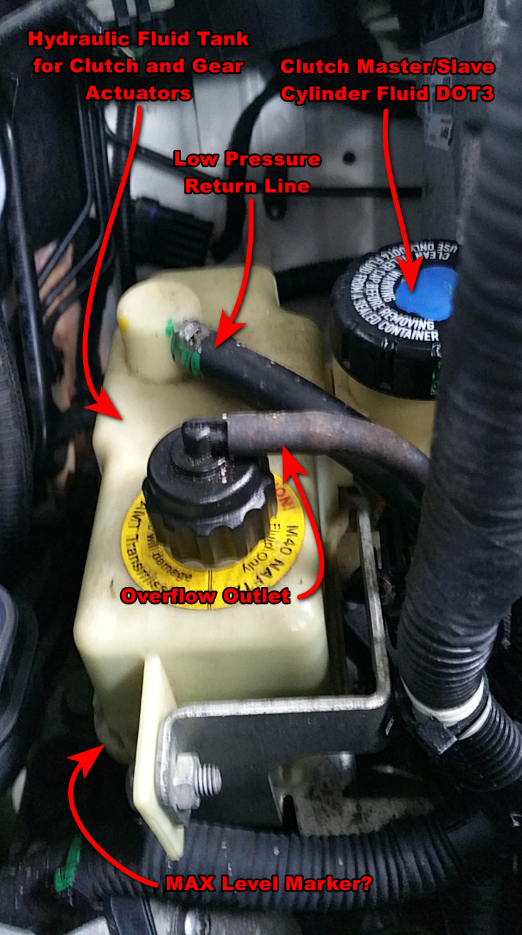

I'm not absolutely certain, however I'm led to believe the "Max" fluid level mark on the Hydraulic Reservoir is the "join line" where the two halves tank bottom and tank top join together see image below - please correct me if I'm wrong. I've been unable to detect any other "Max" level marker and this joint line was mentioned over on another forum. I mention this, as it's quite alarming how far down from the top of the filler, that level is and that's where I found mine when I first looked. Nonetheless, if you've over filled it, I'm also led to understand the excess will eventually drain out of the overflow tube as the system levels itself during use.
Hopefully someone on here can confirm that is the level marker in the image below. Please correct me if I'm wrong and I'll fix the image.
