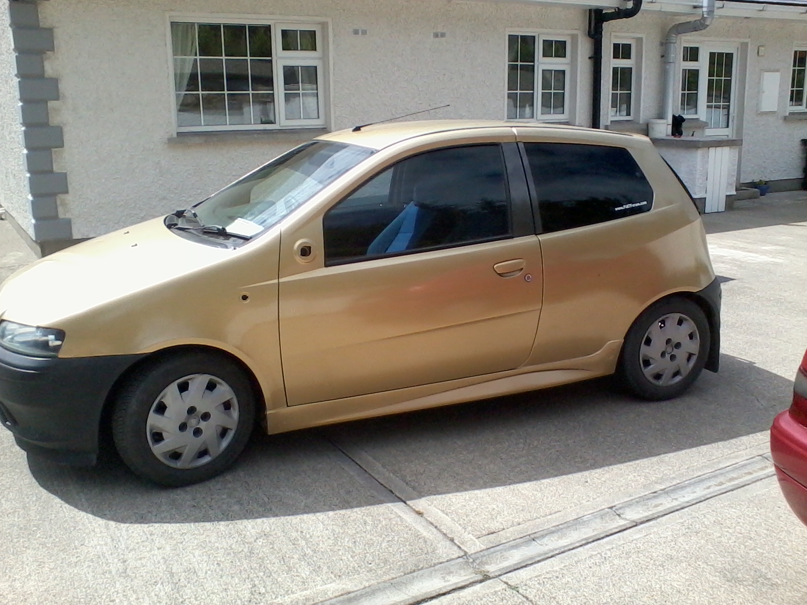

Hi all,
Heres my progree blog of my work in progress
Bought it in May,
then after a good service and wash/polish
then after i done tints...
and carbon fibre effect badges
then alloys
cc'd wing mirrors
hopefully be getting a few bits n piece to make it look like this soon
Door handles will probably be done, but leaving them in for now, ill wait til its in the garage til i take them out.
Not too sure about debading, i like my carbon fibre badges, & I find the rear wiper too useful as rear screen gets very dusty!

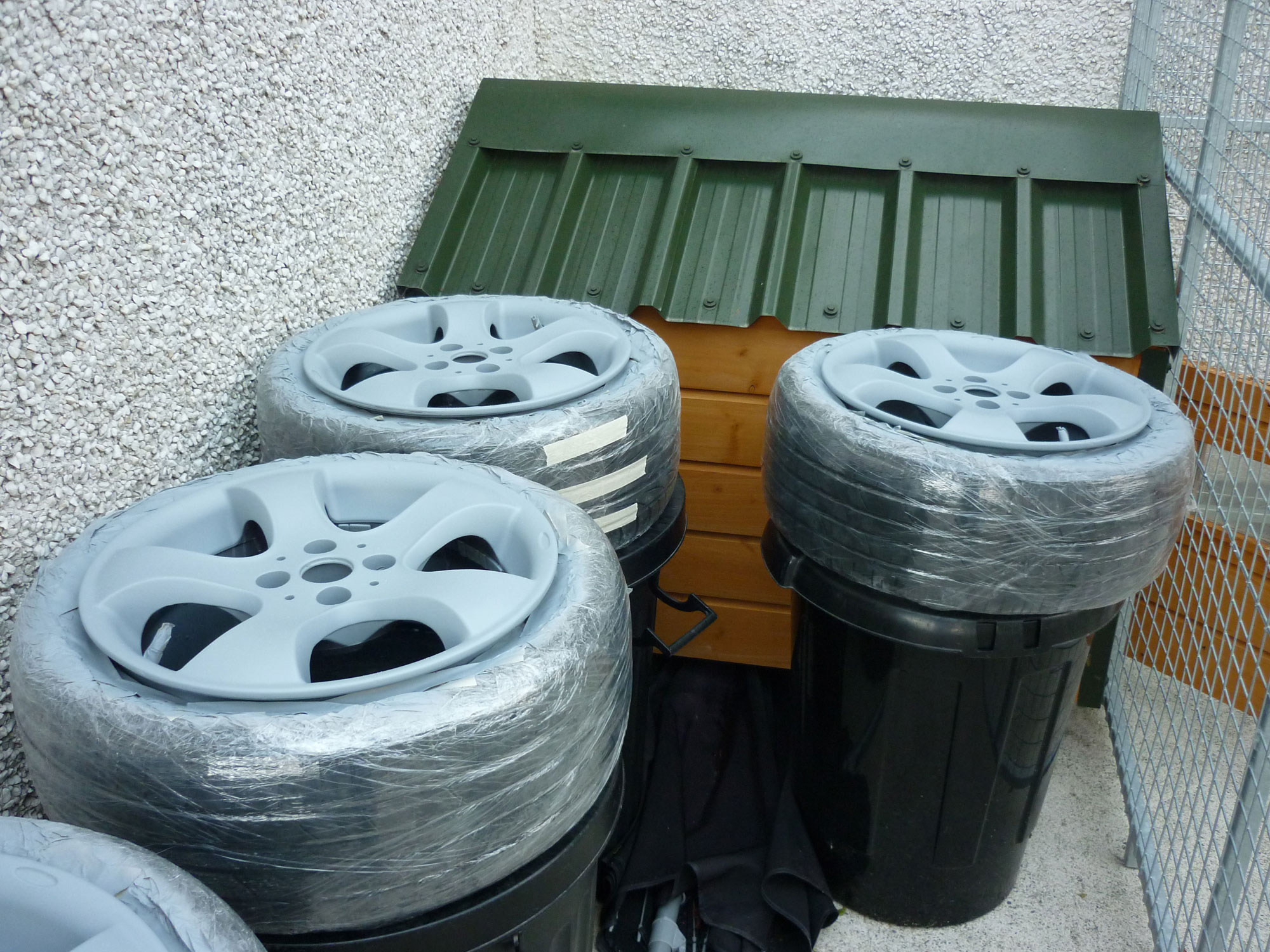

Stripped down 1 of the alloys (the 1 i got the petrol on initially), put it in a large tray with a small amount of petrol, wasnt long until the petrol was a swirling silver mix!
Rest of the wheels are gonna be rubbed down and filled, no need to strip them.

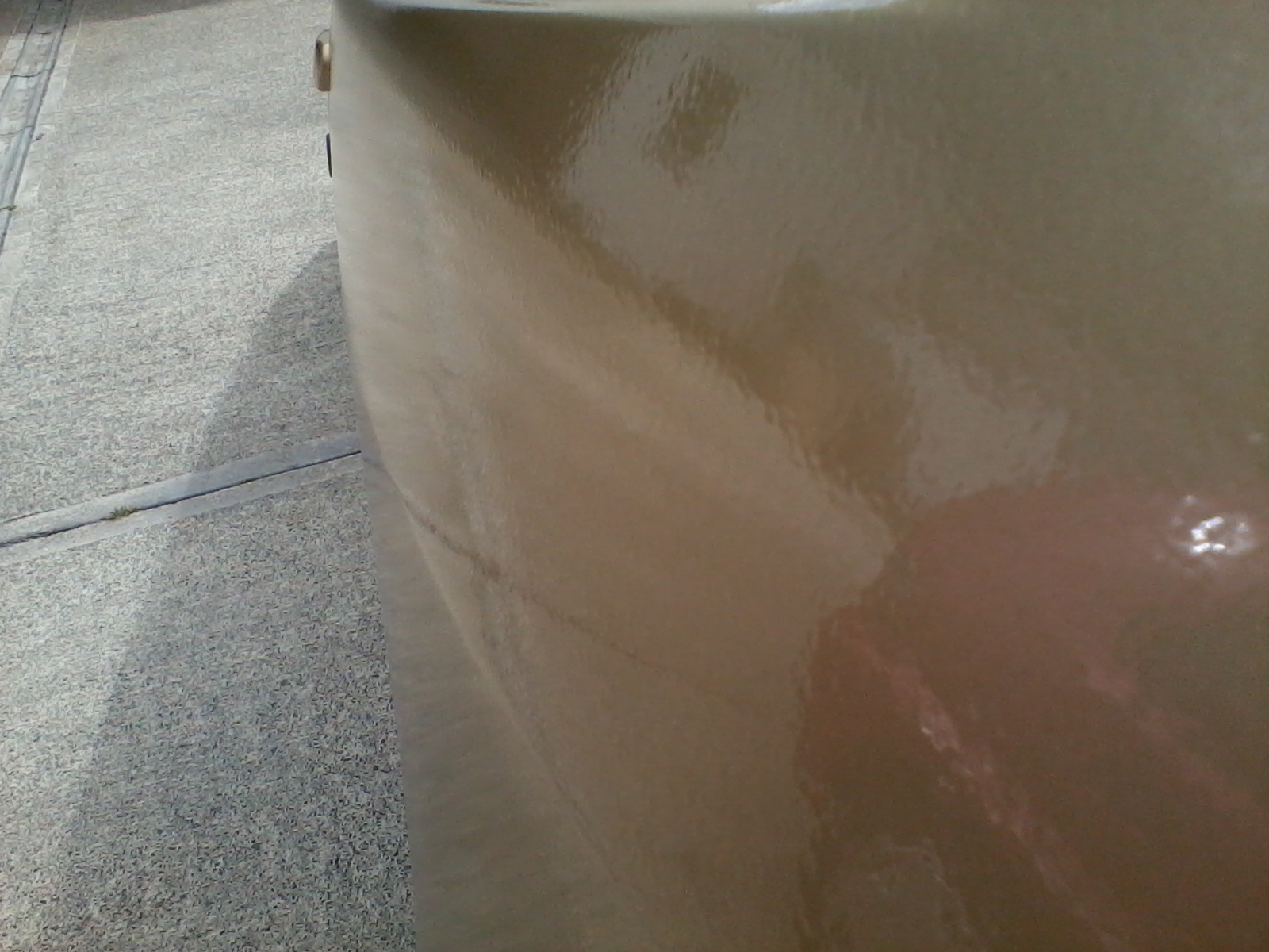

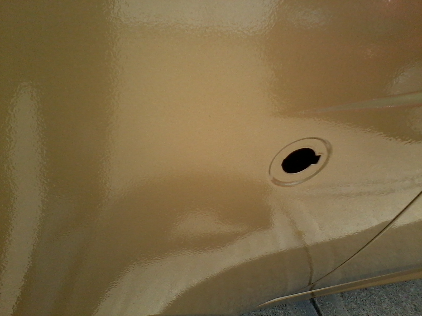

Clear coat turned out to be a mess....went all orange peel effect, not sure why though...
Colour & Blending looks ok, but its this orange peel thats really annoying me now. Dont know how im gonna sort it, wet sand & polish seems to be the only option.
wow man thats a good job, shame about the orange peel though:( could be a few things though its either damp, laqure was too thick, or the spray pattern wasnt fine enough.
despite that its going to look **** hot when its done(y)
