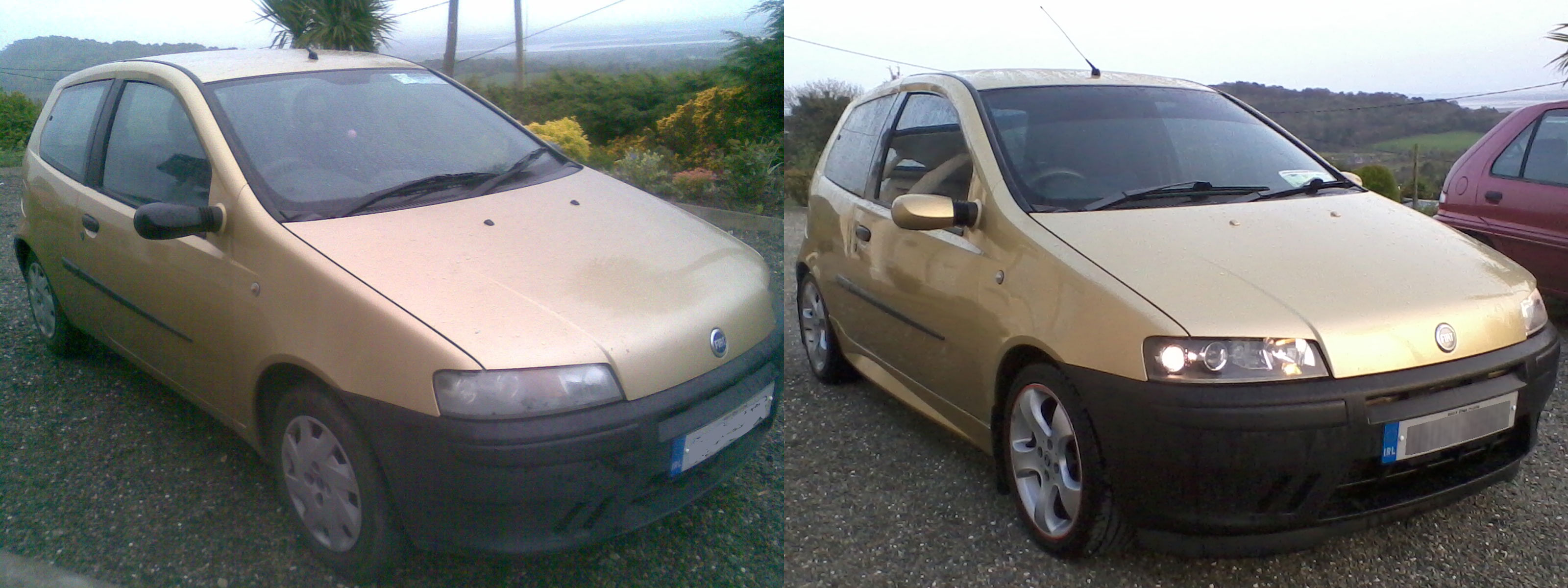

Bought it in May,
then after a good service and wash/polish
then after i done tints...
and carbon fibre effect badges
then alloys
cc'd wing mirrors

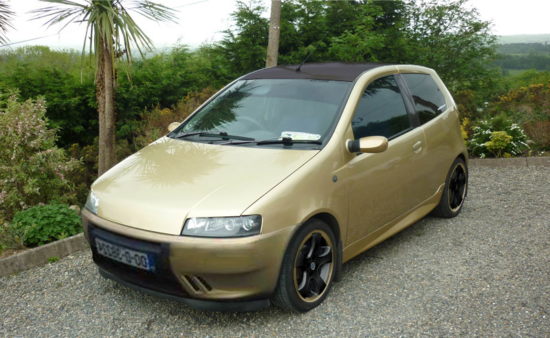

hopefully be getting a few bits n piece to make it look like this soon
had a play in photoshop....got a bit carried away lol...
smoothed bonnet, side strips & front bumper
c'cd bumper, handles
delocked
black roof
tinted side repeater
alloys matt black with gold lip
would need a tonne of work and an even bigger tonne of money to do it...would probably need a full respray to eliminate the colour fade and repair damaged paint under each side strip...
Not sure on alloys, theres not enough of a lip on them to have anything more than 9mm stripe..

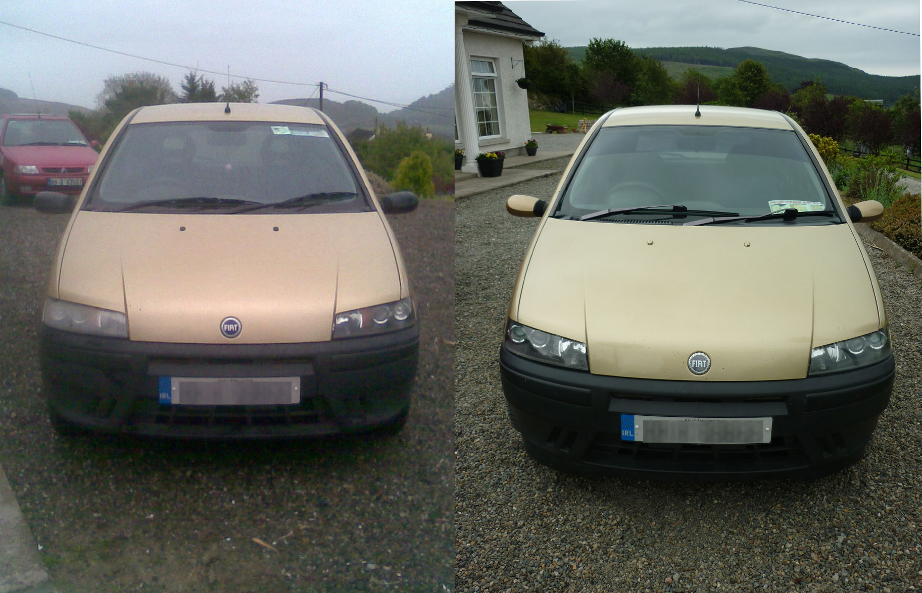

what have you used to clean your car, especially the head lights they are so clean

Headlights have been sanded lightly and polished using cheap-o-scratch remover. Rest of the car is polished with meguires techwax, its the only polish I will ever use, so easy to put on/ take off, unlike turtle wax etc which leave a powdery risidue that takes ages to clear away.

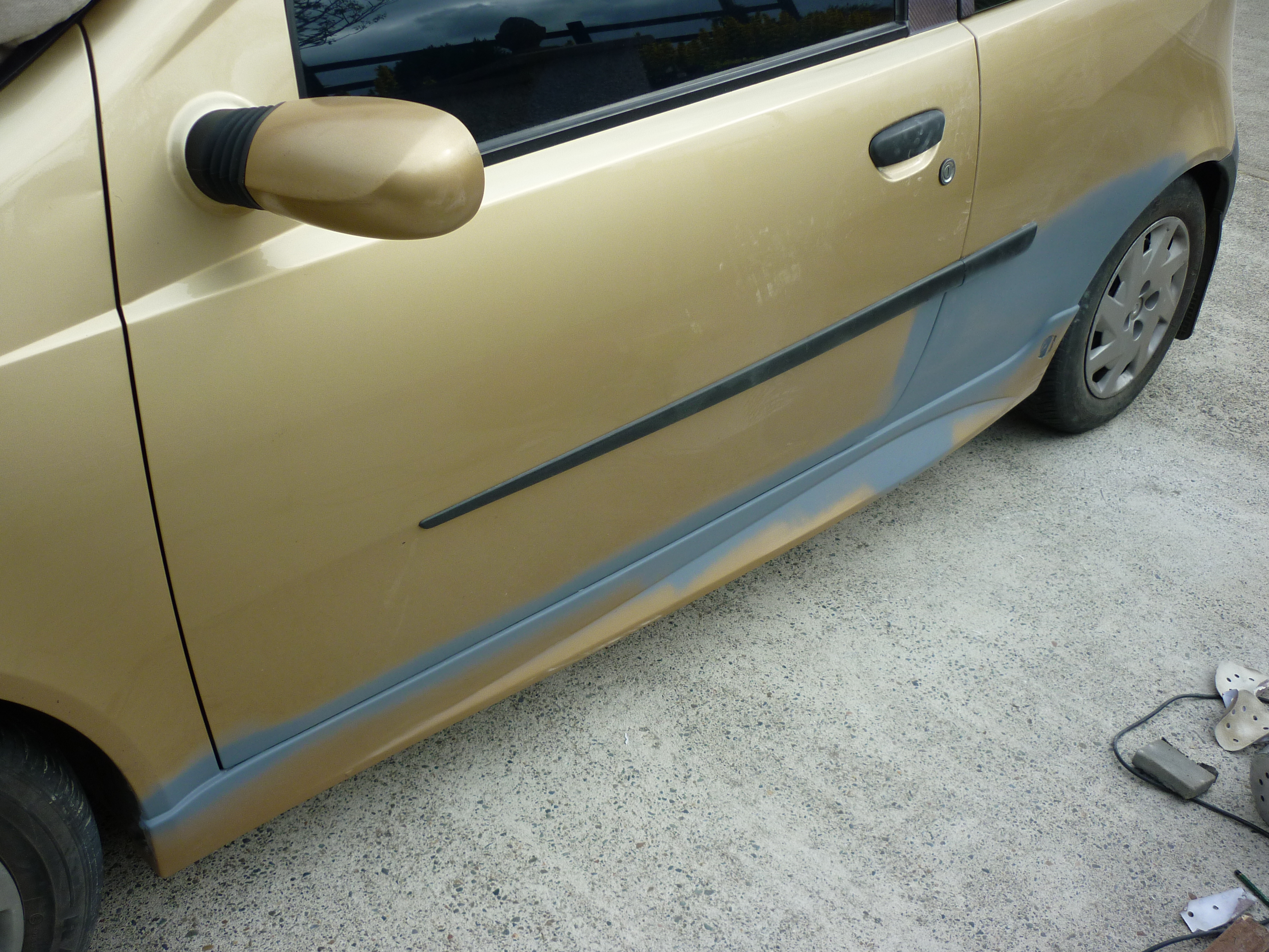

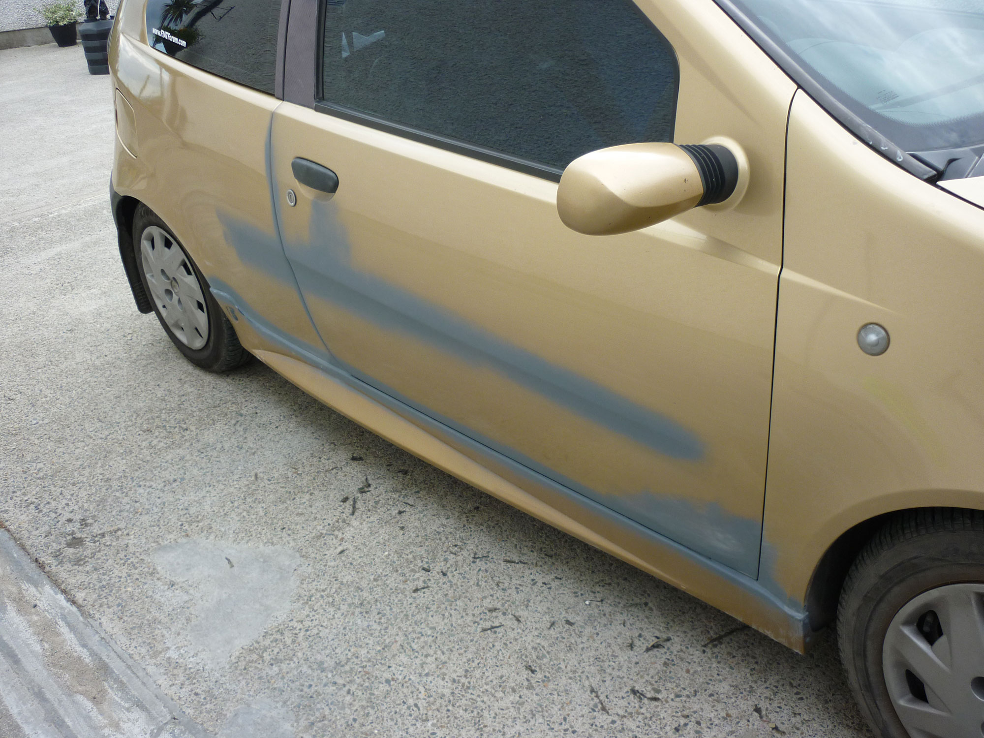

Cant take off door strips, paint is all bad under them. took off driver side and there was 4 patches that had gone back to original primer.
i had the same problem, i just pulled mine off to fast and took half the paint with them, but resently i just had them sprayed the same colour as the car and in my opion they look better than just taking them off, and it only cost me 20 quid , seen as you sprayed your own side skirts maby you should try doing that, i think youll be pritty happy with the results

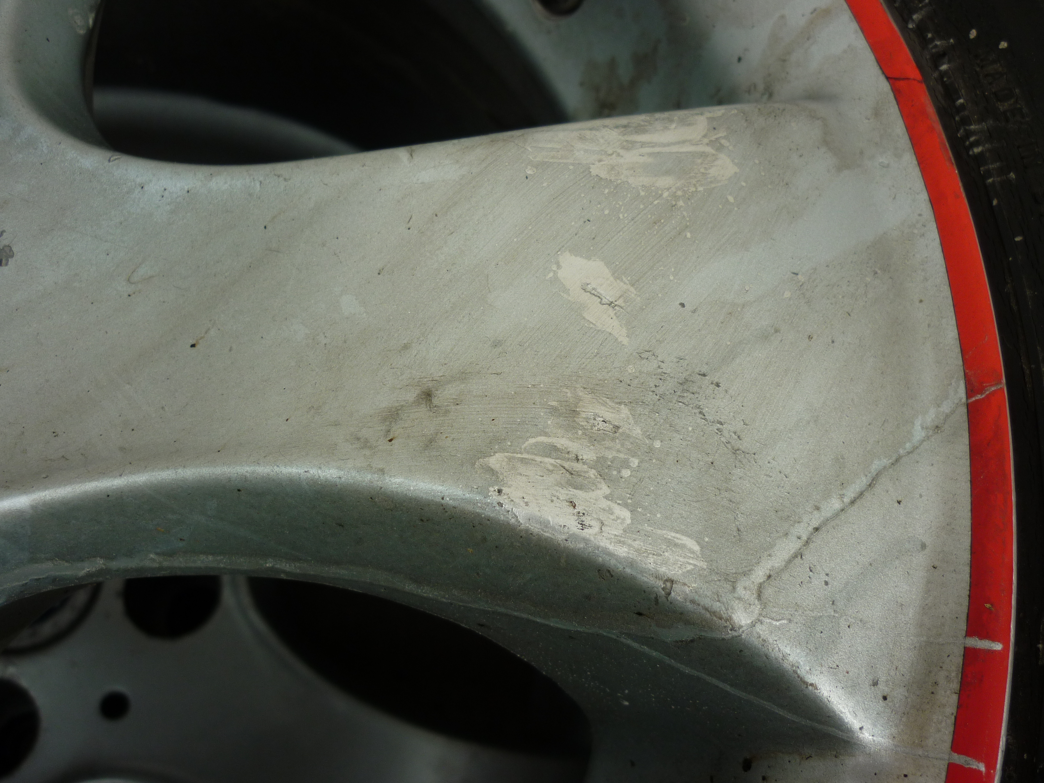

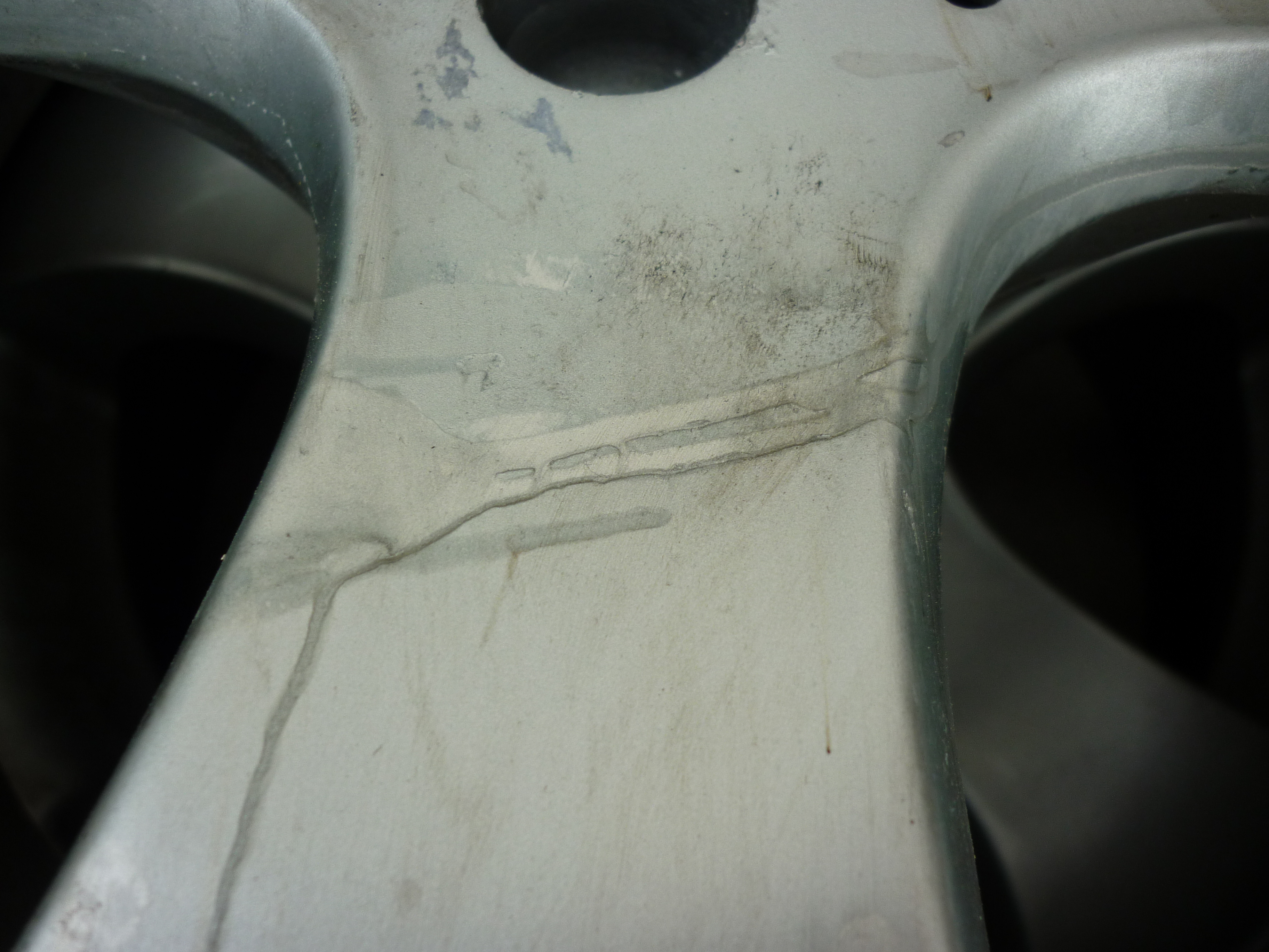

Petrol & Cellouse lacquer do not mix. If you have refurbed alloys using rattle cans do not get petrol anywhere near them,
Happened to me yesterday while trying to brim the tank, was edging it up to the nearest € and a tiny bit dribbled out, ran down body and dripped onto wheel. Put nozzle back into pump and clean off petrol using blue roll,body work was fine, but clear coat on wheels seemed to just dissolve instantly.
Had planned to redo the alloys Gun Metal Grey with Gold lip in the coming weeks, so wasnt overly annoyed about it.
As I needed to get the gold paint mixed up for the lip, decided to redo a part the I previously had done quickly with a rattle can.
Also decided to smooth in the sideskirts, havent decide if ill take bumpstrips off yet...

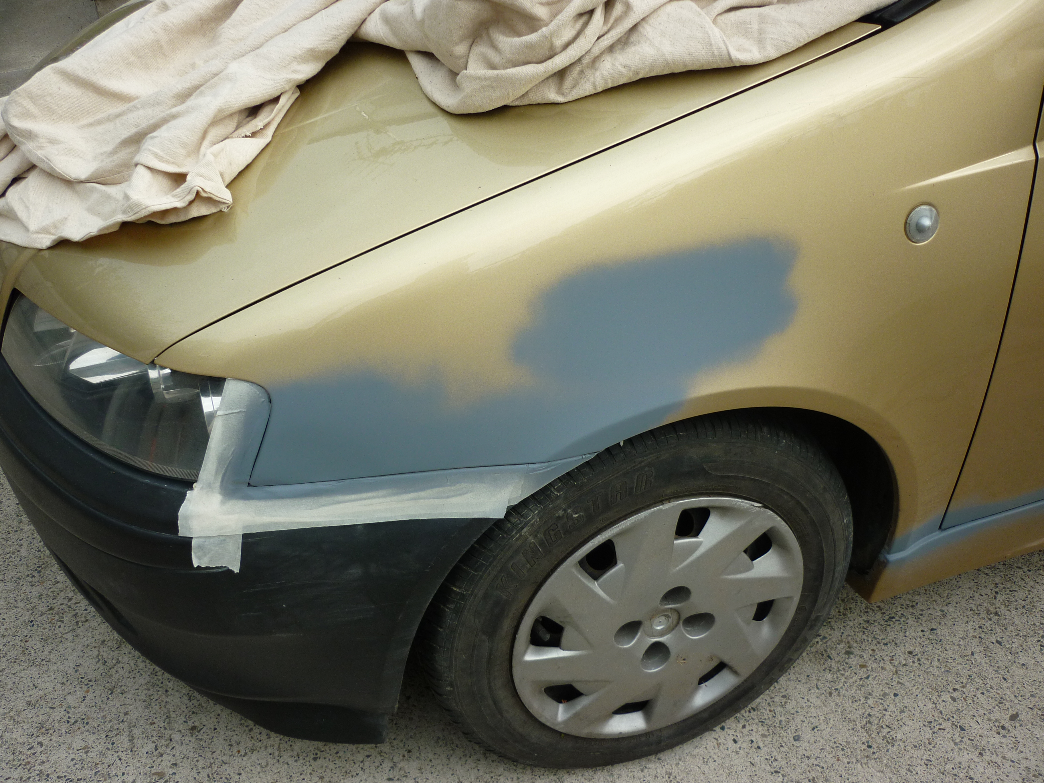

Also had a bit of rust on bottom corner of drivers door that needed sorting..
You can see the patchy repair here...

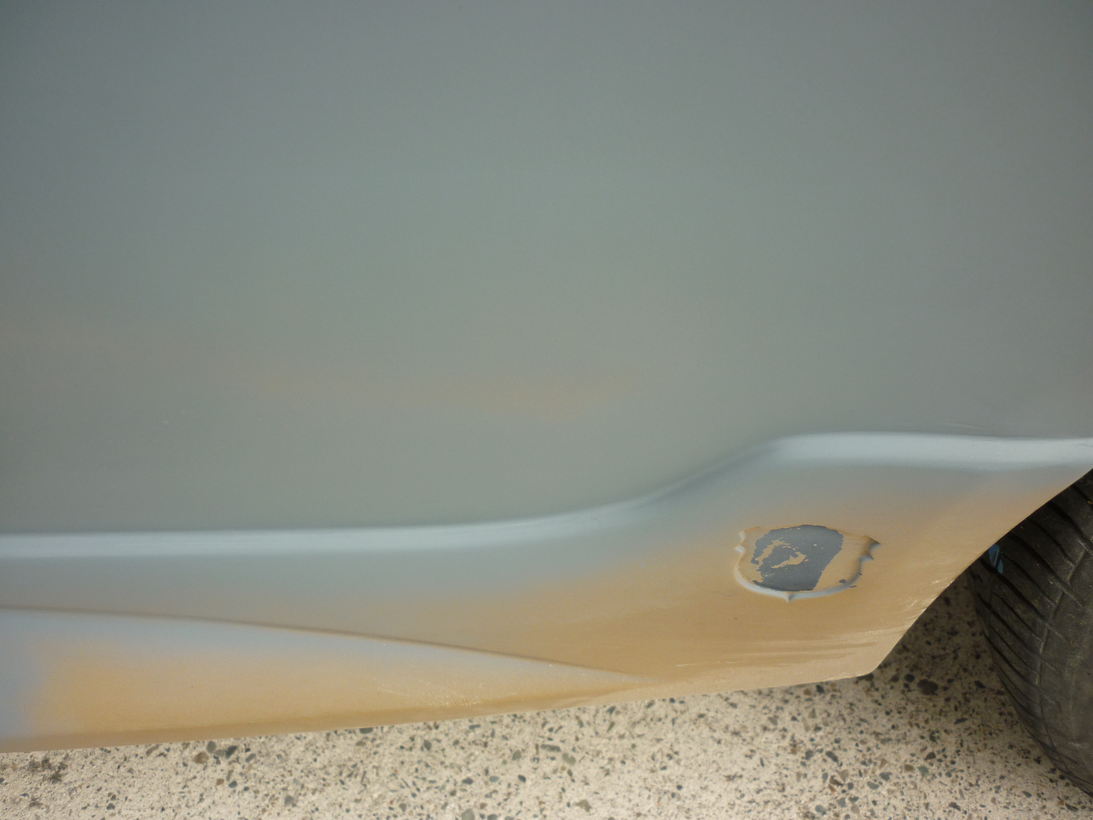

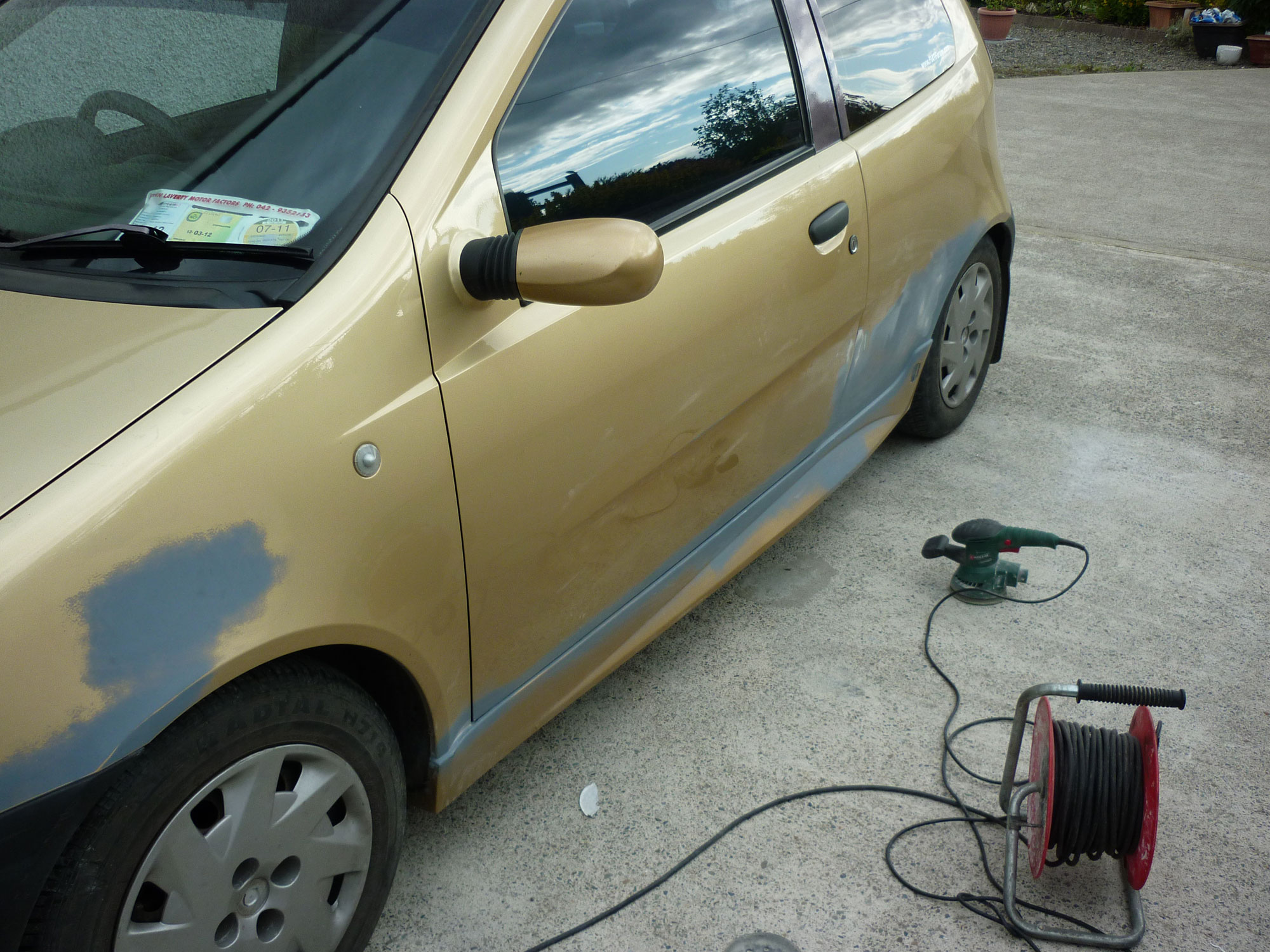

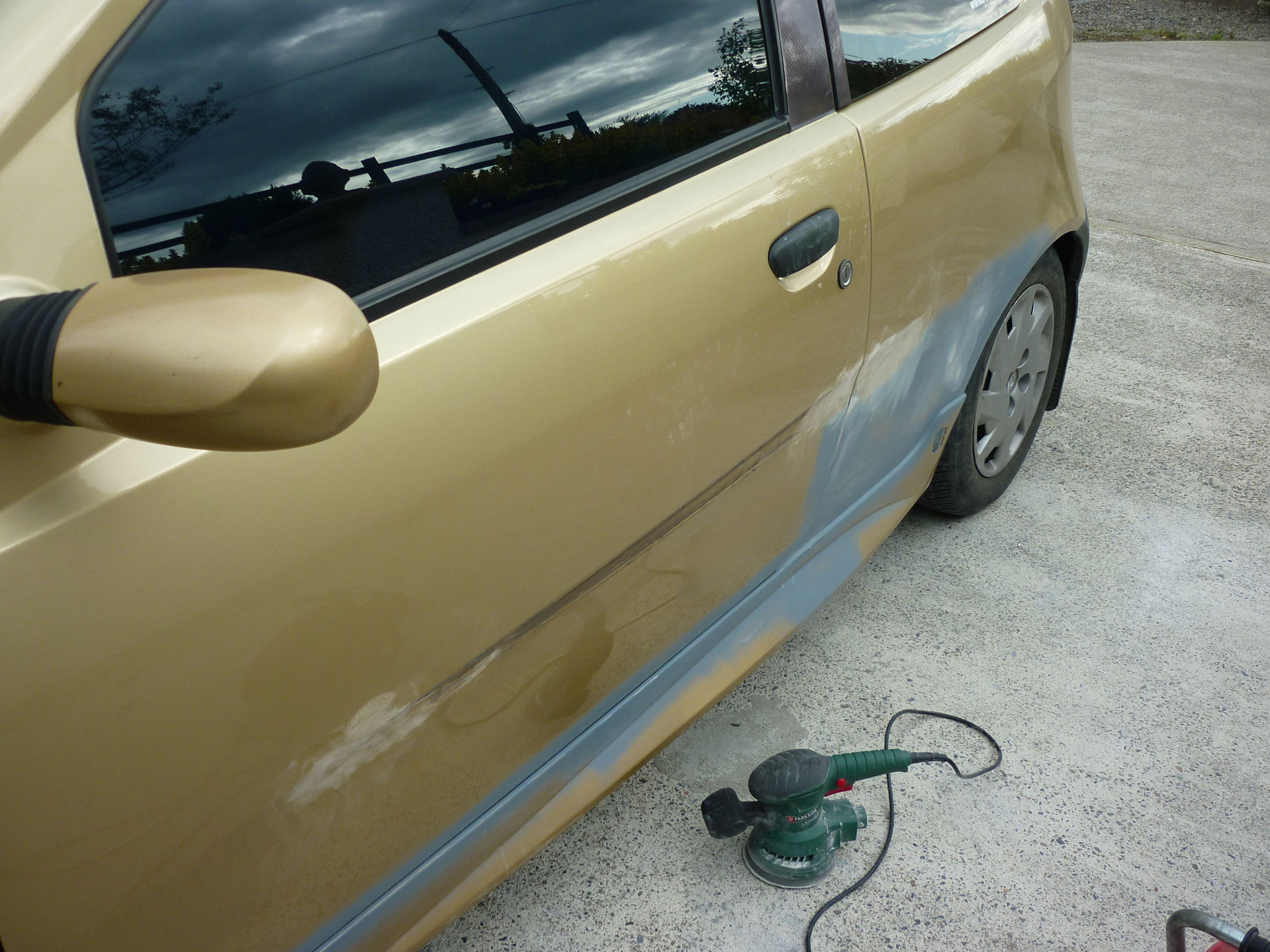

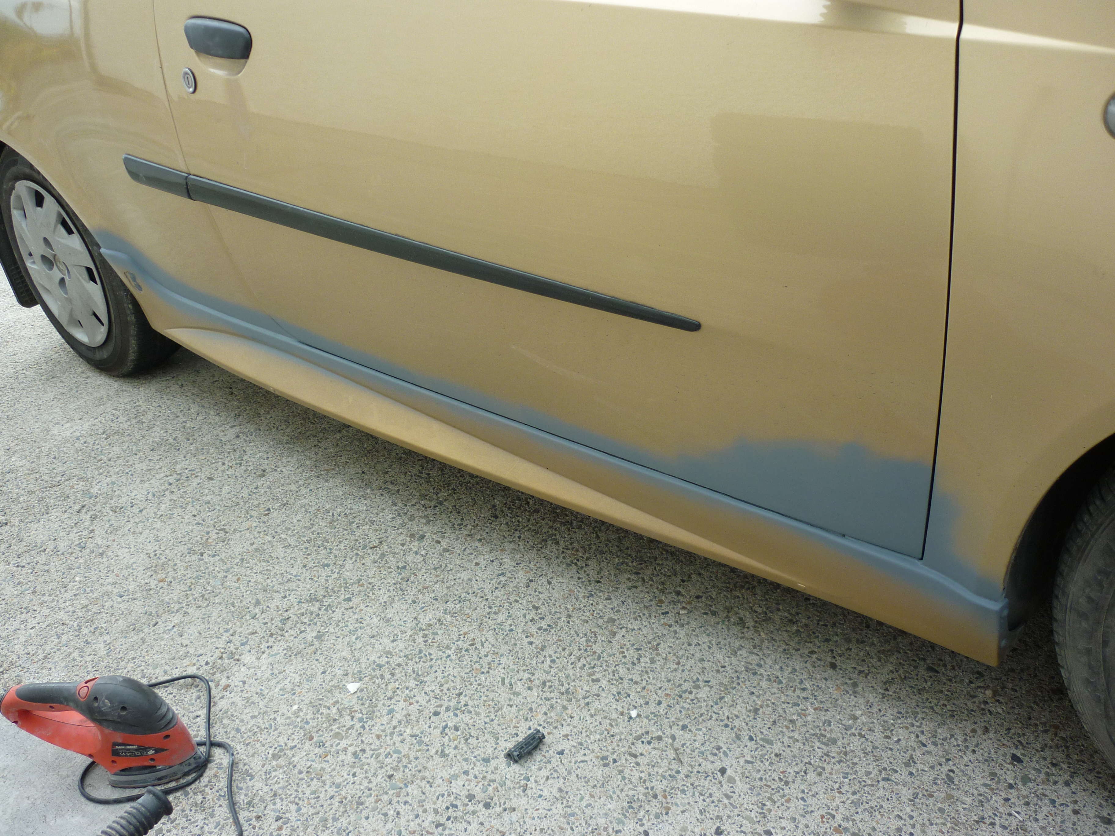

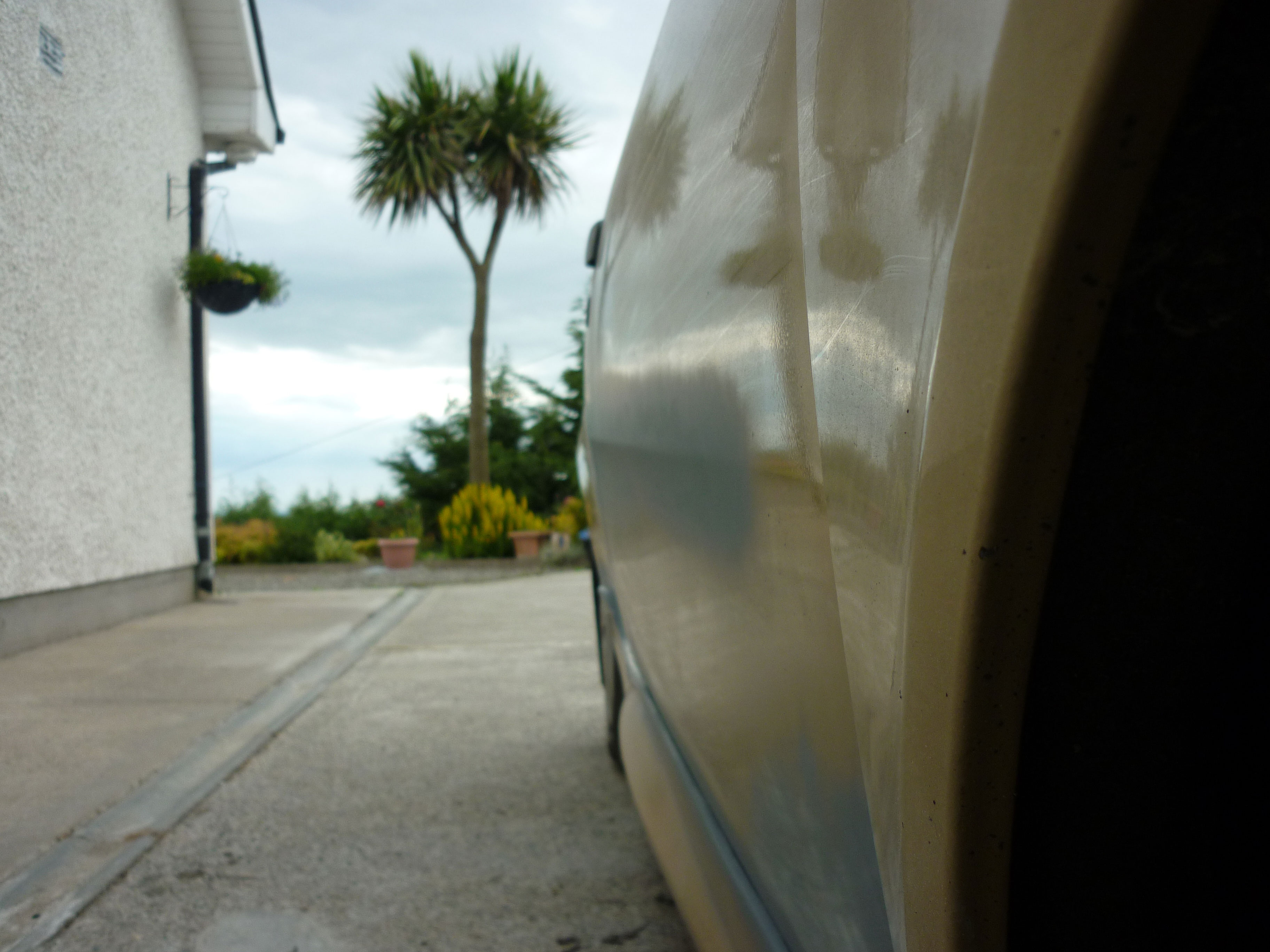

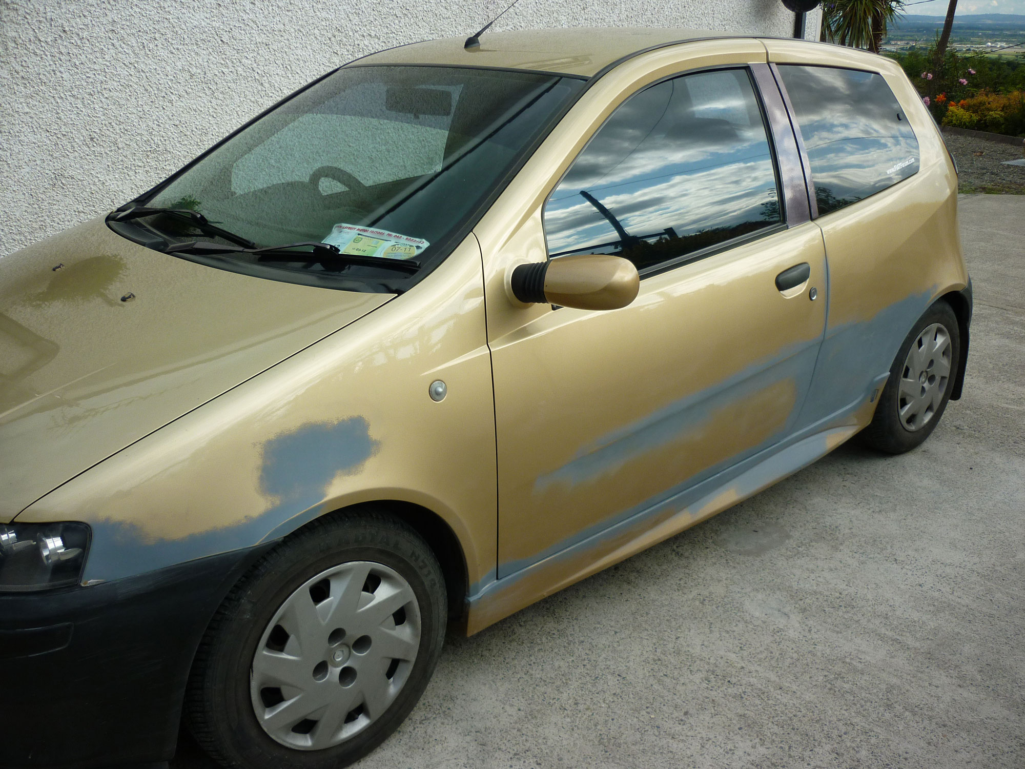

Took off the door bumpstrips, all parts where paint was damaged now smoothed off...
Rubbed down and quick prime. Have a few low spots on drivers door, there was a few chips so gonna fill them. Also had alot of chipped paint on the edge of drivers door, quick sanding & primer sorted that...
Got the paint today, so a few more spots to sort out and a clean out of garage, should be ready for spraying...
