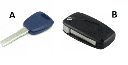

on the bright side a spare key to start the car is easy and cheap to clone if you already have a working key. Timpson's or pretty much any auto locksmith can do this. Clone can be from a standard or remote key. But the new clone key will not be remote.
looking back at some old threads and there quite a lot of misleading information
Plus we have more knowledge than when the Panda was First released
As long as you have a working key
the function of A is easy and cheap
the remote function of B is difficult and expensive.
Yes it is as I expected. I have retired the B key and am using the other and will continue to do so even when the car is put into use. The panda is more of a hobby or project for me - it sits in reserve until needed. I still have much to do; it was and is in very good condition but there is staining on the roof lining and I am hoping it isn't cigarette stain - it looks like blood.
