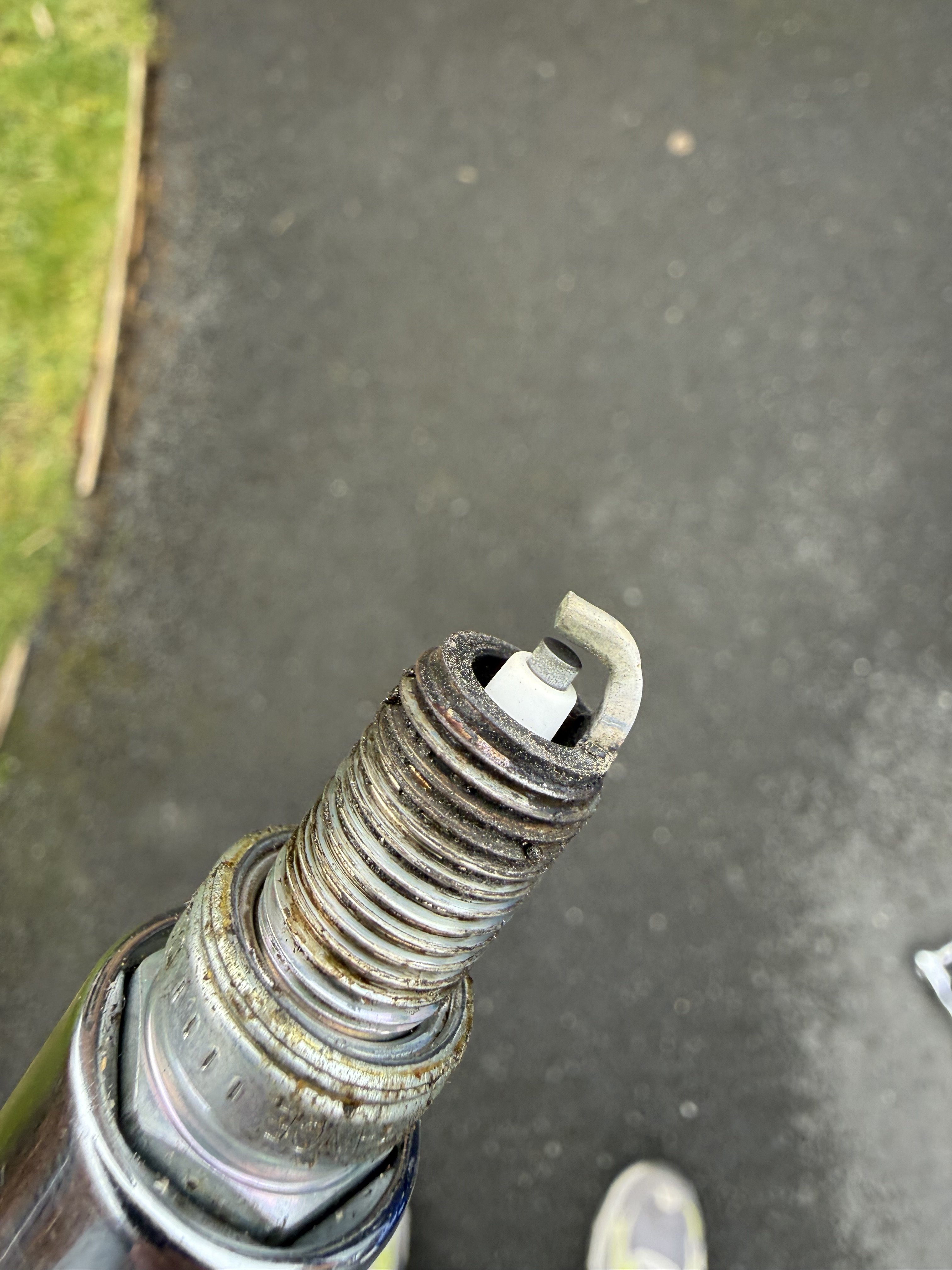

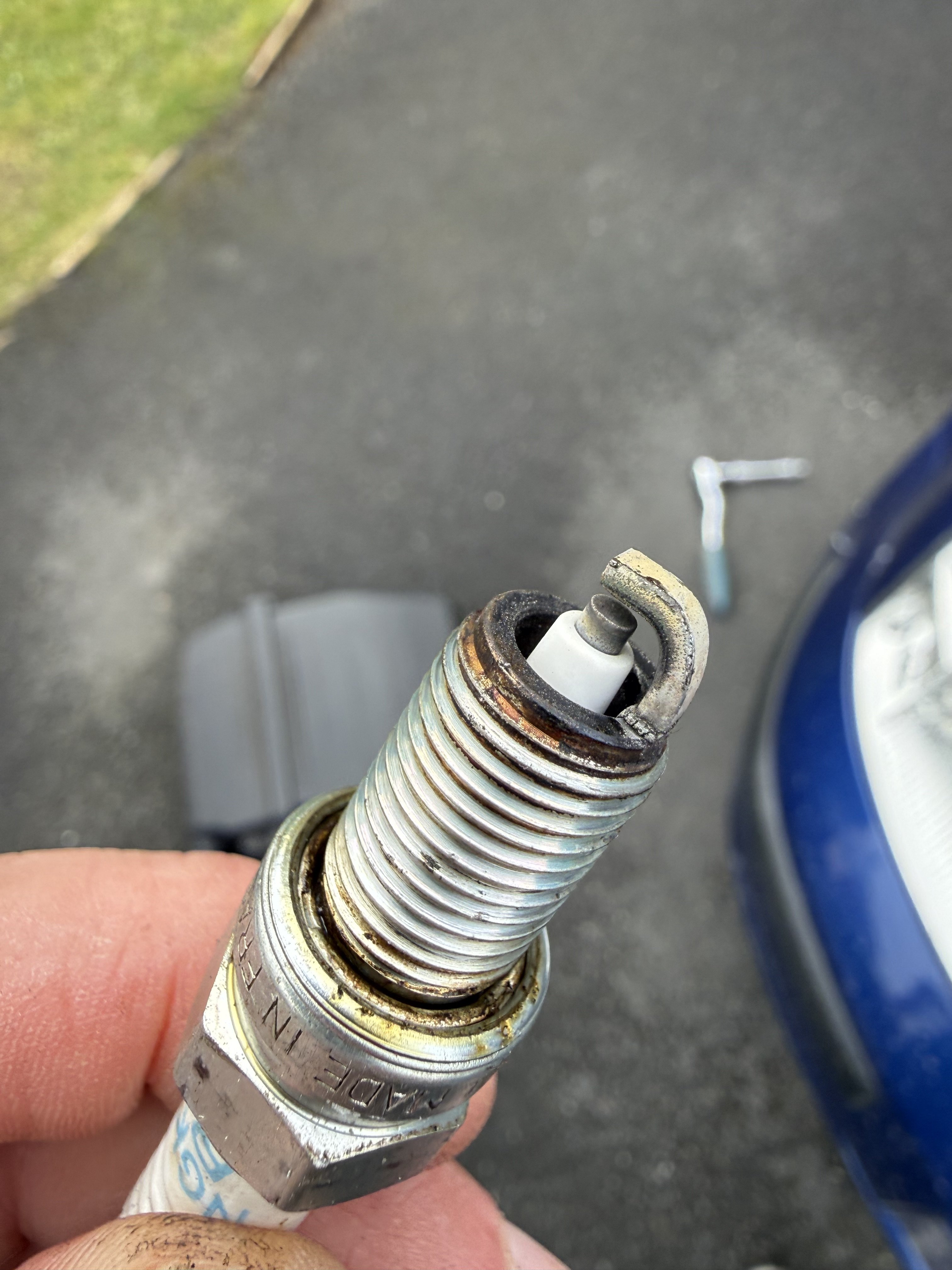

What's the gap measure,.how many miles have they been in
Last photo the plug is burning a little more oil but not worrying so
They don't look a million miles out, but the long term fuel trims.were in the negative and the plugs are to the lean side, I guess something is reporting wrong to the ECU

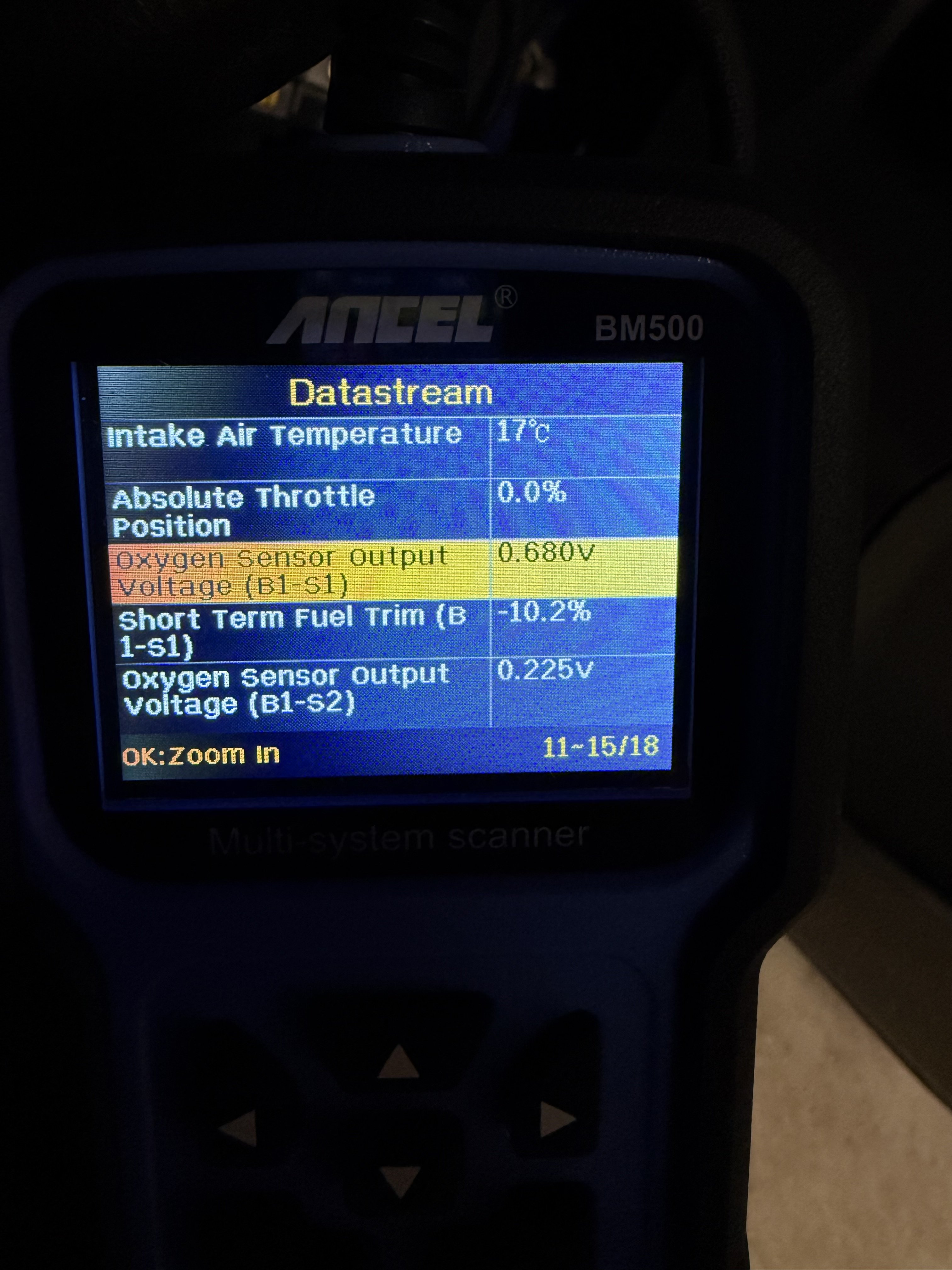

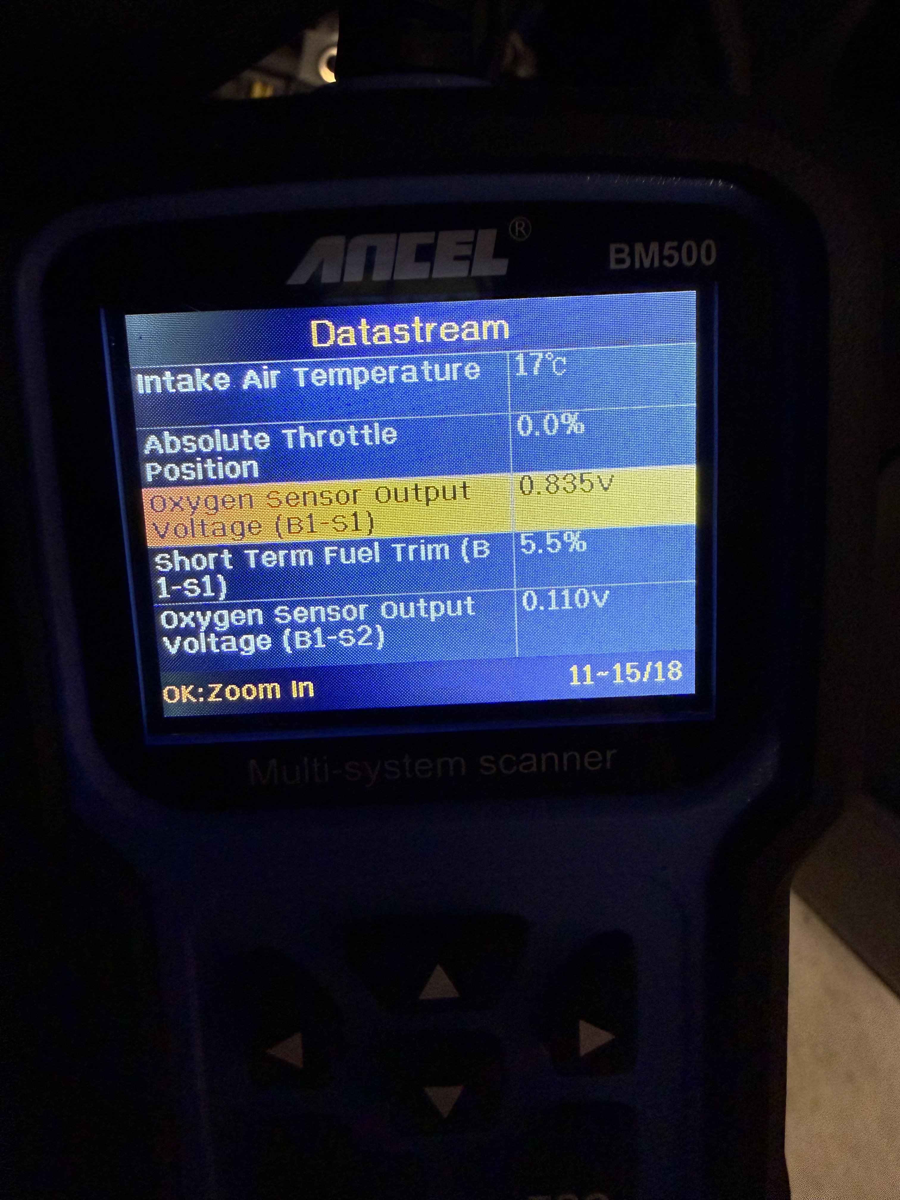

Plot both the O2 sensors hot engine
At idle
At 2k rpm
At 3k rpm
Don't need to record for too long, just enough for the plots to stabilise
