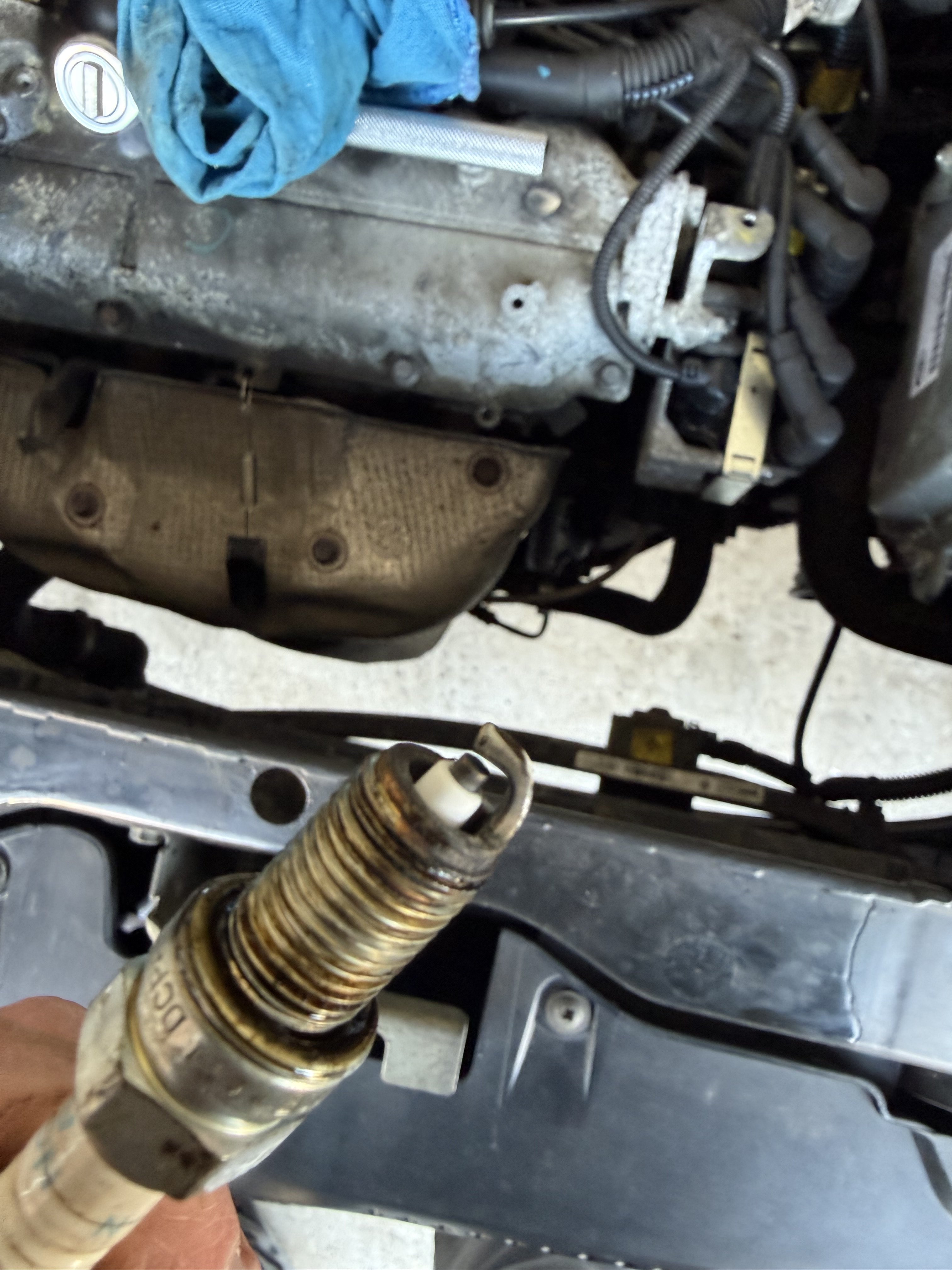

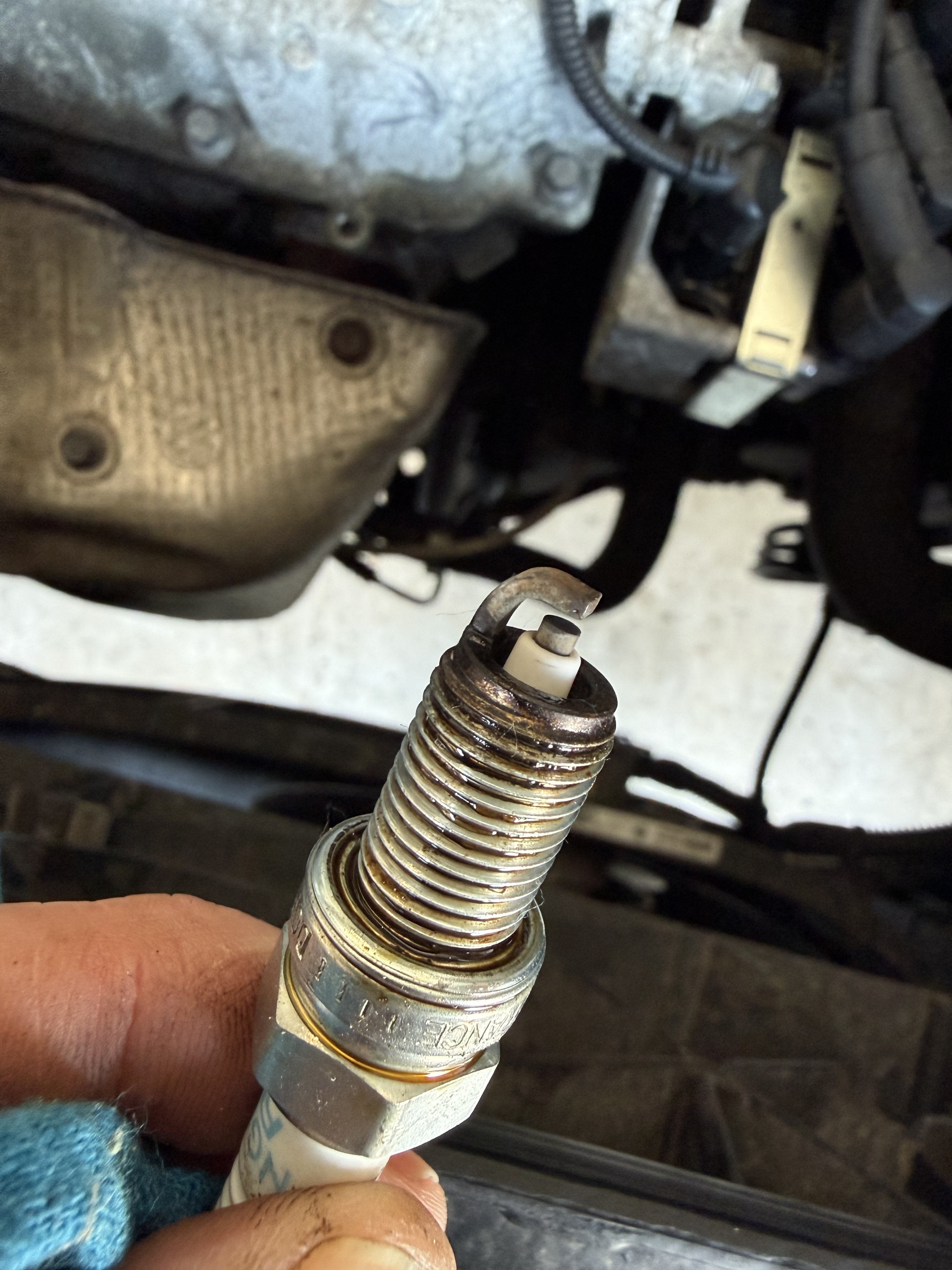

What do the plugs look like
Photo would help
Back to it.

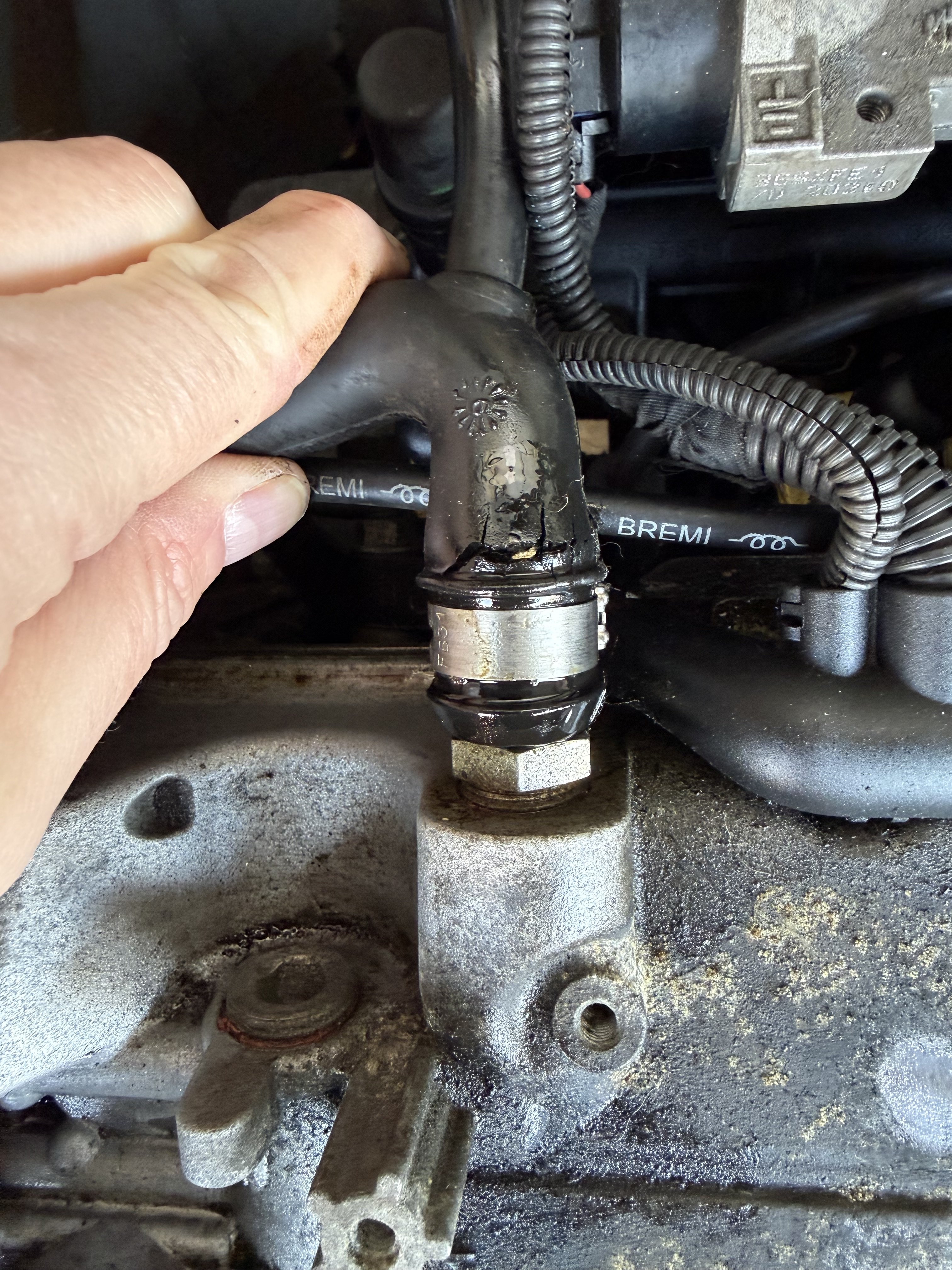

Plugs 1 & 4 ( I was scuffing knuckles trying to get the HT leads off 2 & 3).
There is a bit of oil in the recesses where the plugs go, might be something to do with the perished crank breather pipe, rotated to show the bottom of it. Deffo needs a replacement.
