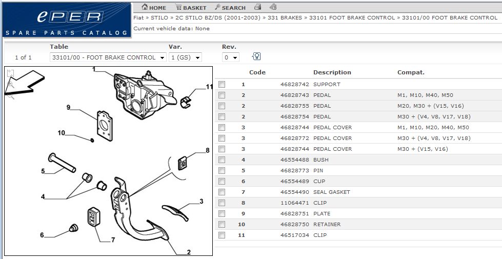

I had the same problem when I was playing with mine, couldn't get the plastic parts out past the master cylinder rod.
The 2 options I thought of were to remove the pedal which involved taking out the long bolt but the accelerator pedal potentiometer housing was in the way. OR As you suggest, think of a way to hold the rod into the master cylinder a bit. Possibly releasing the slave cylinder bleed screw/pipe would help by relieving some of the pressure required to hold the rod in.
I was trying to get some extra travel on the rod because it was crunching when engaging first gear. I jammed a spacer between the rod and plastic to test my theory, didn't work so took out the spacer and didn't proceed any further. Just waiting to see how long it lasts before I need a new gearbox or first gear synchro.
Dave.
Mine is is the same (long bolt through clutch and brake pedal) but are you sure you'd need to remove accelerator - as in do you really need to remove the pedal completely :chin:
I've already removed the black plastic cage although can't get it past the rod of master cylinder. I think the white ball socket (which I'm certain is broken because I've seen bits of it on the carpet) could be removed if I could think of some way to keep the master cylinder rod locked down.
Bleed off the fluid maybe :chin:
