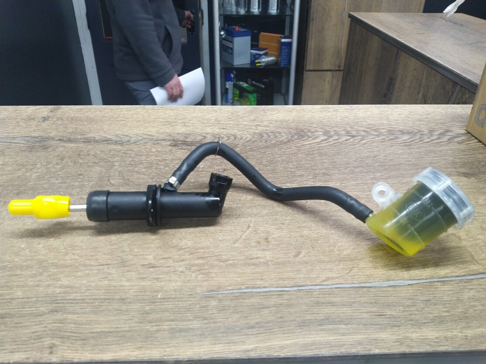

Hi, I have ordered a new clutch master cylinder which I intend to fit to my 2007 Panda 169 1.1. The slave cylinder was done a few years back with a sealed system so no bleed nipple. The master cylinder I have ordered seems to have the reservoir with it already filled so I am assuming that it is also sealed and there will be no need to bleed anything? If I do need to bleed the system any thoughts as to how I do that with no bleed nipple?
Also, is there an easy way to get better access to the master cylinder ball joint tucked up behind the clutch pedal? Can barely see it with a mirror let alone get to it. Bad back and neck don't help I guess. Does removing any trim help?
Many thanks

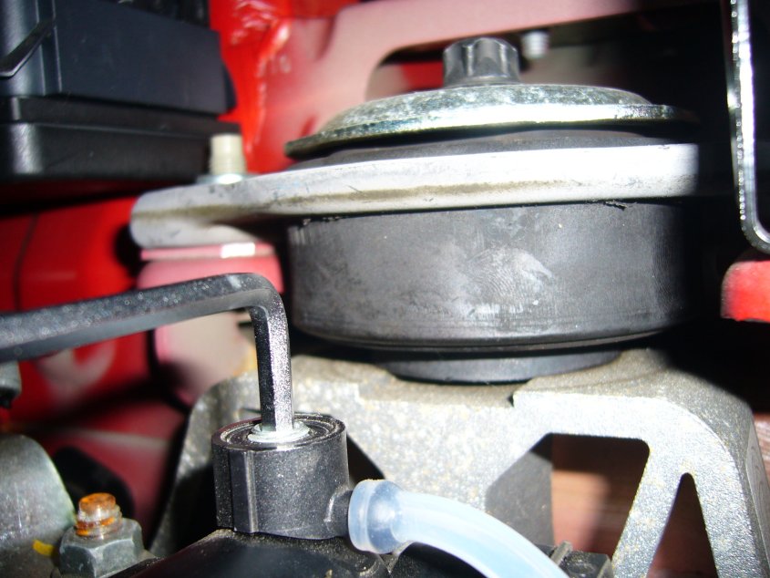

Every slave cylinder will have a means of bleeding it. On my OEM slave, the bleed screw and nipple are separate; you need an allen key to open the bleed, and the nipple is covered by a protective cap (which just pulls off).
Photo below. The bleed screw is at the top; the nipple on the side, behind its protective cover.
bleed-screw-nipple-cover-jpg.96879
That photo was taken with the battery in situ, without dismantling anything. There's just enough access to be able to get a drain tube onto the nipple and an allen key onto the screw, but you have to work blind. Nothing has been dismantled in the photo below.
bleed-key-tubing-in-position-jpg.96878
Just attach the other end of that tubing to a vacuum bleeder and turn the allen key. Take care to keep the reservoir filled; it doesn't hold much fluid.

Thanks for the reassurance. This is what I have coming.
So to be clear, I am not going to be able to keep the system sealed if I connect the existing pipe into the connector shown on that master cylinder? It has to be done on the chassis leg? And the slave cylinder looks to be like the one posted by Koalar which has a bleed screw but no nipple to connect a pipe to. If I have to bleed the system then I guess I'm going to have to rely upon gravity only?

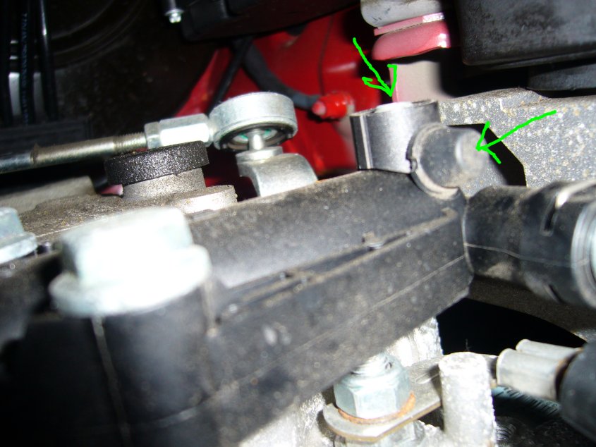

If you look closely at Koalar's photo, you'll see there is a nipple in the same place as the one in my photo, again covered by a removable cap. Just pull off the cap and attach a suitable piece of tubing. The bleed screw and the nipple are separate on these cylinders.
Be aware that if you use any of the pressure methods of bleeding, including pumping the pedal, more fluid will likely spray out from around the bleedscrew than will go down the tubing.
It's important to make sure there's no air in the circuit, or the clutch won't disengage fully, leading to rapid wear of both the clutch and the gearbox. Don't be too intimidated, though - getting a decent bleed is straightforward, even if not making a mess isn't.
If you don't want to take out the battery and its tray, take a photo and work by feeling what you see.

In this case you will need to bleed the slave cylinder as its pipe is not connected to the master culinder. It just pushes in to the master cylinder and is secured by pressing the spring clip down. The metal fitting on the end of the pipe should not be removed its permanent and has the o ring to seal it. Use a very small screw driver to side under the wire clip and gently lever it up. The slave cylinder pipe will pull out with a little side to side twisting. I would recommend not replacing the slave cylinder pipe(s) unless they are leaking due to the awkward location of the half-way join under the chassis leg. The new slave clinder had a nice long pipe attached, This is mow hanging on the garage wall. The end of the pipe that pushes into the master cylinder has a tiny O ring on it. I decided to take the O ring off the new long slave cylinder pipe and fit it to the old pipe fitting at the master cylinder end. and put it onto the old pipe, dropping it and loosing it in one go. Fortunately I have a big box of the things and had a spare but take care if you do this. The pushrod was removed by my daughter and flipped off easily with a screw driver. Putting it back was laughably easy. Remove the cap from the reservoir before fitting the master cylinder. I broke the new reservoir doing this after fitting as I couldnt get purchase on it, so again be careful. The new cap was TIGHT. Bleeding only required three or 4 presses of the pedal but gravity will do the trick if its left open for a few minutes.
