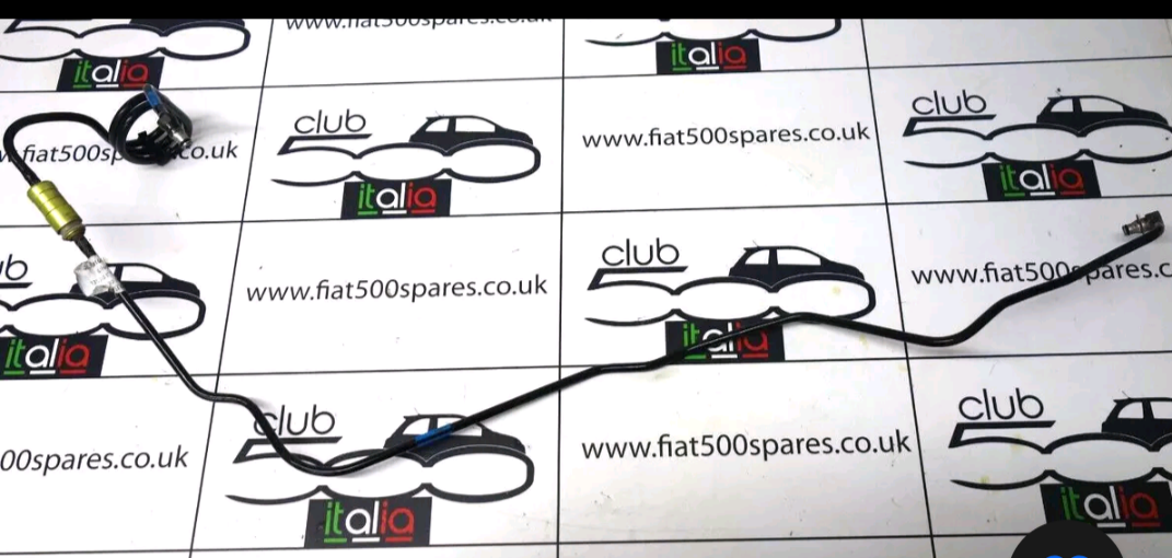

Edit eBay item 235595565748 looks suitable. But you will need the slave side of the QD coupler.
Thanks for the eBay link, that's actually for a petrol one, the pipework is different on the diesels. No local scrapyards with diesels in sadly! I used one of the online scrap services but that expired last week with no replies.

Diesel and petrol Pandas in RHD all use the same clutch hydraulics. I have a Ford Ka master made from cast metal on my diesel it works just fine. The slave is the original. The pipes are untouched but I expect the QD connector will eventually leak D/T corrosion.
Diesels have the fluid reservoir on a longer tube, but the master is the same as the others.
There are repair kits on eBay for the QD connector. Get one with backing sleeves that support the plastic pipe ends.
This type will do the job. It has compression olives and backing sleeves and its stainless. Ideally use anti seize paste on the threads to prevent the galling but it should not need to be silly tight.
