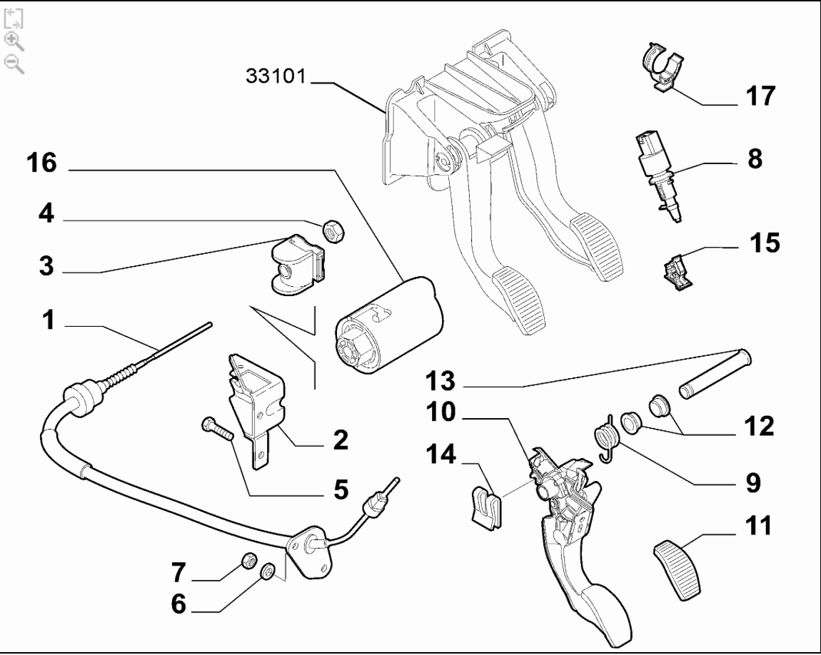

Actually it took also the part indicated as 3 in the image below, as it was damaged:

Does anyone know how the plastic part 16 works? I used it to fine tune the clutch but I don't fully understand it's function/operation.

I don't know about on Fiat but some vehicles in the past had that arrangement which was a form of self adjuster mechanism with a spring inside the plastic barrel.

I imagine it is something like that, but I can't find any info on this.

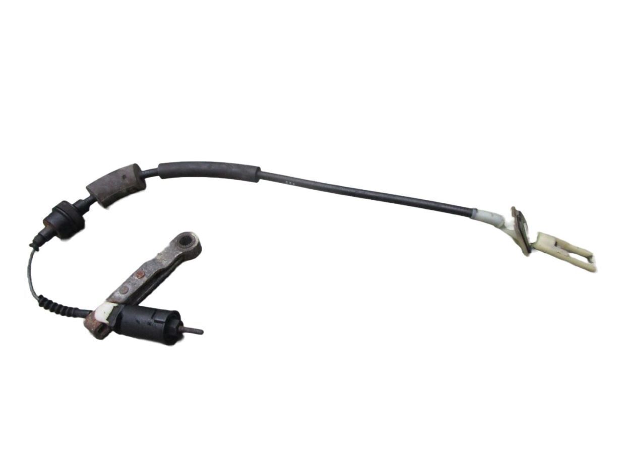

Image from eBay:
Should it have a metal nut in the end, after the plastic "Thing"?

Don't know about the metal nut, but from old memory on BL Rovers if you did a clutch job you often had to fiddle around with the cable and plastic barrel bit, to reset it so the pedal/clutch operation worked correctly and the plastic mechanism was prone to failure.
