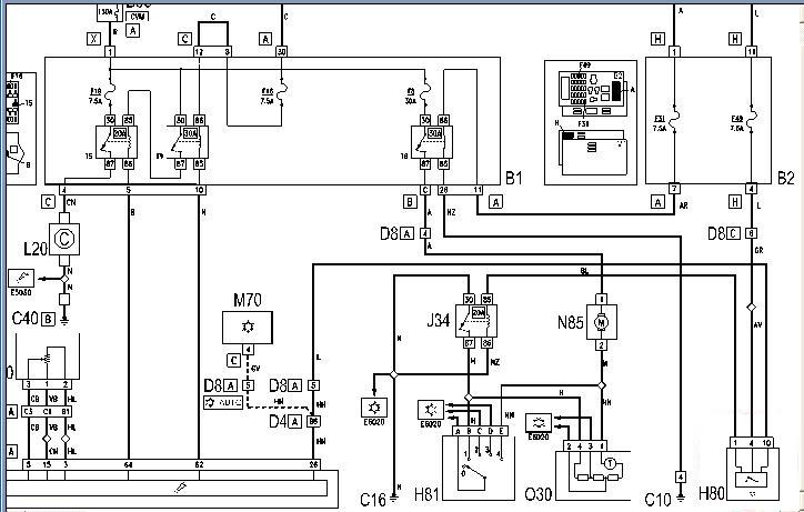

With manual aircon there is a bank of 3 resistors -shown here as O30- which provide the 3 speeds and speed 4 -the fastest- is straight through with no resistance.
The fan speed is controlled completely differently with climate control than it is with manual air con. All reference to resistor banks you have to forget when talking of climate control systems as they aren't relevant to you
With climate control the fan N85 has an integral electronic speed control unit controlled by a signal voltage supplied by the climate control ecu M70 from pin 11 to the fan pin 2 . A feedback voltage is supplied from the fan pin 1 back to the cc ecu at pin 8

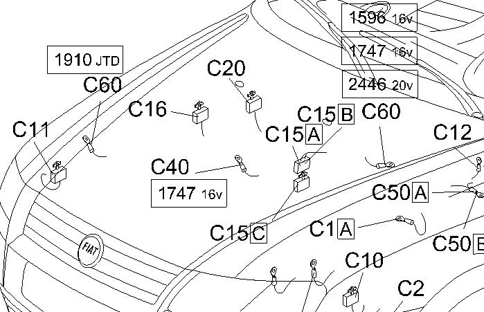

But the basic supply and earth is the same. Supply comes in on red wire to fan on pin 4 and earth (black wire) is from fan pin 3 to earth point C16 That would be a first point of investigation -especially as you say it tends to go wrong in wet conditions. A loss of earth here woud mean the fan wouldn't have a circuit
C16 could be here but bear in mind it may be the mirror image as this is a lh drive picture
So, back to basics, if you can get to the fan connector, I'd check for 12v power on the red wire and a good earth on the black wire. Clean up the earth point C16
If there is a basic 12v power supply problem to the fan then I'd check this area, Fuse 8 and relay T8 in the engine bay

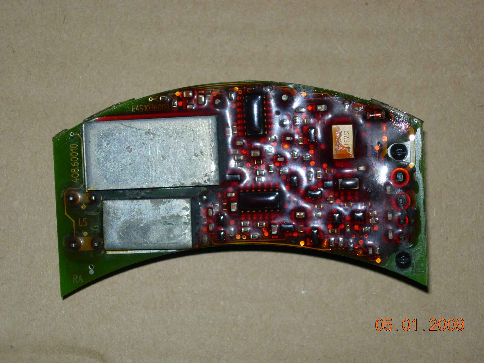

If it is a problem with the power control circuit board in the fan then look for problem areas on the circuit board - darkened areas or poor solder joints and you may be able to repair it. It gets wet in there with the air con and circuit boards and wetness don't go together well

Can't see anything untoward on the pcb so many thanks Mr Deckchair for these circuit diags and tips. Will have a look see next weekend.

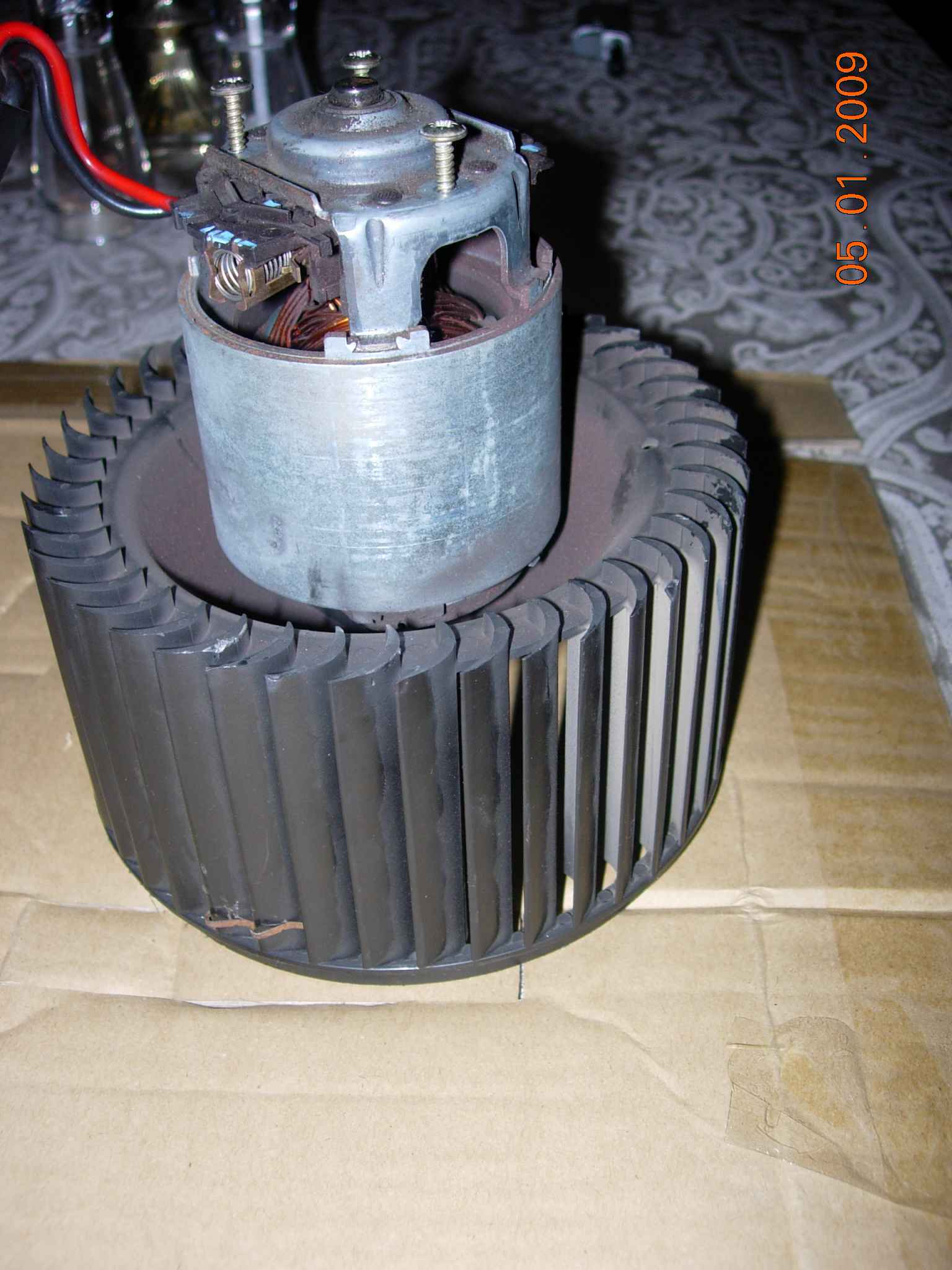

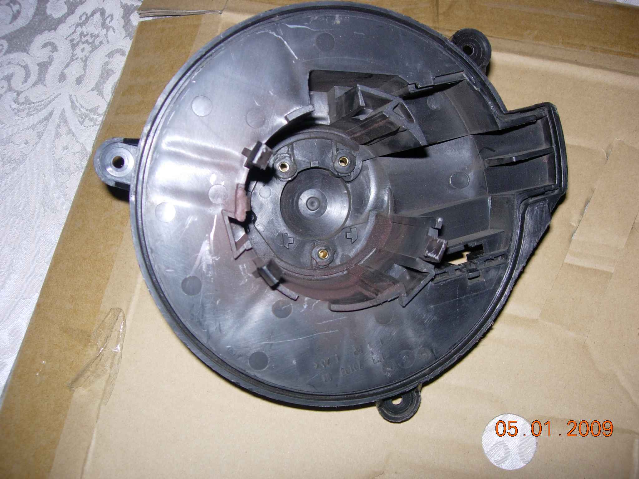

Pics as promised above. As you can see the fan does come apart but I have broken a couple of the 'legs' that hold it together, three left so should be ok. Mayber there is a less destructive way, but I clearly don't know it.

The fan motor in my Stilo Abarth Selespeed (Nov 93) stopped working suddenly, although it did come on a couple of times by itself! To get it out I had to strip out the brake controls, accelerator pedal and steering gear, great fun. The motor was in a pretty dirty state and contained some leaves and signs of dried condensation/damp etc.
To separate the motor parts I found it possible to lift the fan on one side by gently levering up the fan, at the bottom between the top cover and the fan after removing the three screws, with a large bladed screwdriver. This action released two of the internal retaining legs.
I wedged between the fan and the cover with a thin strip of wood to retain the gap made and released the remaining two legs with a medium flat bladed screwdriver through the bottom of the fan blades. No damage, but mind the pcb!
The pcb is pretty dirty, covered with carbon and traces of copper from the brushes and commutator as well as general dust. Could have shorted out something or just increased resistance.
Now I have to release the commutator housing lugs to clean the comm, and then restake them, generally clean up before reassembling and testing out etc. Brushes seem ok, about one third worn over nearly six years and 36000 miles.
