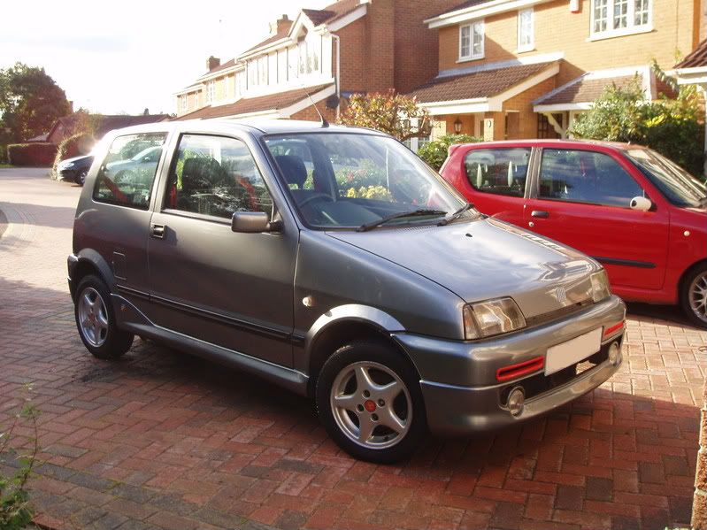

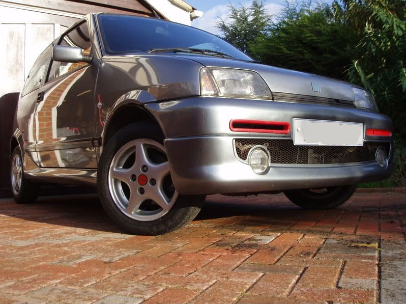

Cinquecento Cinq Abarth Project 1.4 16v
Its been a while since Team Lloyd did any projects, so yesterday we travelled miles to pick up this little gem!
Over the winter we hope to transform this cinq into possibly the first 1.4 16v with 6 speed gearbox, not sure if anyone has done it yet, altho have heard people thinking about it!
We now have the car and a brand new 1.4 16v engine and gearbox awaiting to be joined as one!

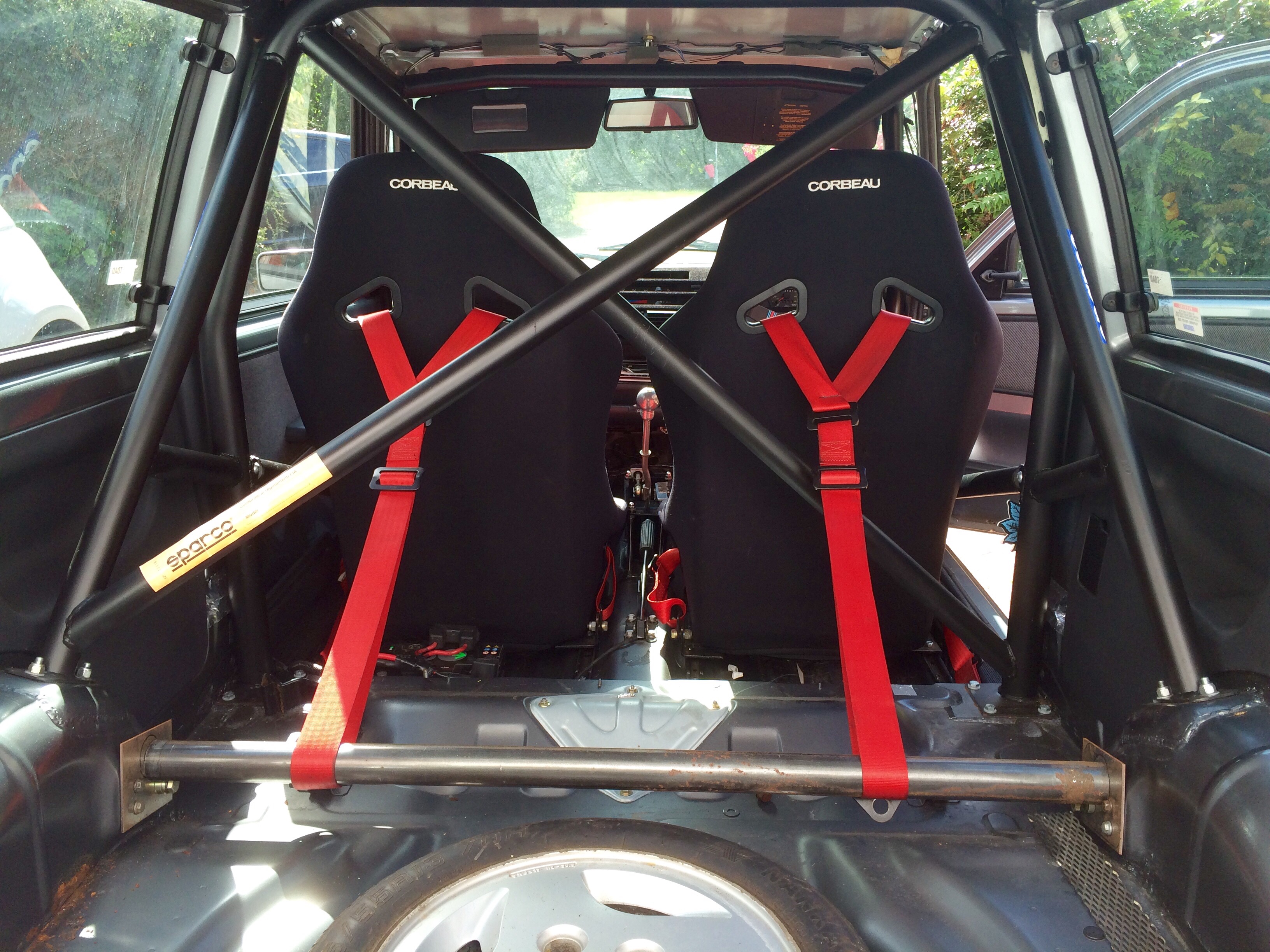

It has been a while, but we stuck some wheels on this car a few days ago, rolled it out of hibernation jet washed the years of detritus off it, and gave it a once over.
All in still looks all sound, turned over first click of the key, just needs some fuel stuck back in it to get it running again.
So we got to work cutting the rear brace bar that the harnesses will attach to. Need to check if we have any gas yet to weld the bar in place to the bolt on plates we made for it that attach to the original rear seat belt anchor points on the rear arches.
If I remember I'll take some pics of it as it stands and get them up.

Just read through this whole thread and have got to say that build is awesome with some high quality mods. One thing though, why go to all of the bother of moving the gear stick inside, cutting and welding bits and the such, instead of just extending the arms on the box a slight amount? I know this is a common modification we do on the 205 rally cars around here.
Is it not possible on these boxes? I've noticed a weight on one of the gearbox arms (not sure what this is for) but would assume it can be removed and an extension bolted in place?
Again amazing build, thoroughly impressed with the attention to detail.
By moving the gear change mechanism inside the car it moves the gearstick much closer to the steering wheel. It reduces the time your hand is off the steering wheel and we don't have the luxury of say a Satchshift like Peugeot 106 owners do http://www.satchellengineering.co.uk/106-saxo-satchshift.html to just bolt in, so modified what we had.
If you look at any race or rally cars which don't have paddle shifts they gearstick is very close to the steering wheel. Even cars with shifts as good from standard as the Honda Civic EP3 Type-R have off the shelf extension & quick shifts http://www.tegiwaimports.com/select...egiwa-360-degree-shifter-extension-honda.html
The type of change you mention is very common in RS Megane's 225/230/F1 etc but modifying the pivot point on a gearbox end fitting. It makes it very good.
