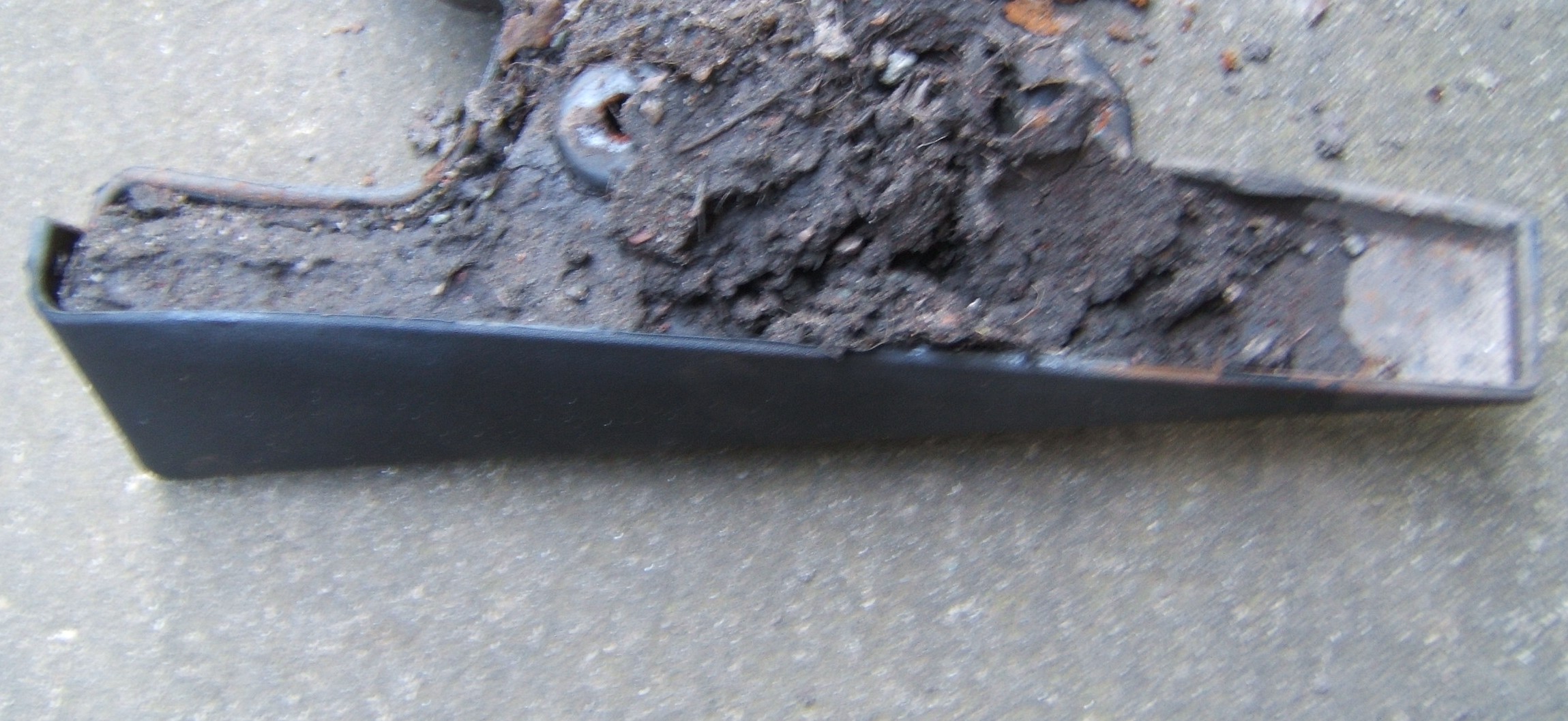

Hello all.
It might be a good idea to check the two rear splash guards under your Bravo's.
Mine where full of mud holding moisture directly up against the sills.
Also check the fronts where the wheel arch liner goes under the car covering the sills this also get full of mud.
Great work Adrian. Ideally a fiat wants an underbody powerhose after every winter. Worth taking off some of these plastics aswell for cleaning.
The passenger side is very easy, 3x 8mm bolts, no need to jack the car up.
The drivers side is bit more difficult. 2x 8mm and 3x 14mm bolts. And another bolt I dont know the size off, Car needs to be lifted a bit. You might get away with taking the two 8mm out and just bending the plastic down gently.
Or you could just not be a berk and not have to be told to do this, you don't need to jack the car to have em off, can do mine without it and it's lowered 40mil
