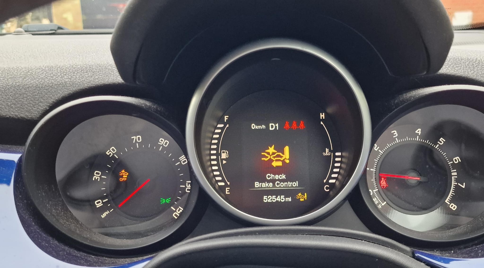

Hi,
Did you get it sorted? My 500x has a similar problem and it needs an MOT now so I must sort it because I dont think they will pass it with this big orange light on! When the large light goes out there is still a small one on the left saying the forward colision system is off
Mine has The following read out
Hardware number: MRR1_0 - Ver: 00
Software number: 1037601851 - Ver: 0603
Errors found:
C1417-78 - Horizontal misalignment sensor - Alignment or adjustment incorrect
C1409-97 - Radar blinded/obstructed/blocked - Component or system operation obstructed or blocked
C141F-96 - Control unit faulty (Microprocessor) - Component internal failure

Just a quick update on this.
Playing with the iCarsoft thing seemed to succeed in turning it off. However, after about 20 miles it came back on.
