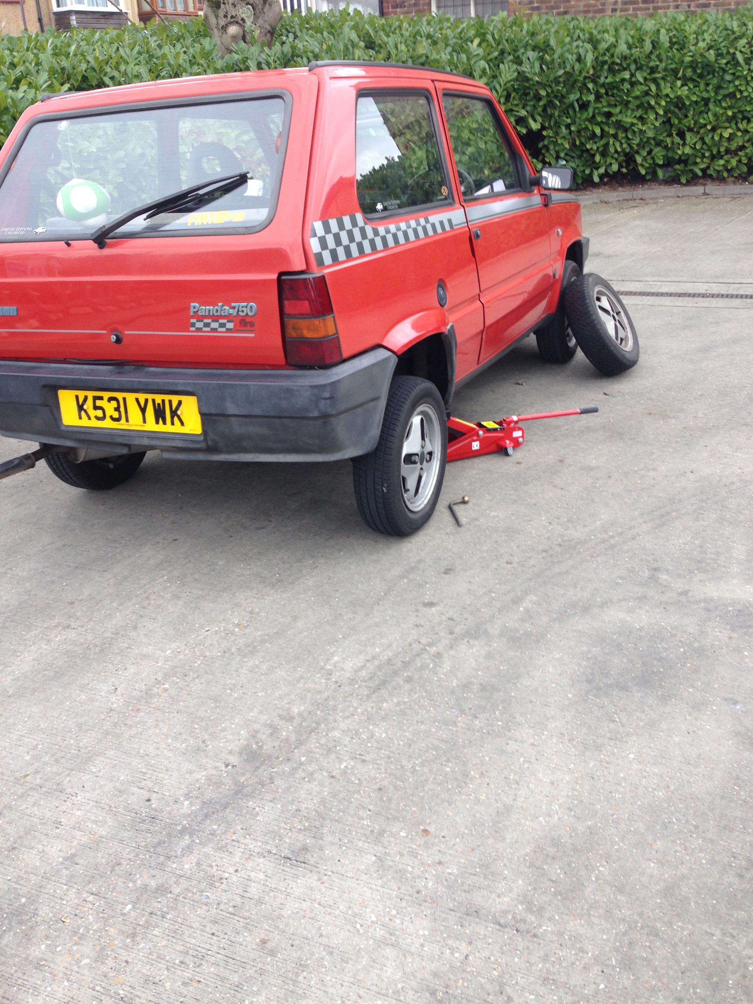

Tyre problems as always, I have 4 month old front tyres, barely a month old rear nearside tyre, with my only old tyre being the rear offside and guess what, went to put some air in it and the valve fails :bang: Wee's all the air out in literally seconds, went to put the spare on but its buggered, sidewalls heavily cracked and has no air in it :rolleyes:
Wait an hour for recovery and he fits a new valve, I'm sure this is Char' throwing a strop because I still haven't given her that promised polish (n)

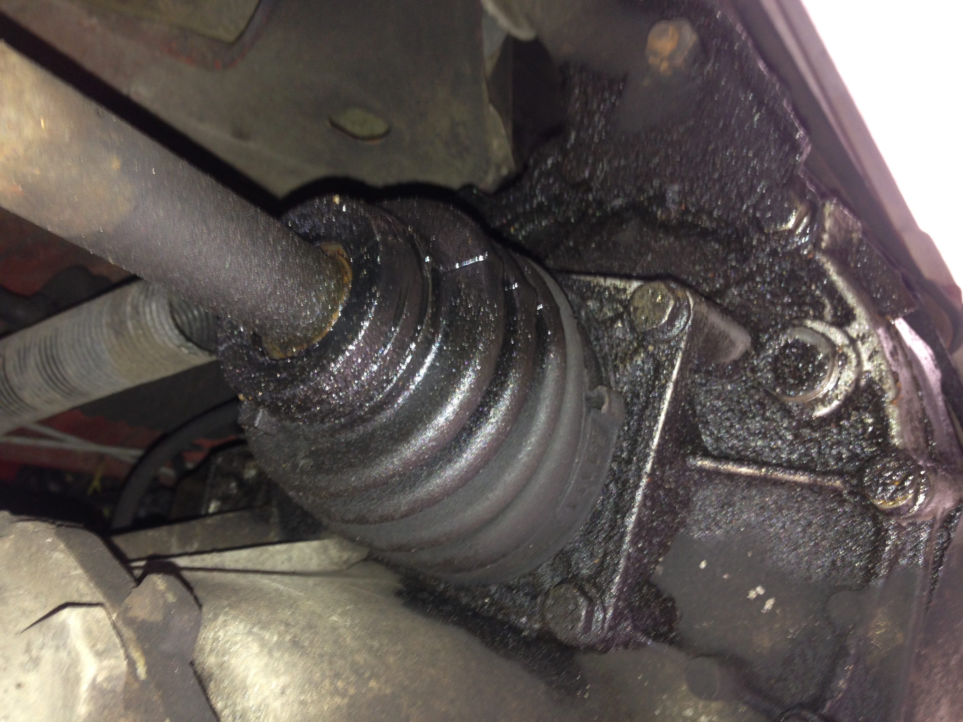

Few days on and I've decided going to do an oil change because why not, I got the oil sitting around, its not raining for a change and all I needed was an oil filter which I got for basically nothing, so I had everything ready, even jack the car up literally about to do it and... hmmm where are my hex keys :bang: Completely no idea, so scrap that idea for now until I either find mine or buy some more :rolleyes:
Getting to the point, noticed this whilst I was under there, the inner CV boot on the nearside is a bit greasy looking and the bottom of the gearbox looks like its a bit oily, although this could be from my prior cam cover gasket leak which is fixed but did previously dribble oil down that side of the engine and onto the gearbox... Thoughts?

Yes, most likely oil seal on the end of the boot but if you've had a leak down there before, first clean it up, check the oil in the 'box and if that's OK leave it to see if it comes back. No point panicking if it is just overspill from last time.

I would re-do the plastic cable tie with a proper steel cv boot band.
Cable ties does not give equal presure around the whole circumference, they might be fine for the outer or any other geased cv joints but defo not on wet shafts.
I'll try and clean it up tomorrow then (y)
Never checked the gearbox oil, always scared I'll undo the wrong plug and dump the whole lot :eek:
