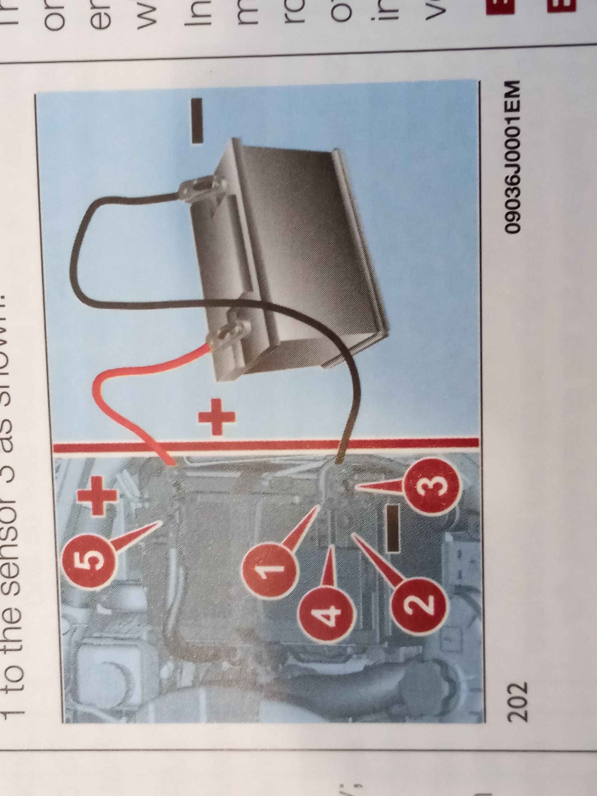

Then I got out the handbook and it has a ridiculously small postage stamp sized photo with numbered pointers and the text says; "To recharge, proceed as follows: Disconnect the connector 1 (pressing button 2) from the sensor (3) monitoring the battery conditions, on the negative pole (-) 4 of the battery..."
So, in my photo, which is the sensor monitoring the battery - is it the one labelled A or B? It would seem that B is the only one of the two that has a button as described in the manual but it can't really be made out in the joke of a photo from the manual?
Any pointers greatly appreciated...

So, recharged without a hitch and the battery is fully charged, BUT the Stop/Start error is still displaying on the dash.
Is this:
a) Something that needs resetting and I can do it?
b) Something a dealership needs to reset?
or c) Something more sinister and I need to take it to the local dealership to be checked out?
Thanks...
I think it takes a while for it to settle down after the battery gets low. I used to switch s/s off for a while after a charge then when it was turned back on it returned to normal. Fiat s/s and their electrical systems have always been a bit quirky?
Thanks... I took it for a slow drive around the block. I was a bit concerned it might cut out on me 'cos it's still got the error displayed. It probably needs a decent run; like you say, to settle down a bit.
