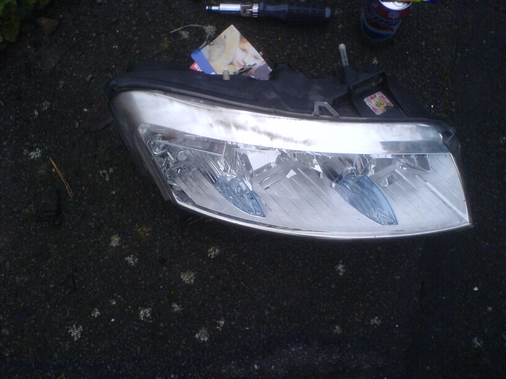

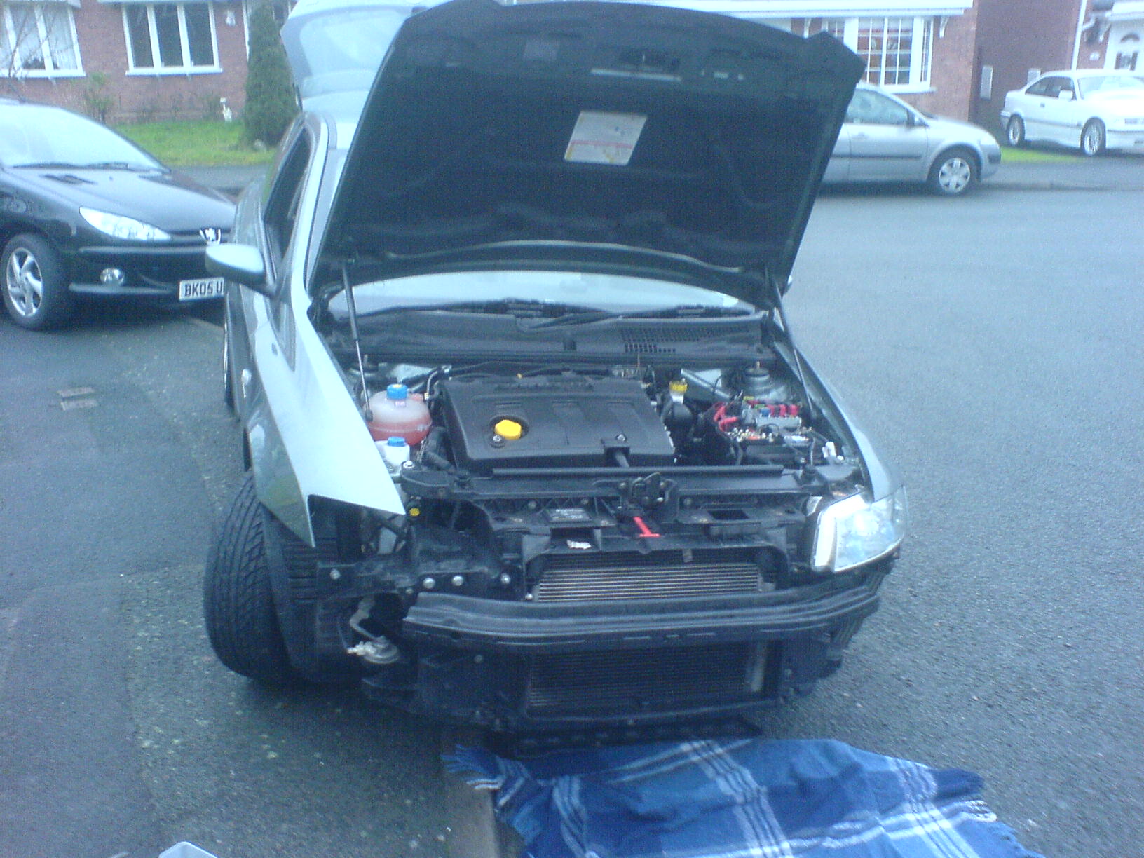

i've read a few posts about changing headlight bulbs, it sounded ok but could take some time to do. so i bought some philips gt150 bulbs and had ago at fitting them.
i removed the battery and pushed the battery case backwards after removing a few nuts and bolts, also undid the the washer bottle and pushed it back. I managed to get into both headlights to change the bulbs by removing the black plastic headlight cover - DO NOT DO THIS - you can't get the cover back on without removing the bumper as the angle to put it on is not there (hard to explain on here without actually seeing it)
so with no headlight covers fitted i look at Ben's gudie :) to removing the bumper as a last resort - bumper removed headlights removed and bulbs replaced, also replaced the fog lightbulbs. i still can't see how you remove the sidelight bulbs even with the headlight in my hand.
after 6hrs of messing around, bulbs are changed and the car is back together, but be warned it's a pain to do!
