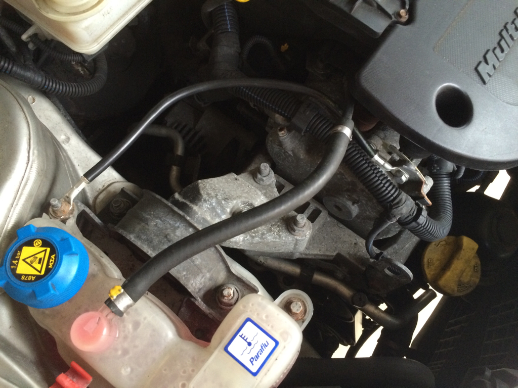

As I live 20miles from civilisation (or a shop where I can get supplies) I've fitted a second engine earth between the cam chain cover and the engine mount, which I may just leave as a fail safe up out of the way of road salt water and grime

Take it the 2nd cable is one of the Halfords premade ones?
I'd like to avoid been near plastic, would the terminal fit on the body side of the engine mount?
Ziggy
The second cable was an off the shelf pre made solenoid cable from the small car parts store in town, it was fitted very quickly in the cold so may at some point go under the washer bottle with suitable washer but I bought a much better cable from the auto-electrical specialists I visited later on in Norwich

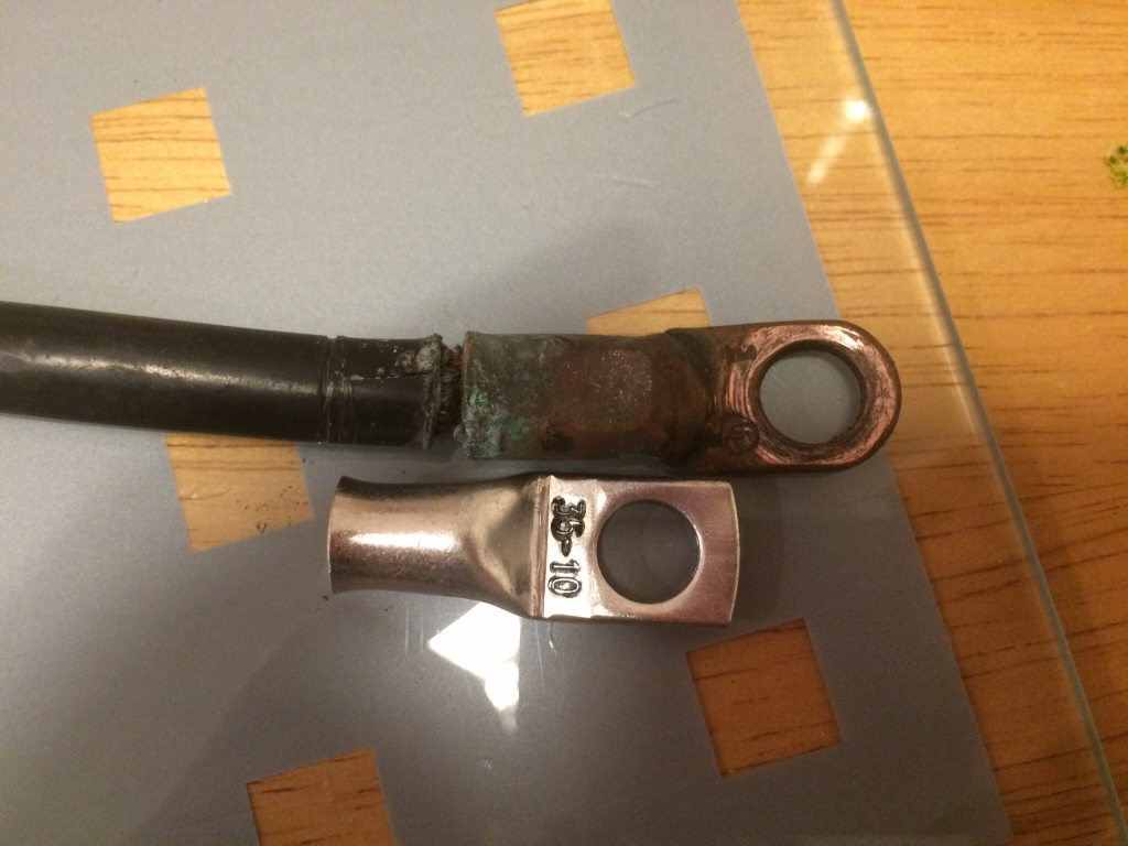

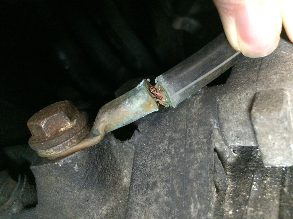

Ok so update since I last posted the cable had completely broken
You can see it's pretty corroded.
Lined up it will lose about half an inch, which will hopefully just be enough to reach somewhere on the gearbox.

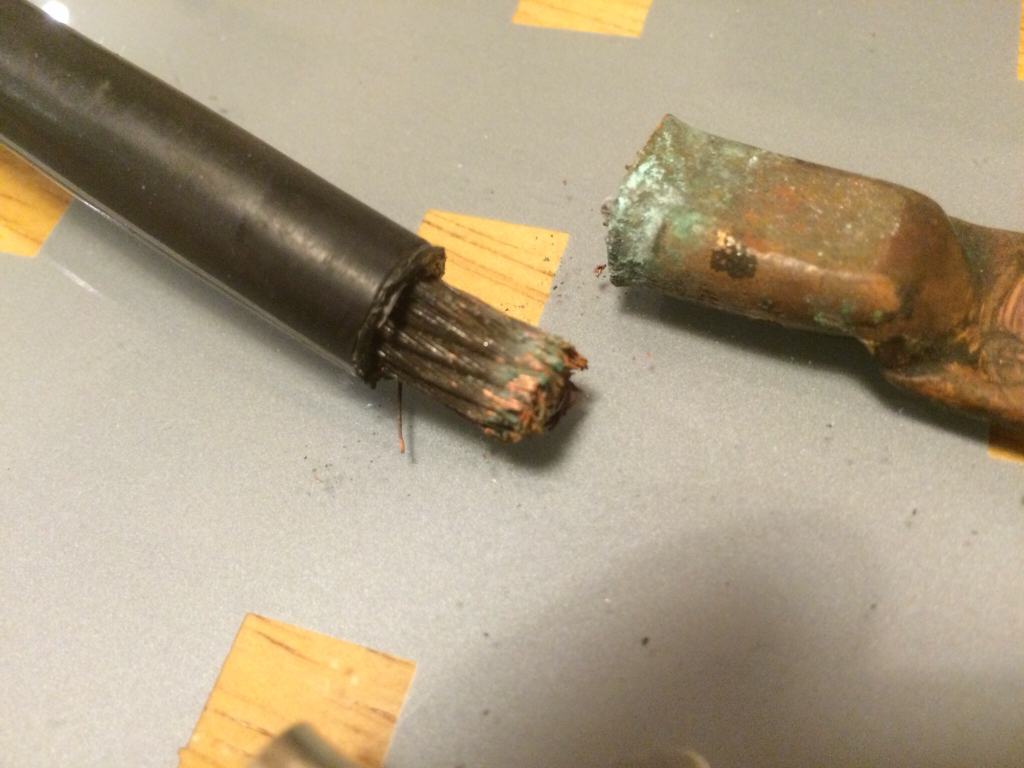

Stripped, the core is corroded quite a way up but I have a very easy/dangerous way to clean this (which I'm not going to explain because I don't want anyone copying me and hurting themself)

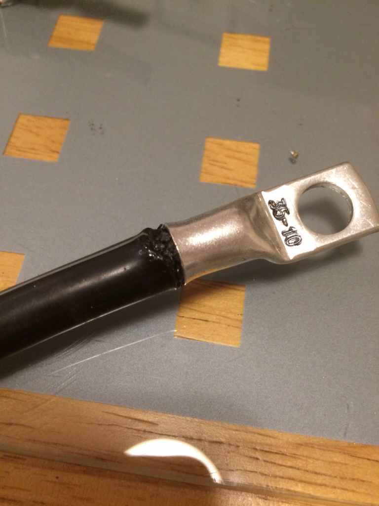

Cleaned up its ready for a new ring connector
A perfect fit, I don't have a crimping tool this size so I nip the end with a pair of grips the punch with a screw driver to clamp the cable

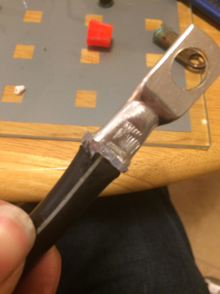

A bead of electrical silicon was placed around the join, then another bead was made further up the insulation and another on the neck of the ring connector
Finally the heat shrink
Hopefully this will do the job without failing again however it remains to be seen if I'll still have the car in another 5 years but at least I shouldn't have to worry about it again
