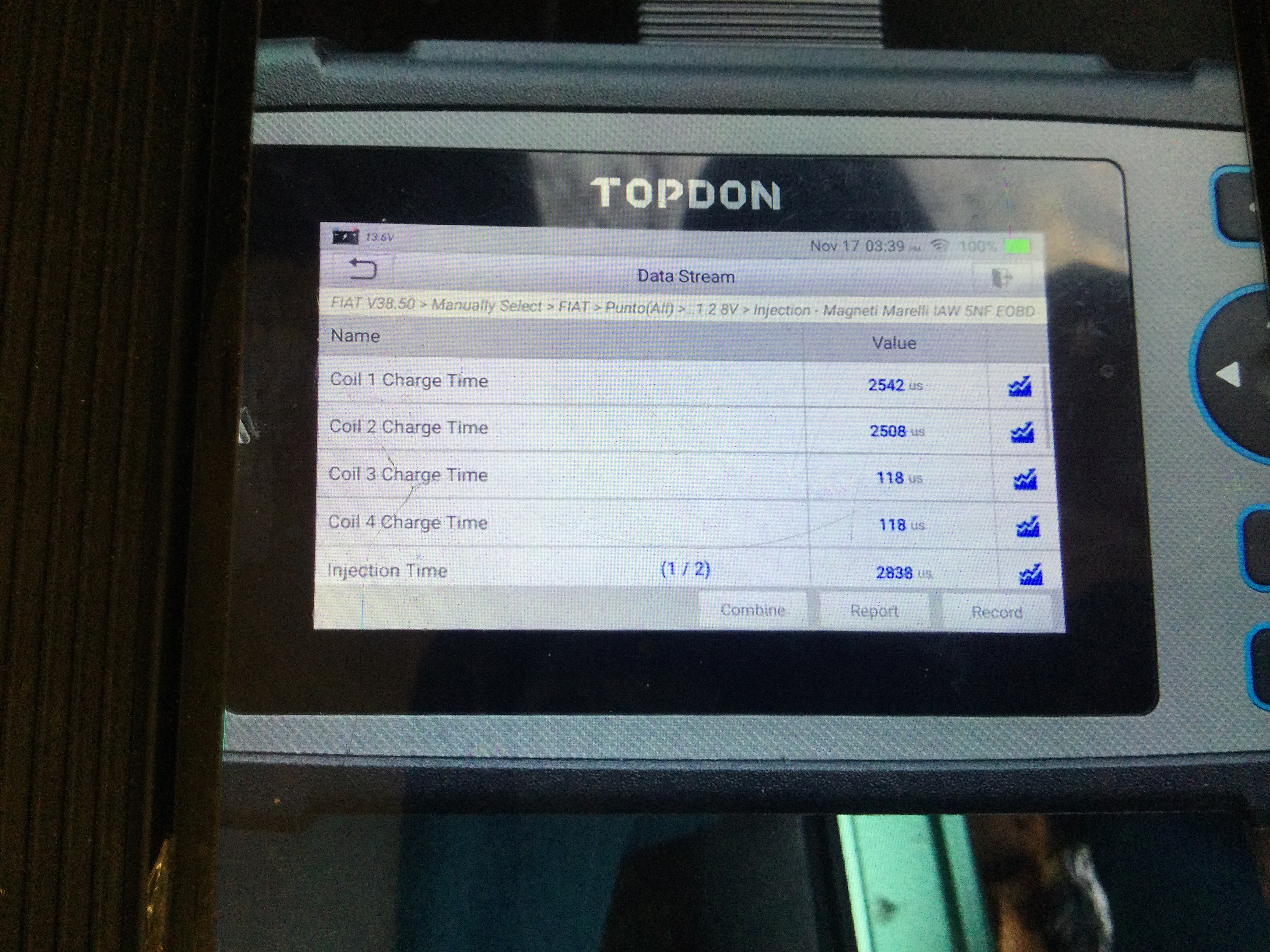

UPDATE: warmed up engine for 20 minutes,connected topdon and code u1601 was present + coil reading were different pic to follow, low figures were the new coil so put old coil back on and had the same. Cleared code u1601 never came back engine runs well with very very slight misfire but that’s been like that for years and only on idle once revs up it clears . THEN went for spin round block and she was running rough to the point it nearly cut out and when I got back it was misfiring badly, reconnected topdon reader and U1601 came back . ANYONE SHED ANY LIGHT

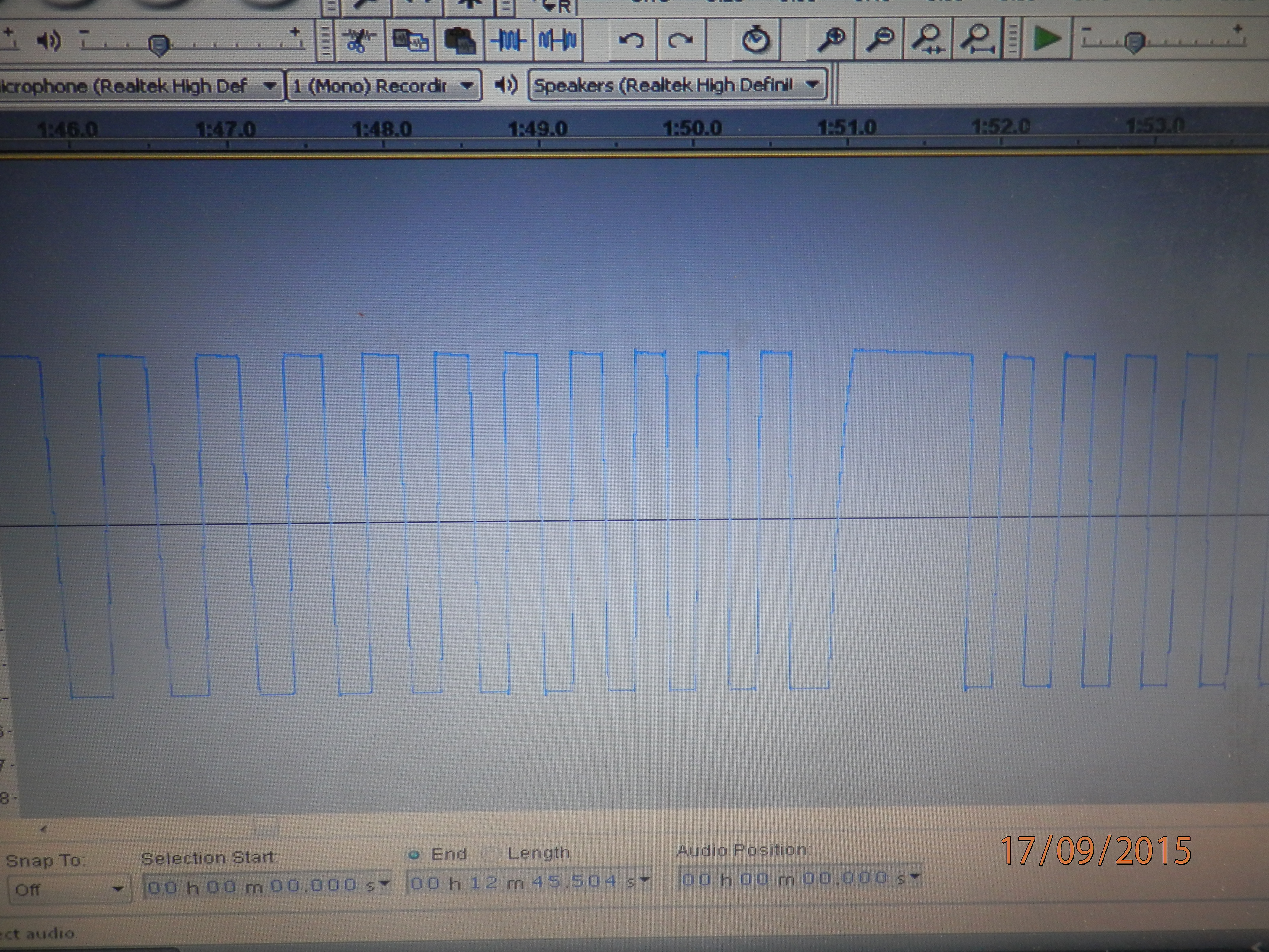

The Punto is detecting a misfire by observing the slowing velocity of the segmented crankshaft timing wheel used by the crankshaft sensor. If the car misfires, which is an obvious condition that should be easily detected and yet when there is no misfire code, it suggests strongly the crankshaft sensor is failing and is causing the misfires.
You can use the microphone input of a laptop with some easily downloaded software to display the output of the crankshaft sensor. Or you can get it to pulse a LED. You just have to be methodical.

isnt that 118 micro second charging time showing a short on the coil for 3/4?
Am guessing it's the same layout as the 2006 panda with the same
engine
First coil does cylinder 1 and 4
Second coil does cylinder 2 and 3
Post 1 P0303 misfire cyl3 and swapped leads
Post 6 P0301 misfire moves to cyl1
When they swapped coils the misfire followed the coil as reported by the ECU
It's got to be a hint
there isn't any coil that does cylinder 3 and 4
There isn't a coil 3 or 4
