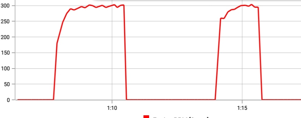

Here's mine cranking, start disabled
Here's mine with less than 6.5V, no rev counter
