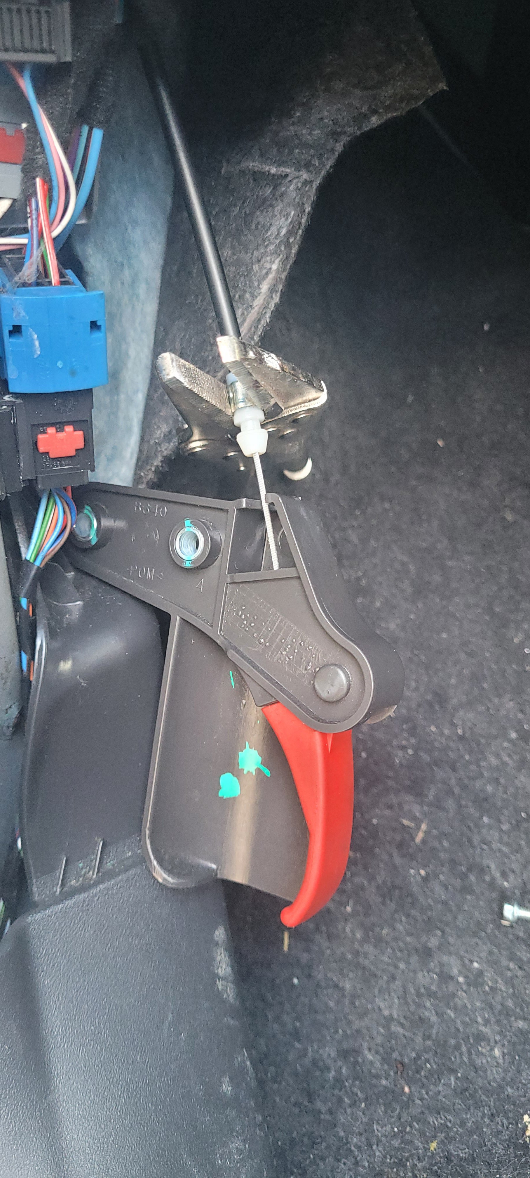

Went to open the bonnet and it felt like the cable had broken.
Took off the handle and cable is not snapped but it still will not open.
I'm assuming ir something with the catch in the engine bay.
Any ideas on how to open the bonnet from outside without destroying the car?

I had tried this but unfortunately no luck.
My issue is a bit different, the cable does not pull, it is loose as if completely pulled out already.
I had my son push, bang and pull as best he could on the bonnet while I attempted to pull a bit, but no good.

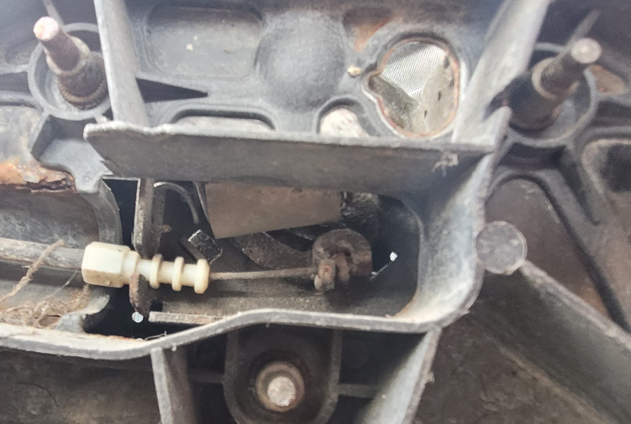

Eventually!!! the rain stopped long enough for me to have a look at the opening mechanism on the spare car - see photo. Actually looks handy. This is a little below the actual catch which is why I didn't see it first time.
Put the problematic car up on ramps to get under and get at the mechanism, found it handy enough and feeling around to "see" where to lever and I was able to open it with my fingers. I'm going to take that as a rare win. 😁
