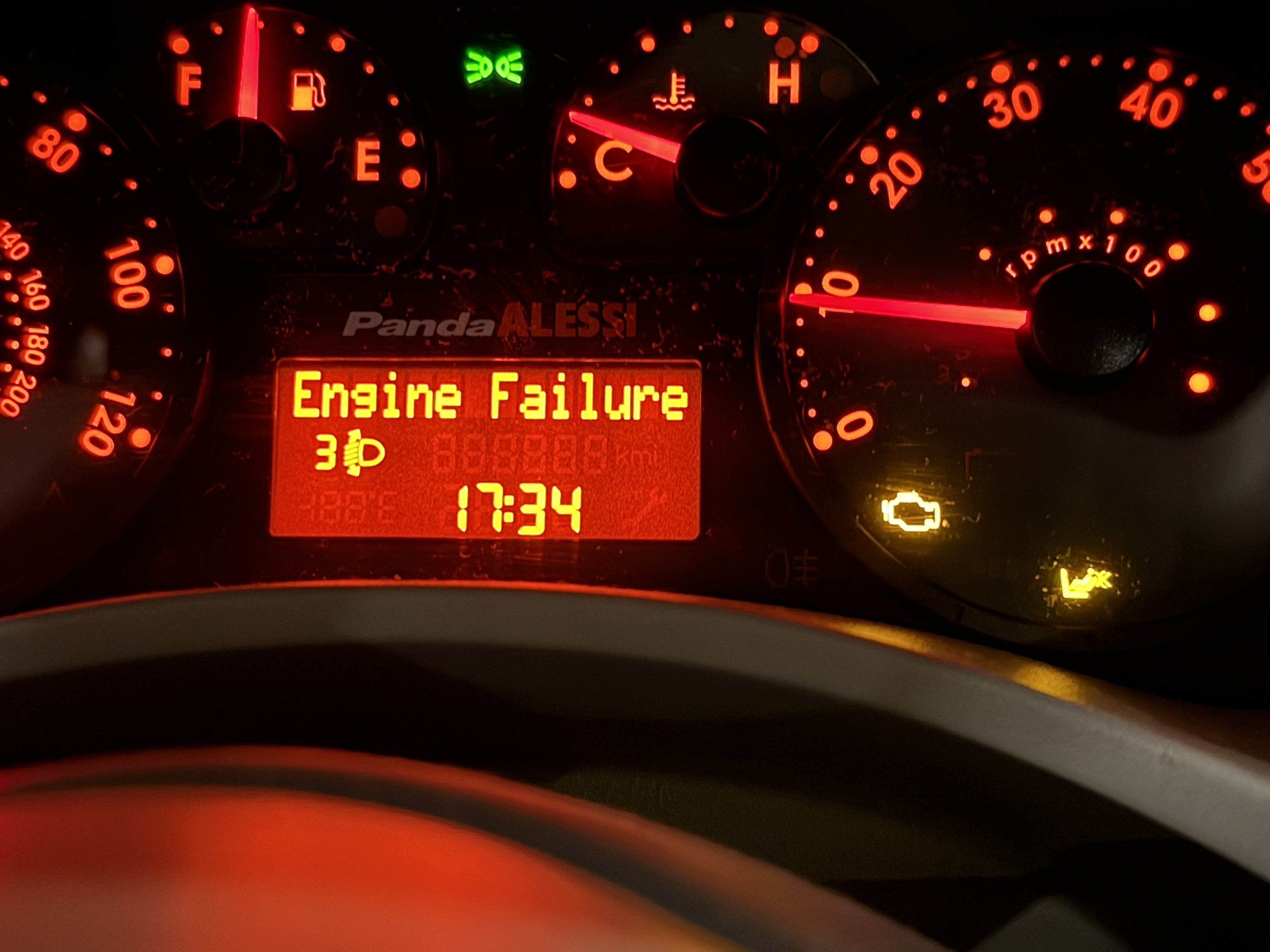

At least that's what the dash says.
Car drives fine. Rad kicks in and has oil etc.
I was doing 60 when it popped up and I carried on.
This is the first time in a while that I've done a constant fast speed and I do have a hole in the backbox. But it's obviously past all the sensors.
I take it the engine check light
Rad kicks in, you mean the fans did they come on full at the same time as the engine check light came on
Is your car strugling to get to the the half way temperature by any chance
I am guessing the light came on while coasting
I suspect the rubber seal in the thermostat has perished
It's pretty easy to check with a cold engine
If you haven't got a code read it will clear after 5 good starts or is it 10
