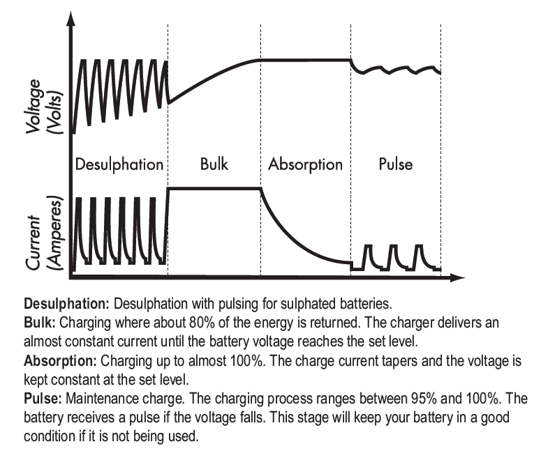

It depends on what the manufacturer means by intelligent
some do have a Pulse charge feature in the charge cycle some dont...
Without getting too technical the charger pulses the volts and ampage at a set rate to desulphate the lead plates
see here
then followed by a ramping charge rate
the exide website recomends a charge rate of 4a
