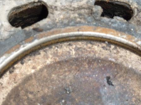

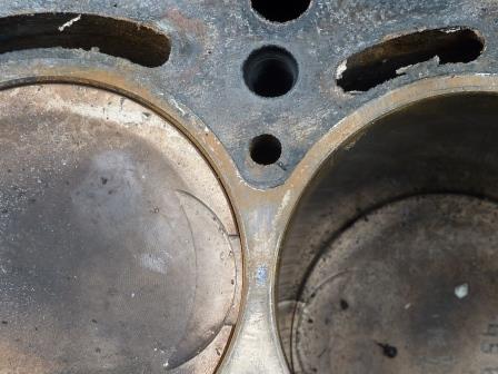

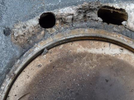

a you say both on 1 & 4 the gasket shows signs of damage, but is that enough ? I don't know, I was looking for something more than that, thought hat was only water jacket sealing, nothing appears between cylinders going out
? If the cylinders blow in and out of the water jacket then compression is going to be bad. You are not forced to get gases passing directly between cylinders if the head fails
just looking again at the gasket, you're right it is rusty, also with gasket off the block all show signs of rusty marks, I was looking at the cylinder metal seals and think they are ok, but now looks like head gasket was gone, but anyone else's view please,
YES, looks like a fair bit of rust/ water tracking,

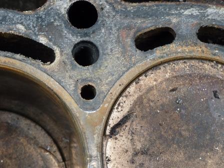

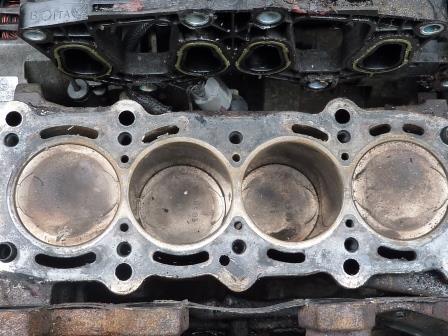

right took the head off,
photos attached, can't see any damage that would cause the compression problems, the is damage to cyl 1, but it looks old, not taken head gasket off to look underneath, but cyls look clean, and no movement side to side,
Do a leak down test on the valves.
make sure all 4 plugs are in..and cover the valves with petrol.
and watch and see if the petrol disappears.. if it does valves will need repair..
if not clean the head up ..a gentle skim with a Stanley blade to take off goo and oil,,
and just put a gasket on.
couple of problems lead me to think head needs working on, some large bits of broken rubber stem seals, can't see any oil inside inlet/outlet ports, but it got on the plugs somehow, (2nd compression test) . there are defined ridges on the cylinder head around the pistons & piston sealing ring on the gasket

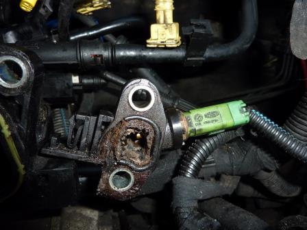

the water inlet at the end of the inlet manifold has melted as well
That is the water outlet to return water to the pump via the pipe that has the o-ring leak. Difficult for me to see what is going on there but the o-ring? seems to have melted and the housing has split open?
From my point of view it seems the engine has got so hot you would need to check all the seals including water pump and really have no idea if they were good or bad unless replaced. All that anti leak crud inside the water channels is probably going to create problems for the heater and radiator down the track too.
And of course a new head is not going to solve these problems.
Game over i am thinking.
yes think you are right, costs are mounting up on what parts need replacing, or may need replacing
