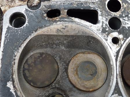

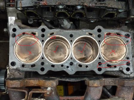

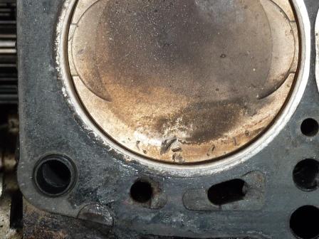

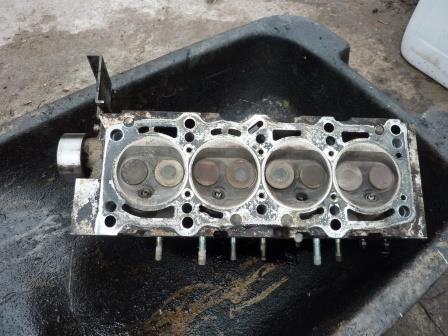

right took the head off,
photos attached, can't see any damage that would cause the compression problems, the is damage to cyl 1, but it looks old, not taken head gasket off to look underneath, but cyls look clean, and no movement side to side,
Have you not got leakage between the cylinders of number 1 and 4 into the cooling channels? Where the orange colour is on the circular gasket sealing ring? Top part of the block picture?
Thats what the compressed air might have found?
Then again what am i thinking of! All of your cylinders were showing 'bad' compression!!
hmmmmmm
I suppose if you are looking at an instantaneous failure due to lack of coolant, creating a warped head you will not see much evidence of it having happened?

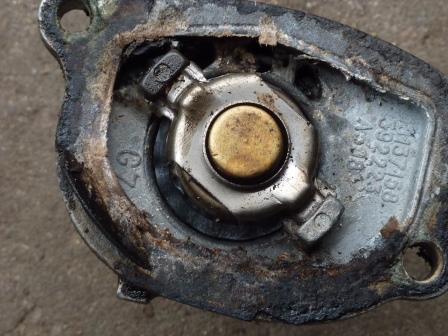

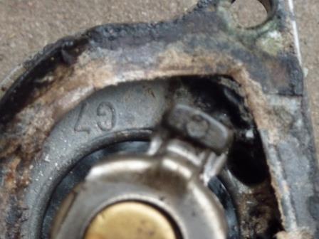

can't see any damage on underneath of head gasket, photos of thermostat show muck in the holes of the case, (re they bypass holes ?) in the rocker box side I found what looks like broken rubber off valve stem seal, really don't see why I got those compression readings as nothing looks that bad,
