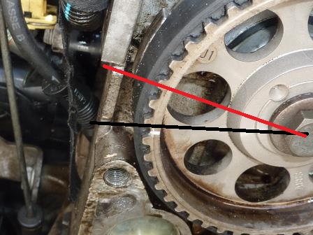

Timing looks right see photo's

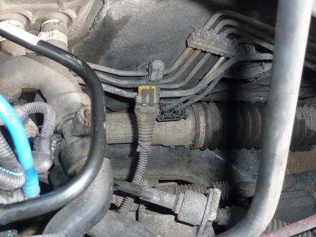

notice this "yellow" cable hanging down back of engine looks dirty so think its not been connected to anything, I've lifted up to photo it
felt around but can't find any plugs for it to go into, car's not in a position for me to get under and have a look where it may fit (wonder if its for auto box or different engine/gearbox using same wiring harness)

I have an unused plug in the same place and from memory it is a similar shape.

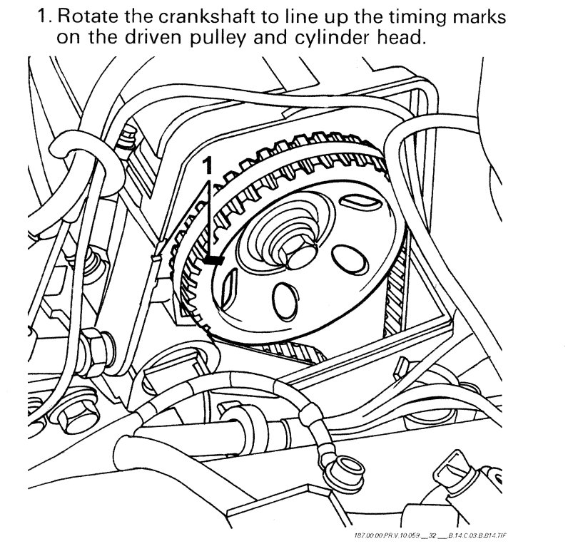

What is your information source for the timing? Your timing method is totally different to mine but from reading the forum you need that top marker plus TDC firing on number one or by using the harder to see notches looking thru the bell housing at the top - so between engine and gearbox there is an opening to see timing marks for the crankshaft.
According to this forum there are possibilities for a broken lug on the cam pulley which can mean the top timing mark has no meaning for your current timing and a new pulley is required. Dave said this and he is an expert on these cars. On my car the bolt alone holds the cam pulley against the camshaft and Dave assured me it never creates problems. Potentially a previous owner assumed that lug was not necessary for your car too if it was sufficiently tightened but Dave seems to know otherwise. @dave to come here to clarify please.

read Haynes, and my one has the marks on crank and camshaft, remember using those marks when I changed the belt about 18 months ago,

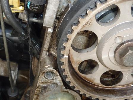

hang on - is it me or is that timing out on the cam?
I dont know if the image makes it look wrong or not
And tbh - its been a while since i've timed one up, but iirc it goes to the triangle cut out like such
vs what this should be like
If i am correct - this would confirm my suspicion the compression results are pure **** because the valves are open/ing on compression strokes
