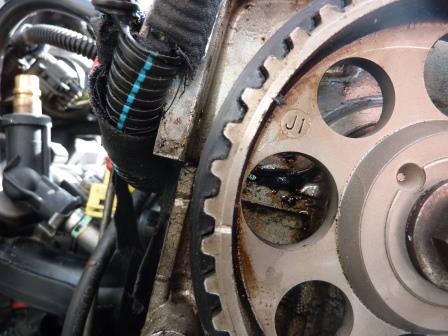

Think it may just be the photo was taken, as I could not get camera in there on the level,
just put car all back together now as well, But as you say its only my time to recheck it again, so that's easy enough, belt felt ok when I twisted it, I will take it apart again tomorrow or on Friday,
If the belt has jumped why would it jump ? been ok for 18 months or so, trouble is, as I don't drive the car & daughter doesn't live here I only see/hear the car as they pull up in the drive so don't know if anything has been wrong/going wrong with the car
maybe because my mind was thinking "timings ok, its got to be the head gasket" maybe I didn't look at cam marks right, well a re-check will sort it either way
Others have suggested a straight edge because it is so difficult to line it up with the engine in place. One way is to rotate the timing mark so it points straight up and then put a line across the width of the belt where the pulley notch is and then rotate back to check?
Can the pressures really be so low and so equally low??

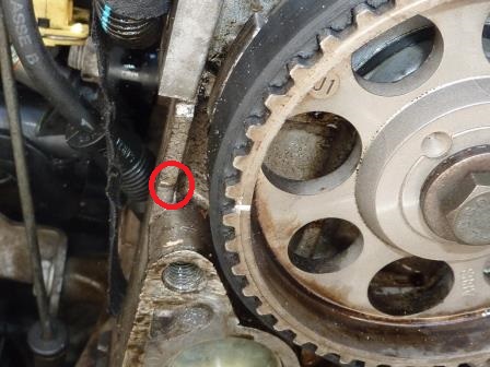

been looking at photo again, I've uploaded the photo with red circle around the timing mark, now it does not look that much out and that could be just camera angle
the timing marks are the ones I've used before, changed the twice before last time around 18 months ago, I did the compression tests twice, first time I got on cyl's 1 & 2 only 30 lbs, second time I got 60, 50 lbs, Like I say maybe its me, but I think I've done it right.
in the photo that ziggy has added the lines too, the timing mark on the engine case is just above the black line, with the mark on the cam wheel below the black line, but that could be just angle of camera, photo not square so ziggy's line will not be square

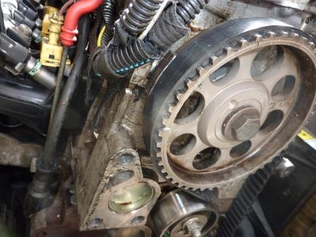

just re-checked the timing, photos attached
using a mirror (hard to get head in there) the cam lines up with the nic
in photo cam 2 taken from a slight angle marks are 1/2 teeth out, in photo cam 2-3 taken from other side looks miles out,
but with mirror in font of cam wheel looks ok
